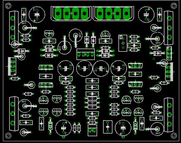

I couldn't see how the protection circuit on the VAS would ever do anything, because the VAS has limited voltage drive to begin with, which is an implicit current limit. He thought it was still a good idea. I still respectfully disagree. He is not likely to change much in this design, it's a matter of pride in getting it right the first time. My point was a trivial one, the amp works just fine as it is designed even if the protector never triggers. But he is really good about replying, he did not have to. I never was his student, just an audio nut like so many he must hear from.
I did a little layout of the original Leach Amp too, using plastic transistors. Getting rid of the wires to the output stage is a very good thing. I mounted the drivers, and the Vbe multiplier on the main heat sink. The board is 3 inches by 4, half the original size.
I made some minor changes that simplify it a bit. So technically it's not a Leach Amp exactly. I changed the Vbe multiplier to a single transistor (MJE340 on the heat sink), deleting the diode string. I use only one Zener for the 40V (but put the holes in for two if you must). I added an optional input DC blocking capacitor, and optional resistor between signal ground and the input ground. I changed the the TO-5 xtors to TO126, and the outputs to TO264 plastics. Much easier to wire up and to heatsink on a simple flat plate.
Look at the attached silkscreen. You have to imagine all the vertically mounted transistors on the border are really laid down on the underside of the board, fixed to the flat heatsink. I could not show them that way in my freeware version of Eagle (they don't let you use a bigger area), but of course that is the way they should be. So there should 7 little imaginary wings on the board, the transistors on the main heatsink: the 4 outputs, the 2 drivers and the Vbe Multiplier. Incidentally, for power connectors I used the type on hard drives, cuz I have a lot of old cables for them from obsolete PC power supplies. Recycling.
Sorry for the limitations of the program, or my pocketbook really. I guess I should get the Pro version one of these days. I'm still not sure which package is the best. Some like EasyPC instead. I've used Orcad too, all have their good points and faults.

Hi Slowhands,
I think you are mistaken
Imagine the situation when the output is connected to almost zero resistance to ground and the output protection is triggered.
The base of each driver transistor is alternately connected to output rail and in turn to ground via the accidental short.
The VAS now has Vrail to ground across it and is trying to flow current to pull the driver base back up to normal voltage level. The triggered protection transistor is saturated and has at most a few hundred mV across it and wins this tug of war.
Bang and lots of magic smoke from the VAS.
Even the scenario of a very low load say 3ohms for a 4ohm speaker with the output protection active. Now the VAS is connected via the 3ohm load to ground during each alternate cycle. Again the VAS will fail.
The VAS protection is a constant current source that only becomes active when the VAS tries to push excessive current into the output stage. When in constant current (protected) mode the dissipation will be Vrail times ccs value and the VAS should be selected and heatsinked for this duty.
I would suggest a ccs limit of about 3 times the normal VAS quiescent current. Prof Leach's choice for the sensing resistor is a bit low @ 33r (about 20mA), I am using 56r (about 11mA) for R24 & R25 in the Leach clone (4.5)
