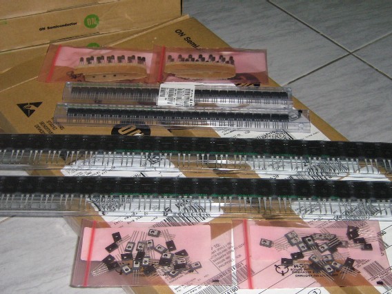

alternative for output transistors
Sorry to dig this up again. I order some MJL4302A but never get them. I happen to have some MJL21193, MJL21194 at hand. (I don't expect them to work as powerful as the original) Can they be use instead? Any modification of circuit need for using them? Or had it been mentioned in the thread and I was just blind enough to have missed it?
Tks for your help.
Tks for your help.
are 4302A the lead (Pb) type?
You might only be able to get the lead free (no Pb) 4302G?
Were you talking samples from ONsemi? They tend to restrict samples to the newer parts.
Maybe they expect us to research the new product lines before we order up thousands of components for the latest specification production run.
MJL21193/4 is a pretty robust output pair. It should do the job very well. It is slightly down on power but this is of little consequence.
21193/4 does a lot better than 4302 when looking at 50V and 70V current ratings. Cascoded 21193/4 running on +-100Vrails will only see 50V each when driving maximum current into a highly reactive load. Here the 21193/4 will beat the pants off a 4302 with nearly double the current capacity.
