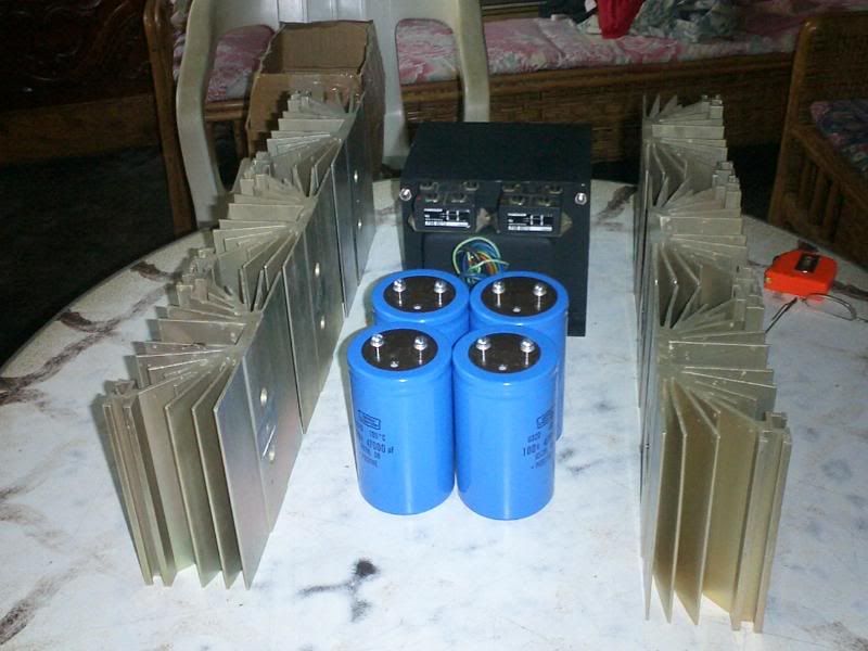

Delta T is critical here in Brazil, because average ambient temperature can be sometimes very high (in summer it can get as hot as 42ºC). Despite that, when it's hot we use air conditioner, so this is not a big issue - temparature is somewhat controlled and won't be higher than 25ºC in my listening room.
Here's the info provided by the manufacturer of the HS15560 heatsink. I put the 2 options that were considered:

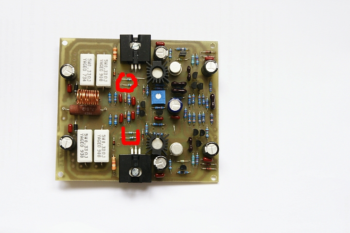

Sorry for offtopic:
I completed Leach amp 4.5 assembly for active subwoofer.
I have some doubts about small resistors are shown in attached picture.
These 10ohm metal film Vishy resistors according to the specification is 1/2w, but they are smaller than the standard 1/4w resistors. Are these little appropriate or should i replace them with bigger? Maybe someone has experience with them? Thank you.

what is the dissipation for the 10r resistors?I have some doubts about small resistors are shown in attached picture.
