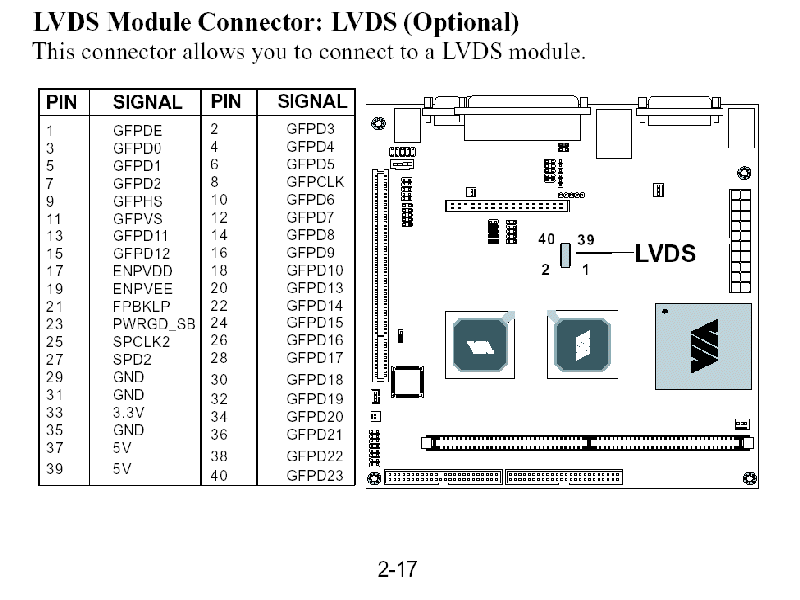

You may be interested to know that the new Via EpiaM mobos have a LVDS connector built in. It's a new consumer board designed for HTPCs. Inspired partly by this mod on a Shuttle XPC, I'd like to find a way to connect the LVDS to a 8" touch screen LCD, which I'll build into the front of an acrylic PC.
That's how I've found my way over to your board...! And I see I'm not alone in this!
The EpiaM manual has the pin-out diagram and I'm trying to find out from Via what LCDs this supports.

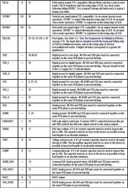

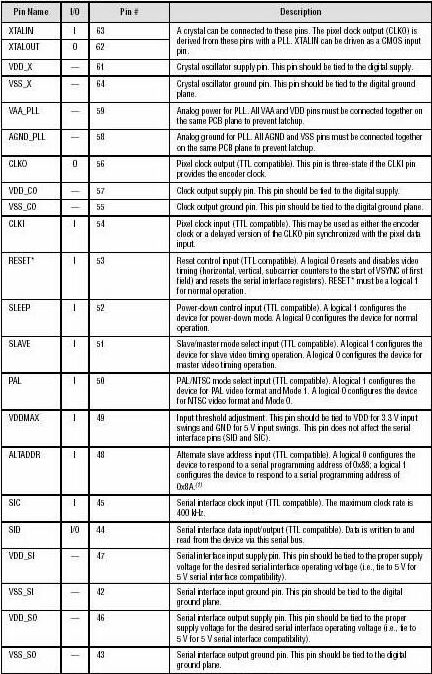

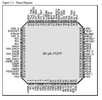

most lcds require 15/16 or 24 bits of digital RGB, sampling clock, data enable signal, and maybe horizontal and vertical syncronisaton (depending on model of lcd)!
if you read that conexant pdf file, you will see that tv encoder chip takes those signals from GPU on video card!
http://www.conexant.com/servlets/DownloadServlet/100123b.pdf?FileId=325
so, you could take all the signals lcd requires from that chip, only by soldering some wires between the chip and connector that you can put on the edge of video card, next to vga out and tv out (hard part) :)
all that is left is to make some settings for tv out, i mean to set that you have non-interlaced tv with resolution of (for example)800x600!
that way, you can have normal vga out for crt monitor, lcd ot and tv out!
NO CONTROLLERS, NO WASTED MONEY, BETTER RESULTS !!!
so, if you check those pdf files from:
www.lcdspecifications.com
and see the pinouts for actual lcd panels, you will see that you can hook up 15/16/18/24 wires from lcd panel (for digital RGB) directly to that conexant chip!
all that is left is to figure out which pins on conexant will give sampling clock, data enable, horizontal and vertical syncronisaton signals, and to wire rest of wires to them!
no controllers, just some wires and soldering skills!
