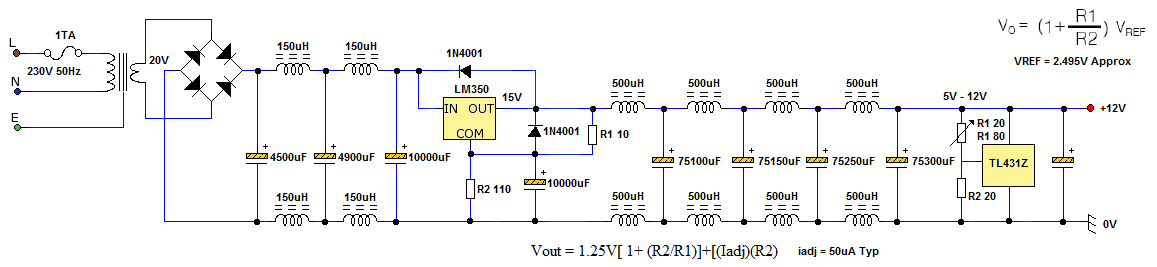

I have finished 99% of the schematic. There is a capacitor on the output that I can really only determine once I can see how much space is left on the board, and what the scope testing will show me.
There have been a few changes from the previous version.
1) I have regulated the LM350 at 15V Approx and used a shunt regulator at the output to tune the voltage instead. This will protect the LM350 from any feedback issues resulting from a higher voltage on the output from all those inductors and capacitors in the filter stages.
2) I have spread the capacitance values out and deliberately made the values uneven to protect the circuit from any possible resonances. The lowest values of capacitance come first in the current path. These individual capacitors will be split up into different values of electrolytics also, to let the ripple reduce progressively.
My only question I have left concerns the toroid and the rectifier.
Does anyone know if it's better to use individual diodes and a custom made toroid transformer, or an all in one premade rectifier and transformer, and can anyone recommend a supplier?

500uH won't help smoothing - to 100/120Hz it looks like a short circuit.
75100uF won't stop RF, as it will have too much inductance.
So your filter will be poor across the spectrum - the opposite of what you expected? I suggest some more reading, and building/debugging something simple.
