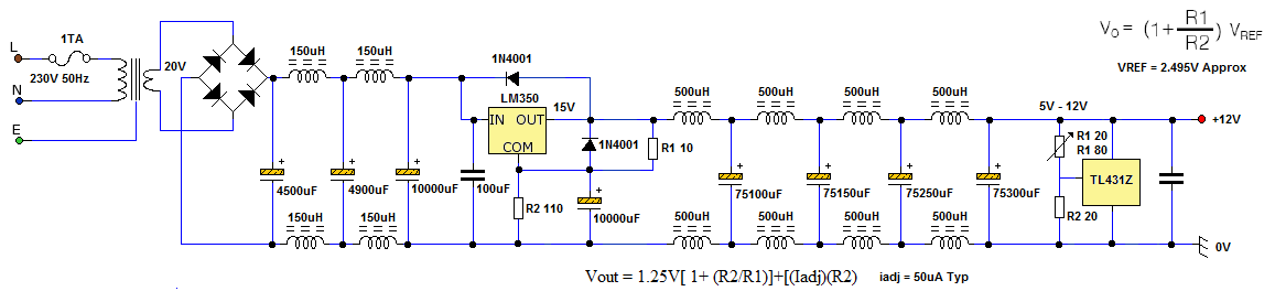

LC Low Pass Filter Design.
I said 'in the range of Henries'. You have tried to portray this as an obsession with the number 6000, why, I cannot imagine, unless it be that you seek to prolong the argument while avoiding addressing the crux? When I say 'you need shunt capacitors larger than the nanofarad range to make a significant impact on 100 Hz ripple' in this context, do you dispute that?
Now stop jerking my chain.
Nope, no reason to dispute that but I can't for the life of me see why nF range capacitors would be at all relevant here when the smallest filter cap I've specified is between 4 and 6 orders of magnitude larger (mF range vs nF) than that, and those are to be paralleled.
Methinks you're yanking my chain here.
I have done some more reading, and I have just decided to go ahead and build from this schematic.
If it doesn't do what I want it to do, I will adjust and alter it until it does do what I want it to do. The oscilloscope won't lie, and I will learn as I go.
Thanks to everyone on here that contributed something useful.

Any advantage of have a choke at both positive rail and ground return ?
There are CMC choke designed for that purpose but I normally see them placed in the AC section and mostly before the transformer. What is the difference when using 2 separate chokes between caps after regulation (CLC filter) on both positive rail and ground vs just one choke on the positive rail for the CLC ?
CMCs are current-cancelling, allowing a much higher value inductor (in common-mode) with a smaller core without saturation. Using separate inductors doesn't permit taking advantage of current-cancelling. Also they'll present the same inductance in normal (differential) mode as in common mode. A few hundred uH isn't going to make much of a dent in any CM noise - if you go checking the commercially available CMCs they tend to have inductances at least an order of magnitude higher, perhaps two to three orders higher.
CMCs are best used prior to the transformer as there the working currents are lower (assuming the trafo is the usual step down one).
