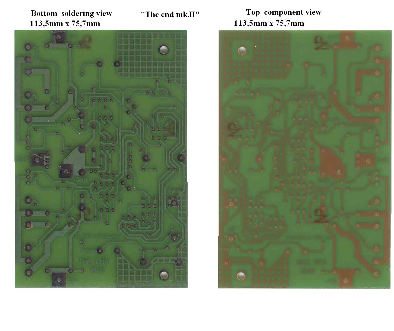

Use of Type Tip transistor as driver and output ,even with single supply works good,use schooty,If you use faster not nesseray you should use 47 pf from base to collector on
driver stage,ot critical,other transistor not matvhed but input,you trim output offset with
100 k trim resistor under 50 mv easy.
diod in bridge and 10000 uf and up are ,only necessery
The End mk.II test
Most important listening test by 10 different audio people based on
the DC-amplifier: ”The End mk.II”
1990:
1) TIP35/TIP36 Ft: 3mHz +- 45VDC 1 x 500W single supply 20.000uF/63V 1 bridge: Overall reasonable good sound, little harsh tweeter, midrange a little compressed, heavy bottom which could have more difinition.
1993:
2) MJ802/MJ4502 Ft: 2mHz +- 43VDC 2 x 500W double supply, 2 x 45.000uF/63V( Maron 15.000uF x 3) + 10uF polyprop. Each, 4 bridges , safe protection 4 double 10A goldcontact relays : Very good sound, no harsh high frequence sound, very strong significant, tight low frequence reproduction. Running at 90% power music for 10 hours completely stable. Superlarge heatsinks.
1993:
3) MJ15003/MJ15004 Ft: 2mHz +- 55VDC 1 x 625W single supply 15.000/80V Nippon Chemicon, 2 x bridges, 4,7uF polyprop, safe protection 2 double 10A goldcontact relays: Excellent bass driver, great soundstage, wish for more high frequnce details and definition.
1995:
4) MJL3281A/MJL1302A MOT. Ft: 30mHz +- 56VDC 2 x 500W E-transformers ,double supply 2 x 47.000uF/80V Hitachi ( 1 x 47.000uF like large beercan), 10uF Wima 250V MKP10, 4 x 35A bridges, safe protection 4 x 10A Omron goldcontact relays: Excellent tweeter responce with fine definition, great soundstage with a lot of midrange details, superfast authoritative very deep bass responce. The best setup at this point.
1997:
5) 2SC3281/2SA1302 Toshiba Ft: 30mHz +- 52VDC 1 x 1000W single supply 47.000uF/80V Hitachi, 10uF MKC 400V polycarbonate, 2 x 35A bridges, safe protection 2 x 10A goldcontacts trible point 48VDC Matushita relays:
Very musical amplifier, excellent high range reproduction without highhat spikes, well defined midrange, and absolutely no loss at low frequences, may be not quite so fast in the bass region as the 1995 MJL Motorola amplifier.
2002:
6)2SC5200/2SA1943 Toshiba Ft: 30mHz +- 51VDC 2 x 500W double supply , 2 x 50.000uF/63V Nippon low ESR ( 10.000uF x 5) 10uF polyprop Wima MKP10, 4 x 35A bridges+ 4 x 10n, safe protection 4 x 10A double goldcontact double points Erni relays, large heatsinks 32cm wide x 16cm high x 5cm deep :
May be the most detailed high frequence definition so far, excellent midrange with very accurate determination of the location of instruments, deep very powerful significant bass reproduction.
Until now may be the most musical and best sounding amplifier based on ”The End mk.II” circuit.
2015:
7) 2SC3284/2SA1303 LAPT Silicon Epitaxial Planar Transistor , Sanken Ft: 50mHz , amplifier not ready yet!
Other transistors tested with ”The End mk.II” circuit:
2N3773/2N6609 , 2SD555/2SB600, MJ15025/MJ15024, MJ21196/MJ21195, a.m.others

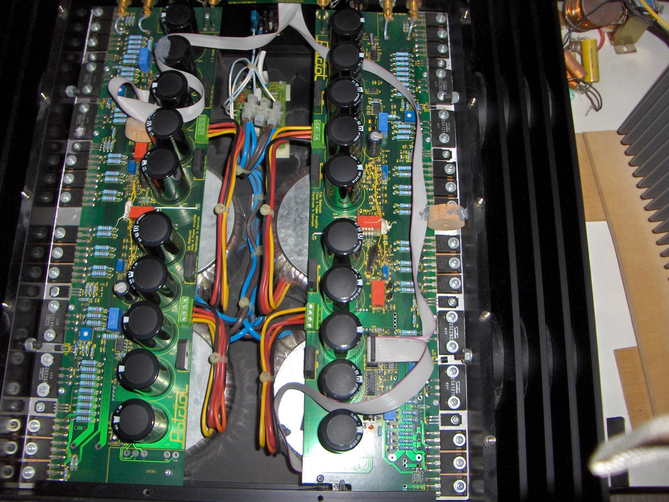

A photo of a later LC Audio amplifier: my LC Patriot V 100.
Patriot?
Don't know "LC Patriot" ...nice photo....how many output's? ...looks like 4?
Could you post the "Patriot" schematic?
Gudmund
Gudmund

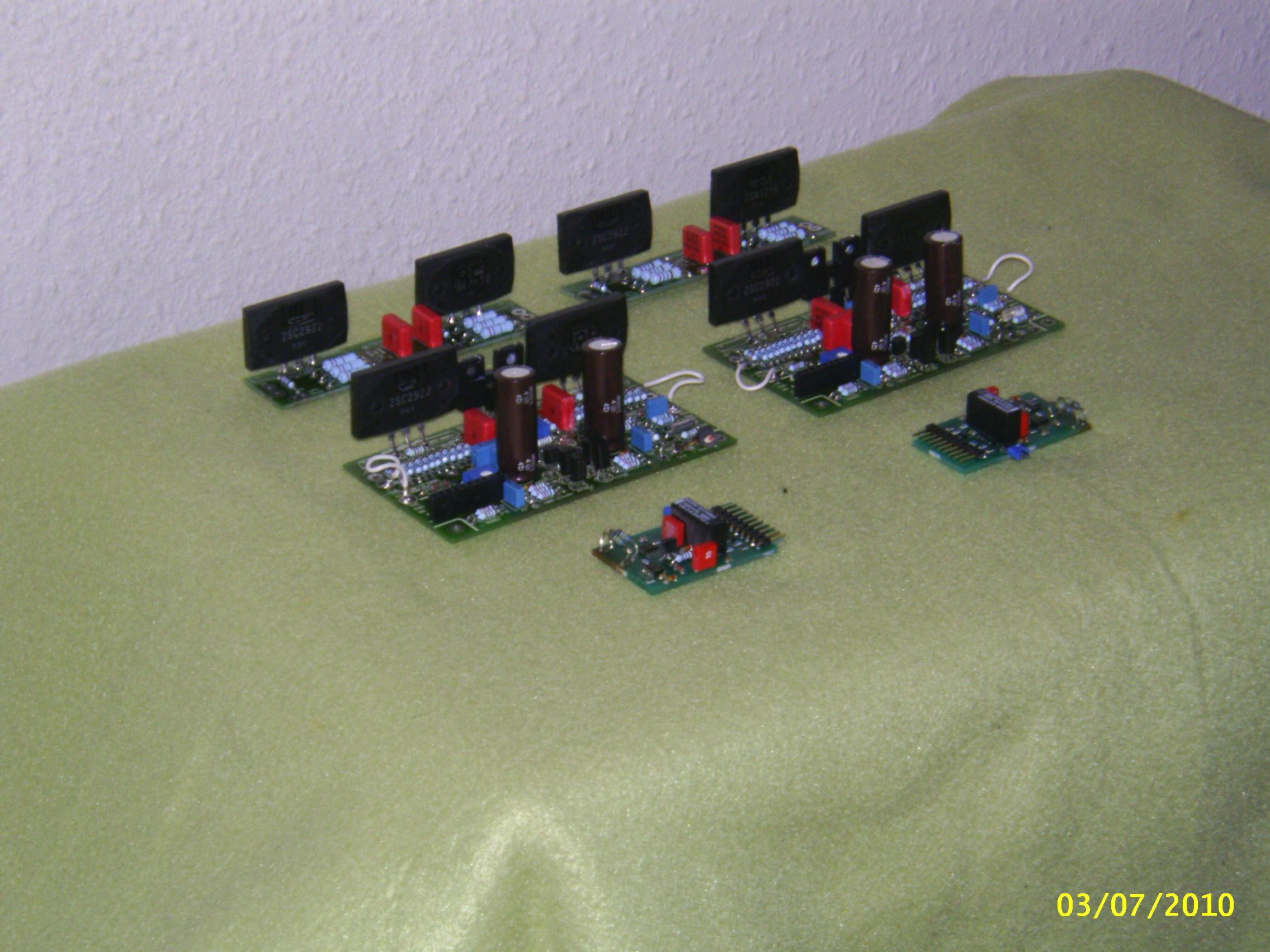

Yes...the LAPT output transistors is used in "The End mk.3.1", 2SC2922/2SA1216......
.....we have tried the mk.3.1 version at different voltages , with and without servo.....it seems that the sound from the mk.3.1 is getting closer to a standard high quality factory made superamp.....
.....after many experiments the general assessment or evaluation among the 10 audiophiles was, that the simplicity by the mk.II circuit distinguishes itself by not adding the music signal unwanted sound supplements at the different frequencies.
The mk.3.1 attached
We would like to try the LAPT Sanken together with the "mk.II" version....
.... link "mk.3.1" in #58
The mk.3.1 attached

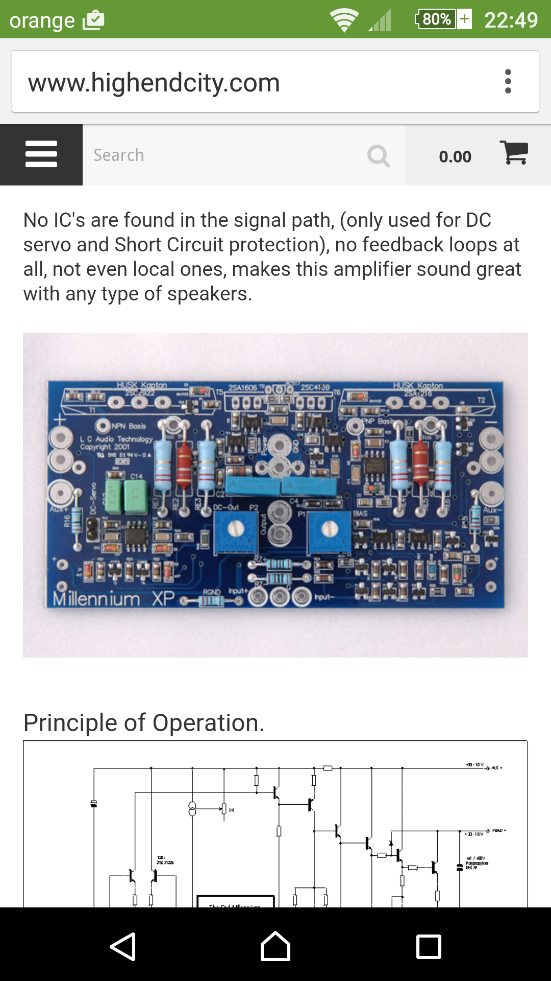

https://sites.google.com/site/httpstubeamp/home
Halfway on the page, you will find links to both Google.docs and Picasaweb where there is a description and a component guidance.
The "mk.3.1" circuit is shown without the servo. The "XP" is shown with servo.
"The End Millennium XP" with SMD components and on-board servo does not sound like "The End mk.3.1" and certainly not like "The End mk.II"
Rgds.

Sanken 2SC3284/2SA1303 LAPT
We try with the "smaller" Sanken LAPT 2SC3284/ 2SA1303 , TO3P, 150V, 50mHz.
... ordered 100 .
300 of 2SC2240/2SA970 Toshiba GR,
200 of BC560C/BC550C Motorola , Motorola very similar basic transistors
50 pcs of 10.000uf/63V Nippon Chemicon Low ESR
100 pcs of 3.900/80V Nippon Chemicon Low ESR... fast
Wima MKP10.....many.
A lot of hobby work ahead ............

Very difficult question because it depends on the build quality.
With emphasizing....if you follow the guidelines as mentioned before .....I would prefer the mk.II version.
The mk.3.1 version is much easier to build, if you don't have access to match all transistors.
If you choose the mk.II remember... do not use cyanacrylate or two component epoxy glue on the small-signal transistors as many has done ... ...use small cable ties in plastic. It is essential to keep the small signal transistors in stable heat-balance.
Another parameter is the PCB size and the size/orientation of the cobber lines....the attached PCB size delivers the best high frequence performance.
A scan of the mk.II PCB's attached..... find the drawing and component values here:
Picasa Web Albums - vbkolsen - The End MKII ...
I do not have gerber-files for the attached mk.II PCB nor the mk.3.1!
