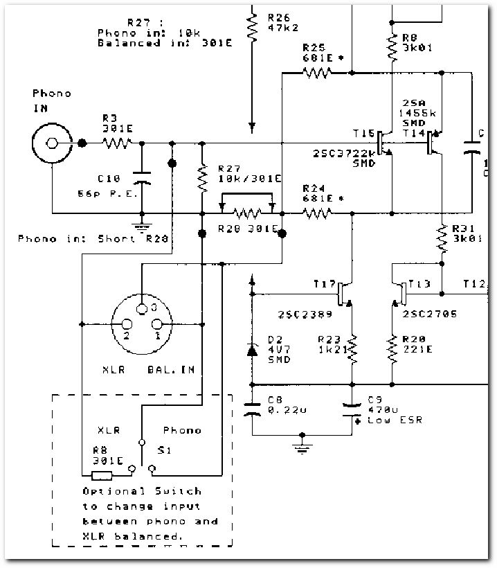

...old tread, but it seems subtable to use it for this question 🙂
I'm in the process of reconfiguration my The End Mk3.1 from single ended to support both RSA and XLR.
I'll replace the R28 strapping with a 301 ohm resistor and implement the external 301E resistor and switch as the diagram show.
But the value of R27 it is unclear to me when I use the optional resistor/switch. 😕
tia
