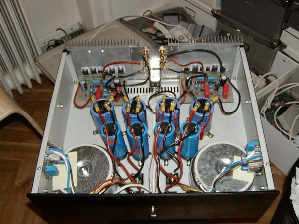

Pivture of "The End"
I promised to post a picture of my "The End" project. Here it is.
As said before, I sounded really warm and detailed before I did something silly and blew one side.....
Now I'm changing all transistors and will - hopefully - be able to listen to it again very soon.
Yes, it sound good - even with the "crappy" TIP35/36. I guess the designer must have done somthing right.....😉

Connection to star ground for the low level input?
Just briefly looking at the image i do not see any connection from the star ground to the RCA. Is it done on the PCB? If not then do it, that is why i buned my amp(s).
I found out that something was wrong when i discovered 80v AC over the capacitors on the powersupply when i touched the RCA ground. The AMP was powered by +35 -35

Nice amp!
Wish I had the money to have double psu when I build mine.
Where is the starground? Can't see it on the picture.
The End
I don't see any protection circuity for the output on the picture of completed amp - if any output transistor will go to the " silicon heaven ", it will be realy " The End ", but for in this time connected speakers
. Maybe you have enough money for buying new one, but you get frightened realy much. Remember that all what is doing by man's hand, can't be absolutely reliable.

The beginning of The End.....
At last I got it together.
After changing all burned transistors and doing a few other tricks I have plenty of good music comming from my "no-feedback" amp "The End".
Thanx to Lars (LCaudio) for his kind advice. Just what I needed 😀 .
Blowing a bunch of transistors learned my something about proper grounding and decoupling. I guess that it has been worth the trouble.
I established starground and let a wire go from input-ground via a 2,2ohm resistor to starground.
Then I decoupled the heathsink by a 100n MKT cap going to output ground. That nailed it. It just 100% stable now. Nice 🙂 .
Sound is warm and detailed. Actually listening to Mahlers Symphonie No.3 gave me a feeling of "Why don't I go to hear a REAL concert?"
Isn't that the essence of High-End? I mean after all - the real "highs" are the ones you get sitting infront of 40 guys doing what they are best at......😉
So far...I'm happy!
