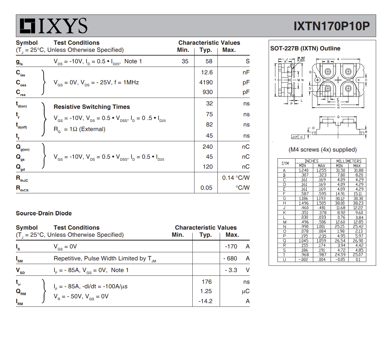

IXTN170P10P is in stock at Mouser but the capacitances are much higher than on 40P50P.
https://www.mouser.dk/datasheet/2/240/ixys_s_a0001273839_1-2272393.pdf
https://www.mouser.dk/datasheet/2/240/Littelfuse_Discrete_MOSFETs_P_Channel_IXTN170P10P_-1674753.pdf
500V vs 100V should not be a problem.
170P has much lower Rds on (14 mOhm).
Which C is the most critical (better to wait for the 40P50P?)?
capacitances aren't that much important - there is so small Miller capacitance effect, because part is working practically in source follower (common drain) mode
and, gate is driven with/from extremely low impedance ( practically from mid point of resistors in own source, through big cap) ......

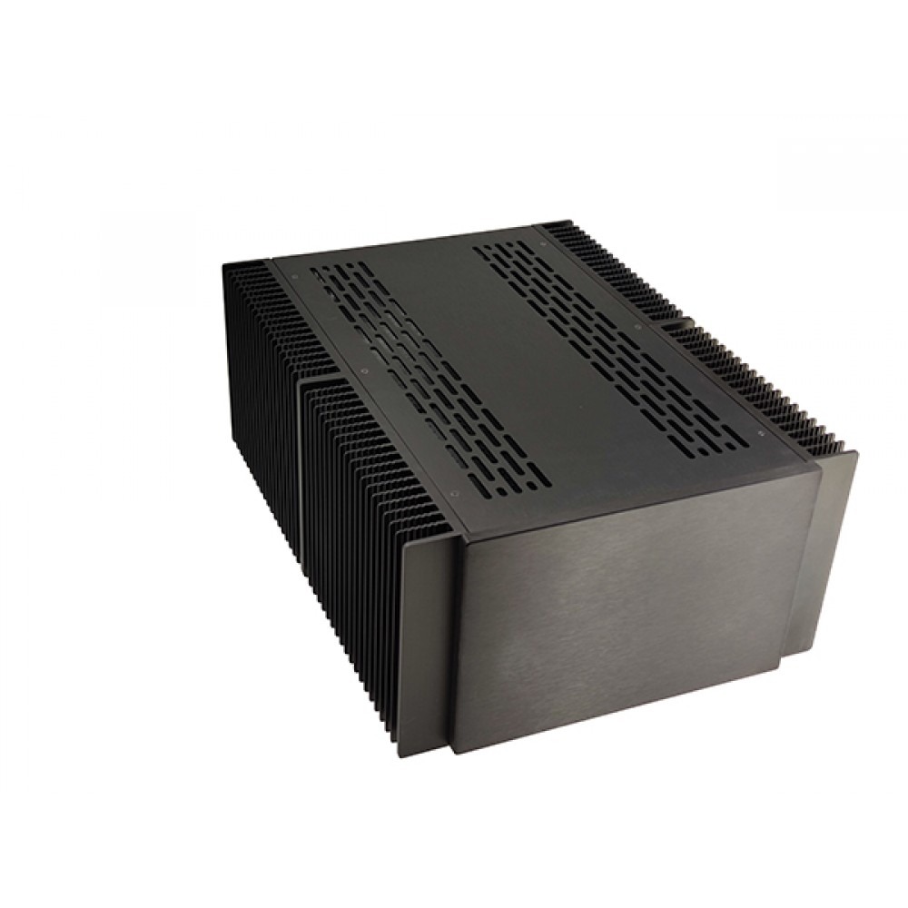

What would be a proper size of heat sink?
Will try to reply everyone who sent me PM these days, regardiing Lazy
sov, 180W of heat - have you idea how much is that?
comparison, Modushop 4U/400 is on the verge for 90W of heat per side, so 180W per case
say that newest Monoblock cases from Modushop are adequate for that sort of heat
if one buys option with heatsinks on both sides, it can be used with one OS part on one side , second OS part on other side, and narrower case (vs. regular ones) is good for shorter wires between two sinks and there is plenty of space in case itself for any scenario for PSU ( except if one insists on using Tube Mercury rectifiers)
problem - each side of 400deep case is made of two 200mm "deep" heatsinks, so using heatspreader plate on each side is a must
damn, and everything bellow 10mm thickness is not going to work good, for heatspreader
My intention is to use 2 x Modushop 4-heat sink version mono block chassis:
Then one device pr. side and then a good solution to ensure good heat transfer between the two heat sinks pr. side.
