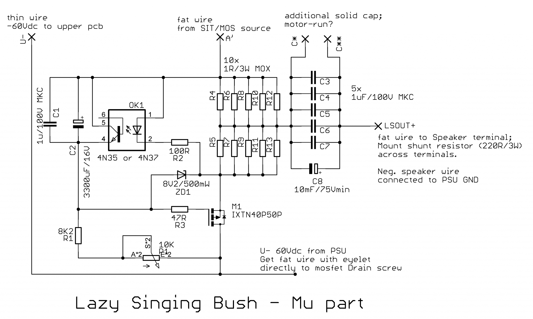

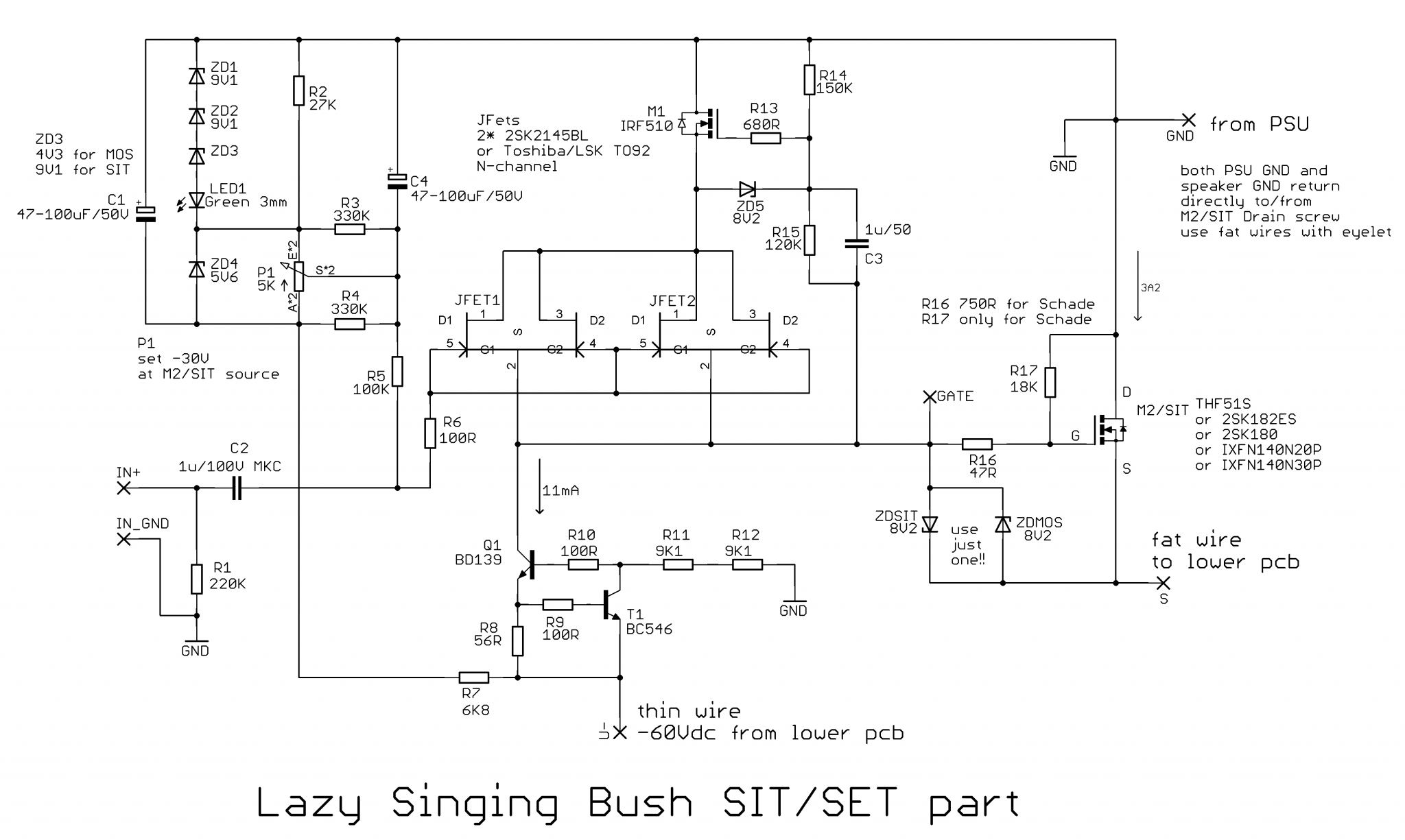

Now one 2SK182ES Lazy Singing Bush channel is up and playing chill out music on the mini test KEF speaker at the build bench! 🙂
No THD measurements yet. But here is the thing. With R1 at 8k2 the bias topped out at 2,4A. So i changed the R1 to 3k3, and that fixed the bias range. Now i have adjustment range P1 10k from 2,1A to 3,2A.
But how do i modify the range for the output node voltage? With rail voltage at -84,5V i now have C* node voltage adjustment range P1 5k from -27,1V to -32,5V.
Around -42V would, if i understand this correctly, with the -84,5V rail voltage, be a good starting point?
