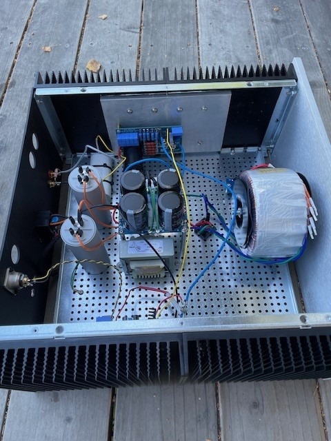

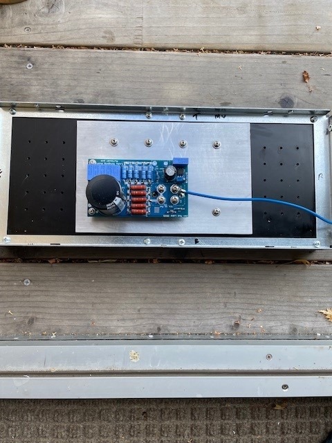

Spreader on SIT side mounted. I dressed the mounting side w 800 grit to knock down any small defects. Thin layer of thermal paste applied, torqued M4s to 1.2nM. Flying gate resistor inside the shrink tube is 47R. THF-51S mounted with correct Keratherm.
Proceeding to the Mu follower side.
Question - do I need insulated shoulder washers for the IXTN40P50P M4 screw mounts?

No.
You can check it yourself by measuring resistance between the metal base and each of the G S S D terminals.
no
metal tab is insulated from semi itself
you need nice washers though, in between screw heads and metal tab
do not forget split washers, too
Thanks Ben and ZM! Good copy on the hardware, I've got the split washers (M4 Bellevilles do not fit due to circumference limits) I will go ahead and add flat washers below.

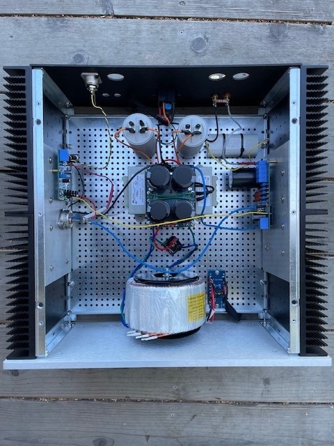

Well I hope I didn't damage anything. Let's circle back: Lower left of SIT/SET schematic in post #1 shows IN_GND connected to one leg of R1 and the other to GND. I have IN+ and IN_GND leads soldered to the input RCA, and a shorting device applied to the RCA jack. No other wires to ground.
Both trim pots were checked and set at mid-value before startup.
Both sinks made plenty of heat, no smoke / smells present.
If I read you correctly, you are saying read voltage at the C8 cap on the Mu PCB between C* and C**. What output node voltage shall I aim for, and how to adjust?

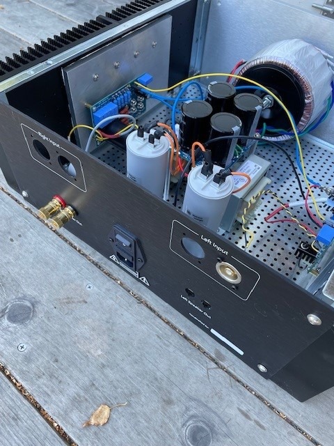

Mu pcb; put probes across R4 (practically having 0R2 there) and fiddle with P1 (10K) to get in vicinity of 640mV; means 3A2 Iq
then SIT pcb: put red probe on "C*" pad, black probe to GND (anywhere) and fiddle with P1 (5K) to set voltage approx to 1/2 of rail value; say that you have 60Vdc rail, so 30-ish Vdc is your goal
why I didn't name those 2 pots with different names?
Super helpful ZM. Cooking this morning, 10K P1 Mu trim maxxed out full CW = 580mV, 5K P1 SIT maxxed out = 32V, rails at 65V.
Are we close enough, or do we need to tweak?
Haven't connected a source signal or speaker yet.
to get to 640mV across 0R2 group (3A2 Iq), decrease R1 (8K2)
back up with P1 on Mu pcb, sorta mid position, then replace said R1 with 3K3 to 5K1, whatever you have in drawers
32V on output node is right bingo
