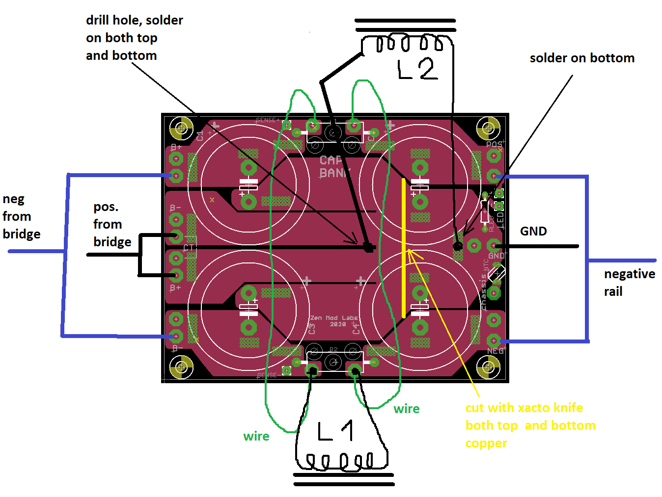

are you sure in your cap arrangement, using my Cap Bank pcb, but for single rail use - as needed for Lazy?

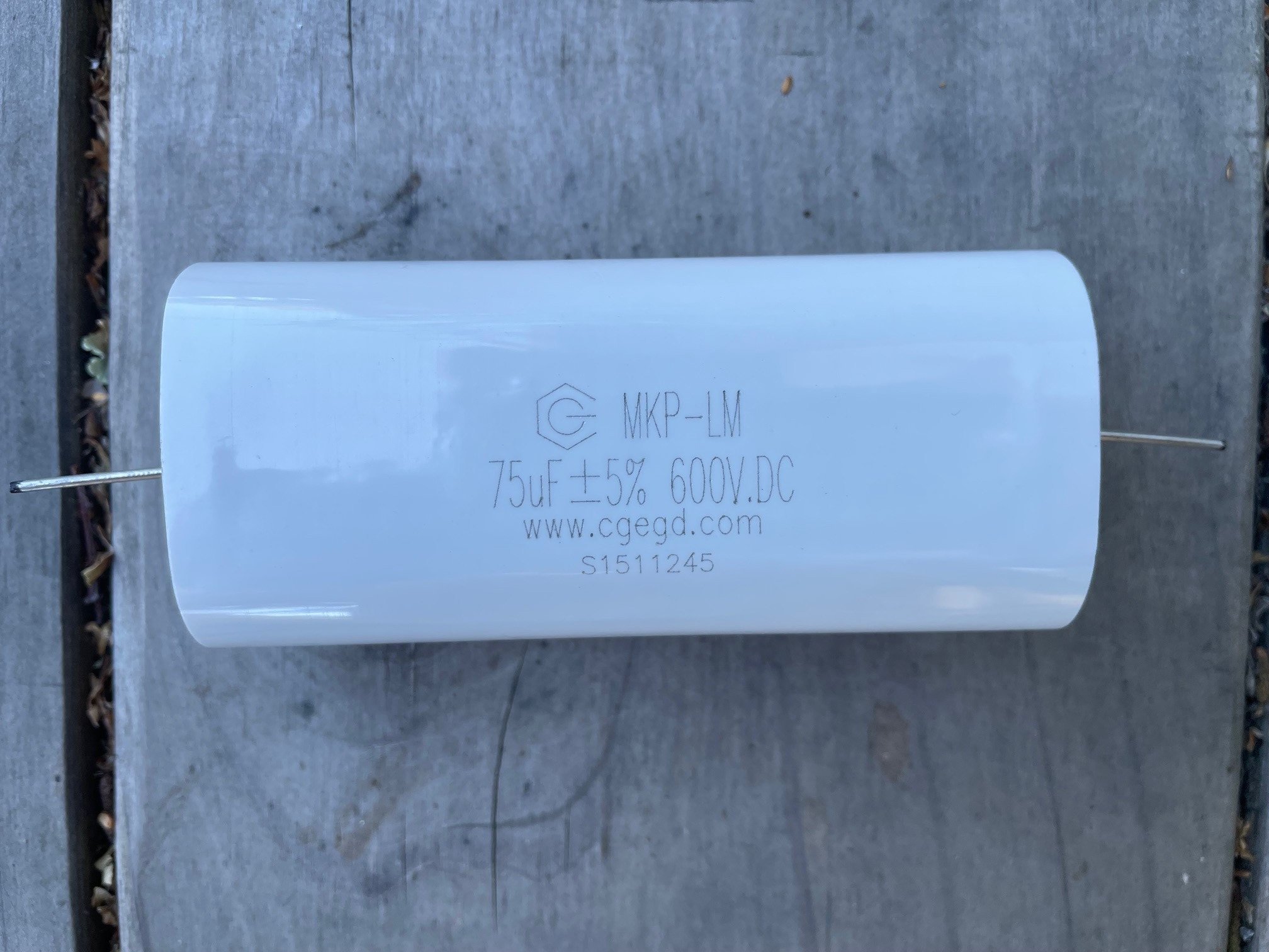

Meanwhile, here are the aforementioned film caps

gimme some time, I have proper sketch for that from before
just confirm - what PSU per channel - CLC, as straight GND line and L on negative rail, one Cap bank pcb per channel?
in fact, please describe entire arrangement ......

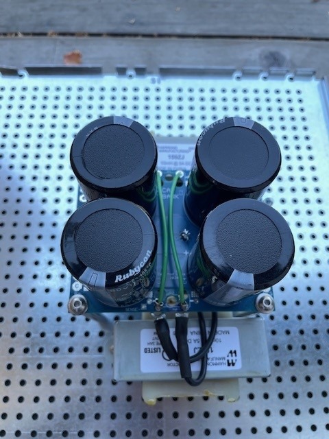

Monoblocks, two of the new Gianluca DIY chassis. Per channel: AU-5450 500VA transformer, two Vishay bridge rectifiers one per secondary into your PS board with four 12 mF 80V caps. Two Hammond 159ZJ 10mH chokes, POS from PS PCB to SIT drain screw, NEG from PS PCB to Mu MOSFET drain screw.

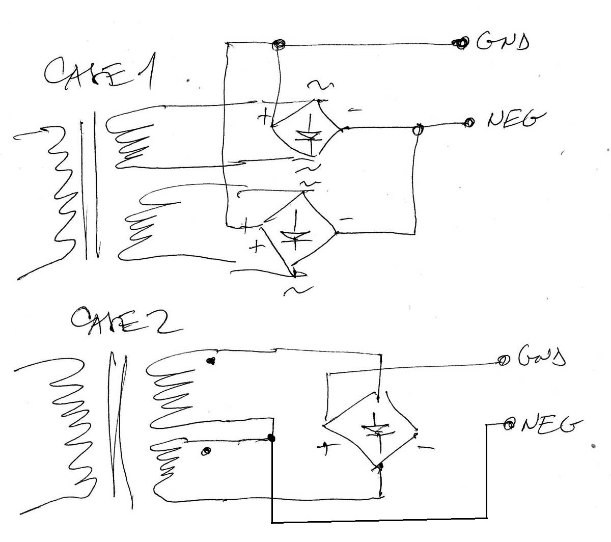

first thing first
I would choose Case 2
Note proper phasing of secs for Case 2; for Case 1 phasing is irrelevant
Edit: when having single rail output, no benefits of bridge-per-secondary arrangement; loading of two secondaries is always identical, whatever bridge arrangement is
Good copy. Case 2 it shall be, noting phase advantage. Standing by.first thing first

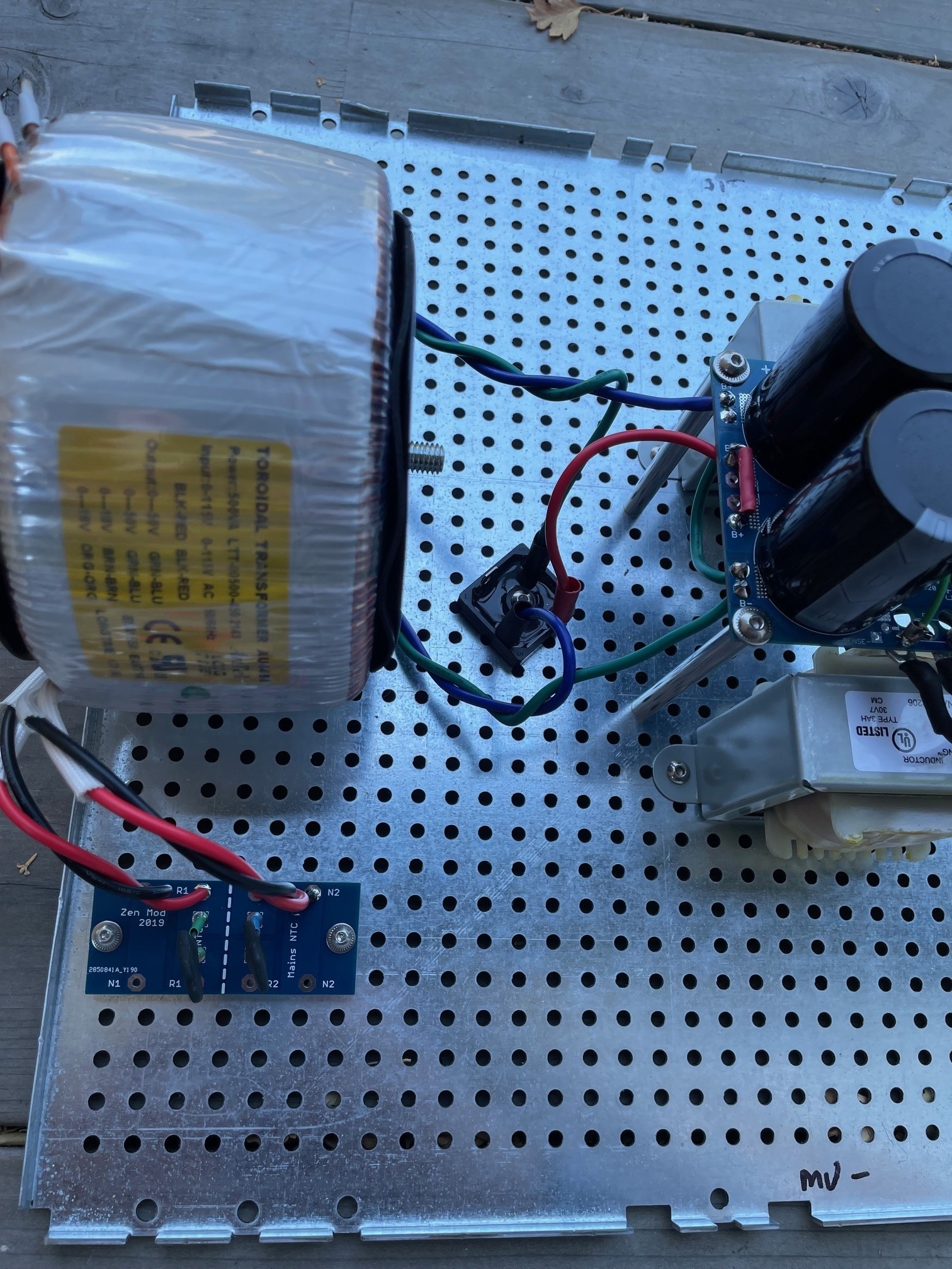

Lifted the NTC PCB with 12mm standoffs. Applied DMT between house and IEC inlet. Passed test. PS shows 71V unloaded. Thanks ZM!

with our modified PS PCB, am I correct in thinking I need to rotate the LED 180 degrees for the new configuration?
yeah
calc res. value as 1K per rail Volt
