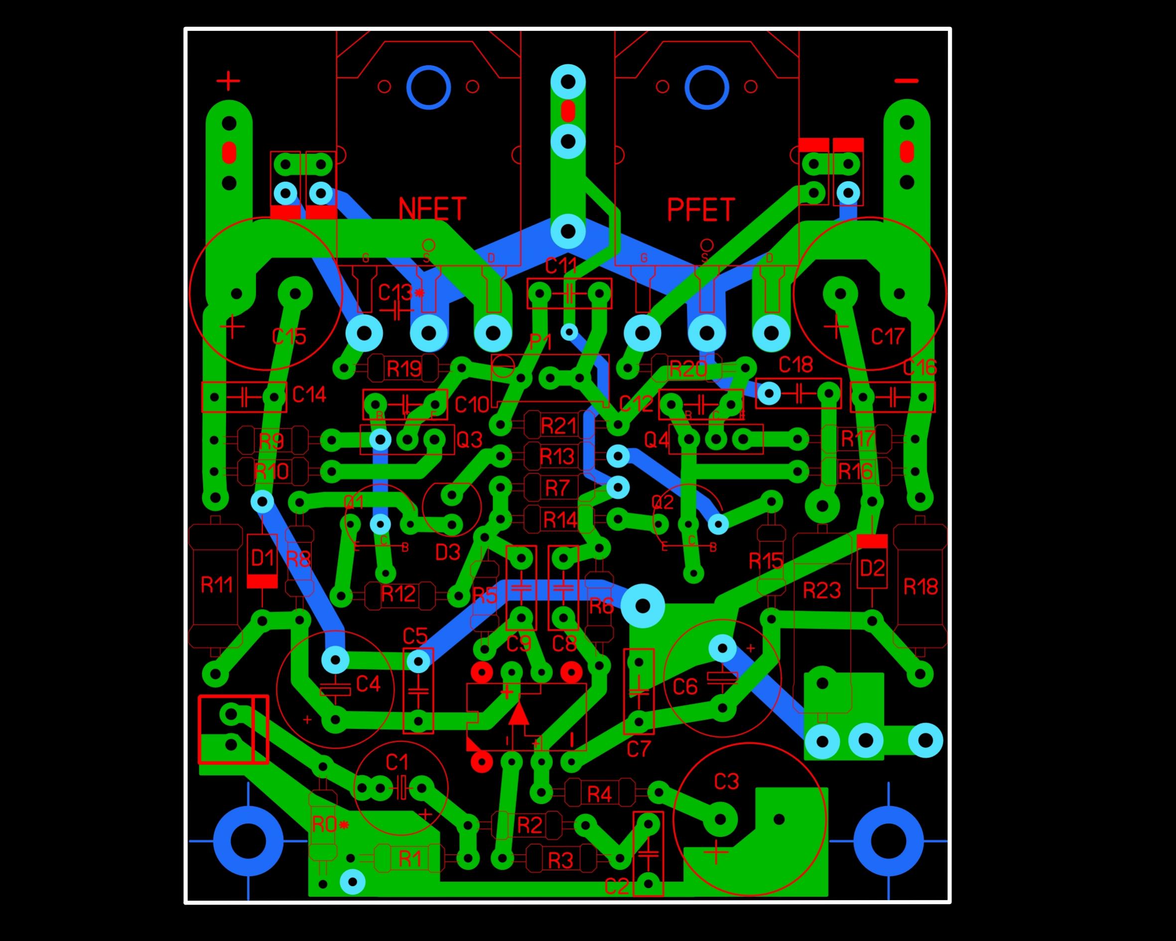

Here's the Gerbers, drill file and SL6 file. They should be enough to play with.
Remember:
1. SL6 file is zipped so you need to uncompress first
2. Component numbering is as per my earlier post, not same as Minek123's.
If you don't have Sprint Layout, there is a free viewer.🙂

Tcd1963,
Thanks for posting the Gerbers.
Just curious,
-Why the decision not to through-plate all of the pads?
-Omission of unused opamp lead pads?
Just curious,

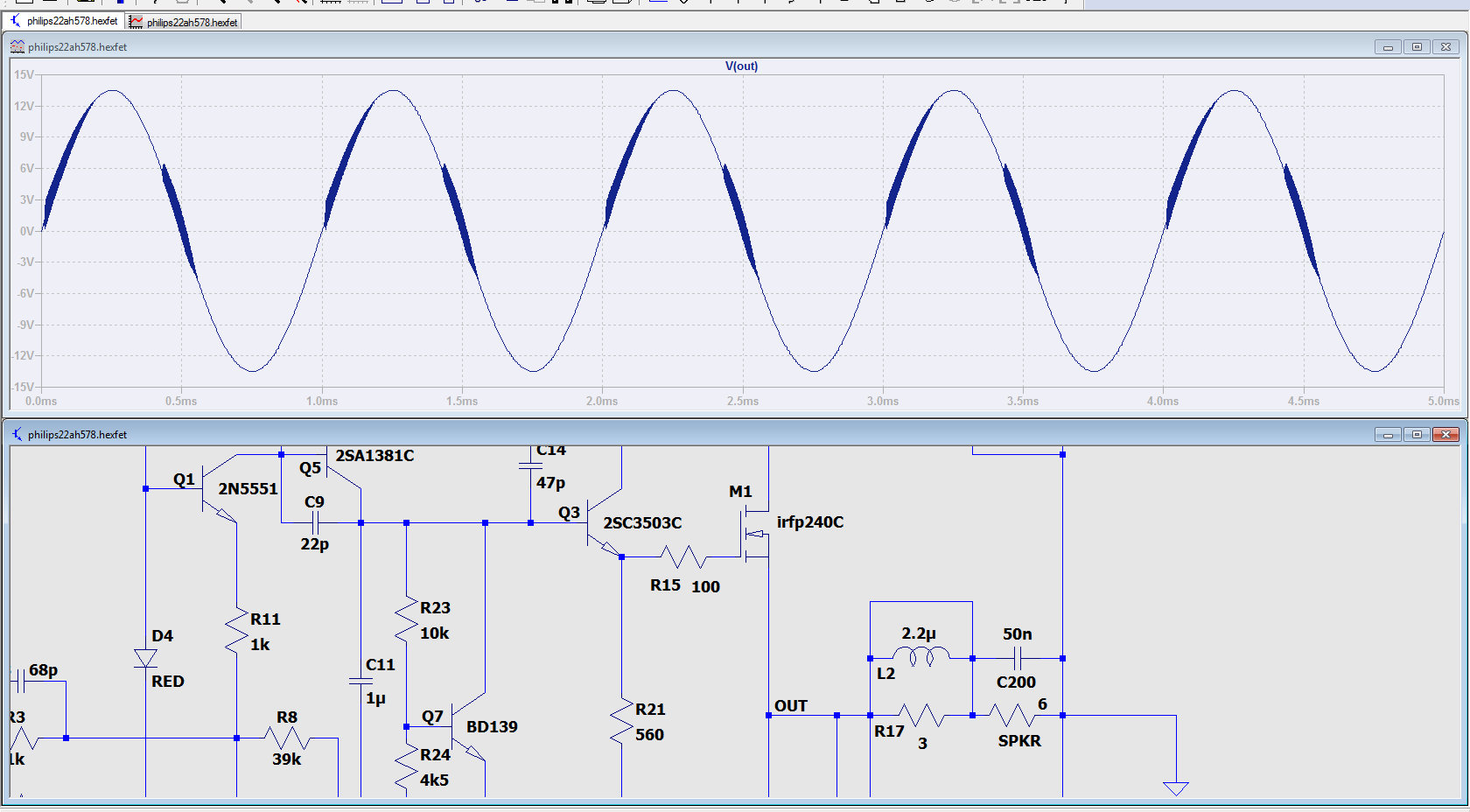

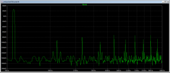

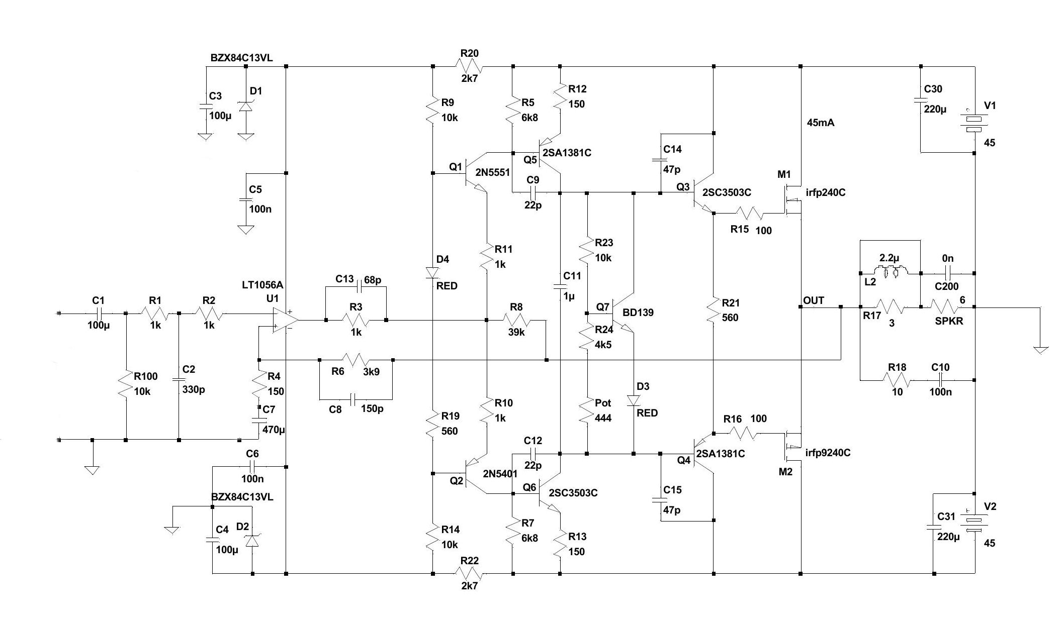

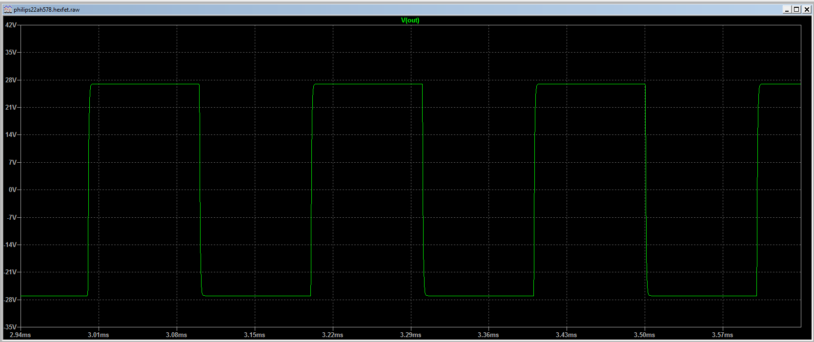

Since LatFet devices are expensive, and the only source of them is Exicon from UK (shipping takes long), here is Vertical Fet version.
Popular IRFP240/IRFP9240 devices can be used.
Or, even better: FQA27N25/FQA36P15 pair.
The sim here (attached) has been done for IRFP devices.
Compared with LetFet version - drivers have been added, and thermal tracking bias spreader. All the parameters are comparable to LatFet version.
Sim has been tested for 1kHz, 10kHz, 20kHz waves, squares, and clipping, and the amp seems to behave very stable.
Slew rate seems to be in 40V/us range, which isn't bad.
For vertical fets, gate protection Zeners should be added in the actual build.

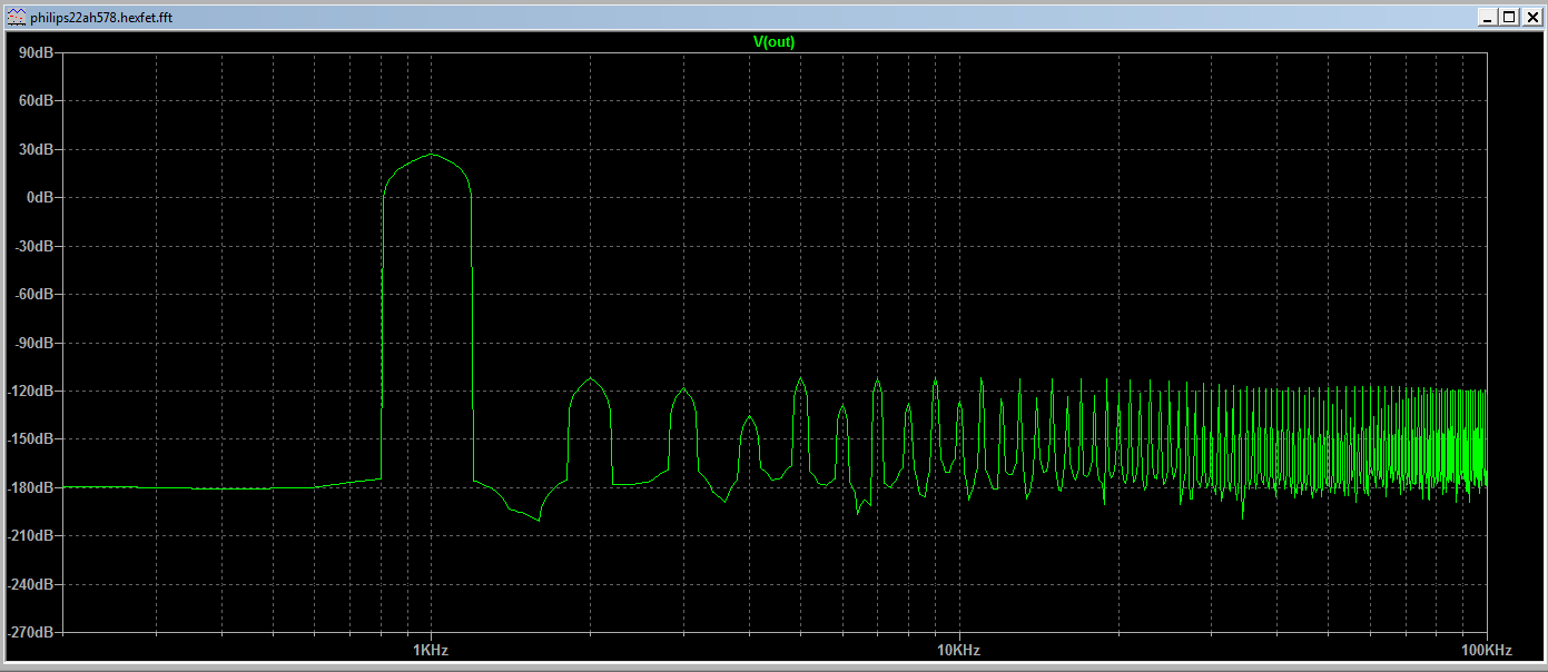

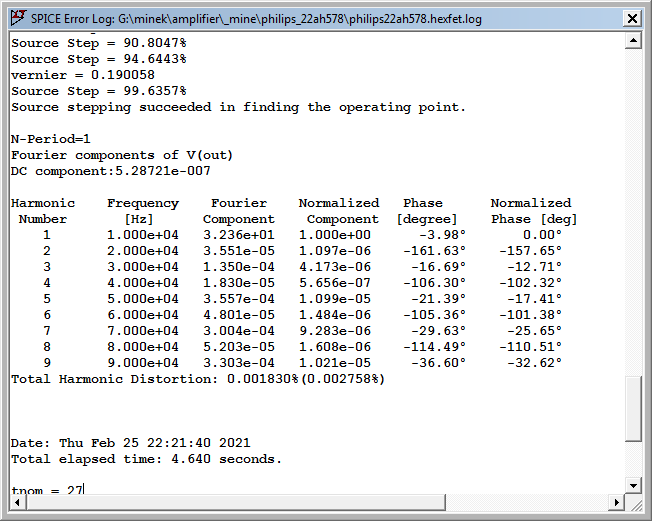

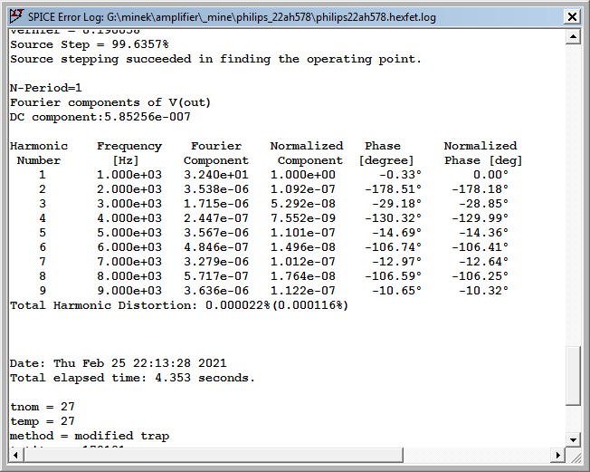

Thd and FFT screenshots attached for 1kHz and 10kHz sinus waves.

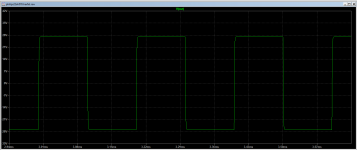

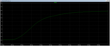

5kHz square wave + zoom to show the rise time.
Source resistors are not needed - if using just 1 pair of output devices.

Tcd1963,
Just curious,
If any rework is required, then desoldering pads on one side is a lot easier than desoldering through plated pads. I sometimes also spray the completed underside with PCB lacquer and don't particularly want to to spray the top side components.
The unused opamp lead pads waa my shortcut since space between the resistor leads and the opamp leads was very little. Perhaps better arrangement of the resistors would have helped...🙂

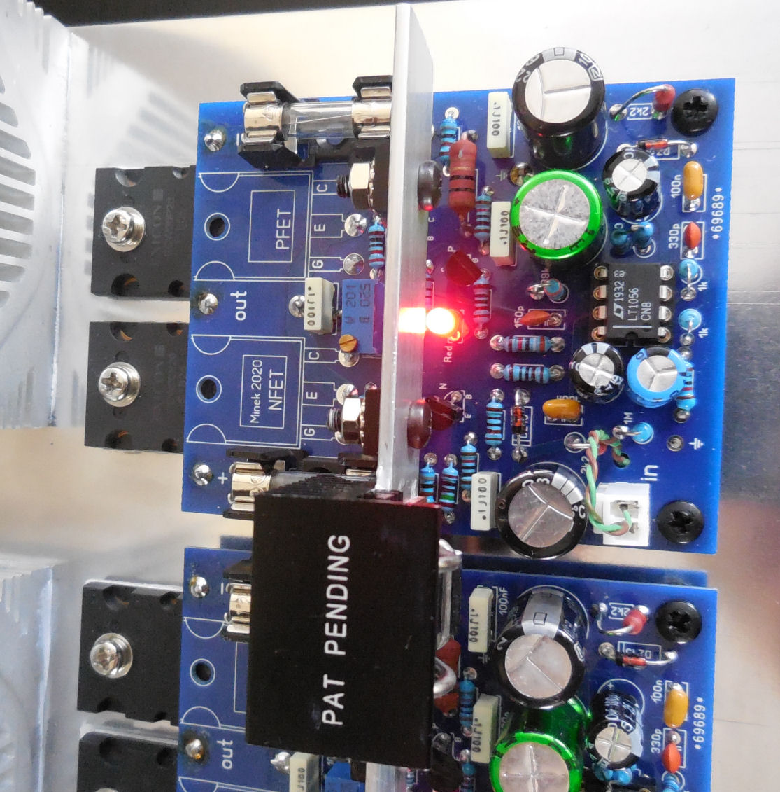

For a reference, here is a closeup of the assembled board.
As the values of the resistors/caps please refer to the schematic from the 1st post.
Some of the values printed on the silkscreen are not correct - they have been tweaked during prototyping/testing.
C15 (68pF) has been soldered under the PCB, in parallel to R3.

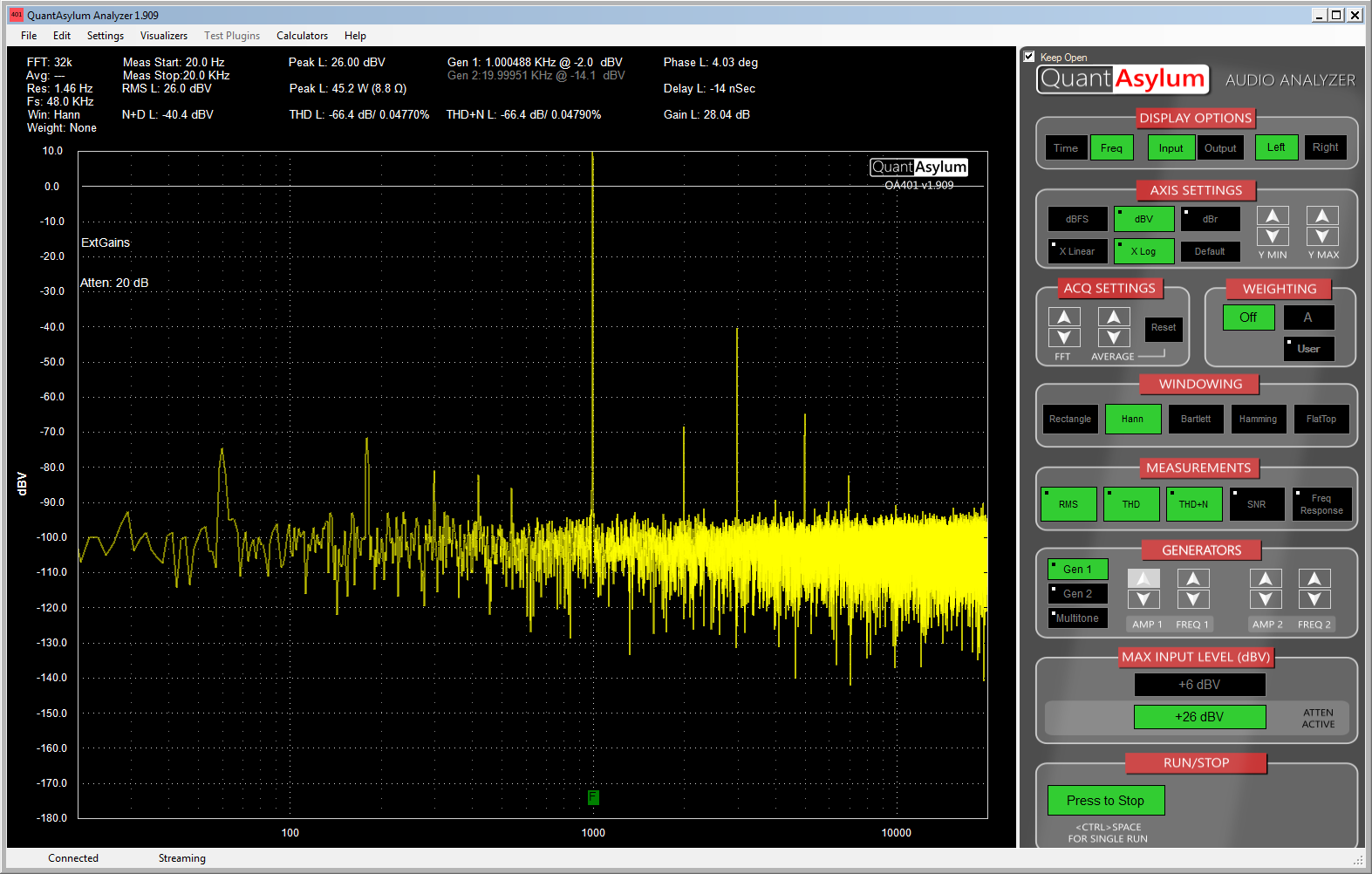

So while ago I bought QA401 Quant Asylum audio analyzer.
Finally today, I gave it first try.
It's a complicated tool, and I guess I have a lot to learn how to properly use it.
Just few observation for now.
I tried to measure this amp (LatFet based on Phillips AH578).
First of all I'm not sure if these measurements are worth anything since the noise floor reported by QA401 is at -100dB (with amp OFF).
Kind of high. The examples from QA user guide show noise floor at -140dB.
Simmed FFT profile for this amp is well below -100dB.
So most likely most of the information we want to see is below noise level.
Anyway, I tried to test.

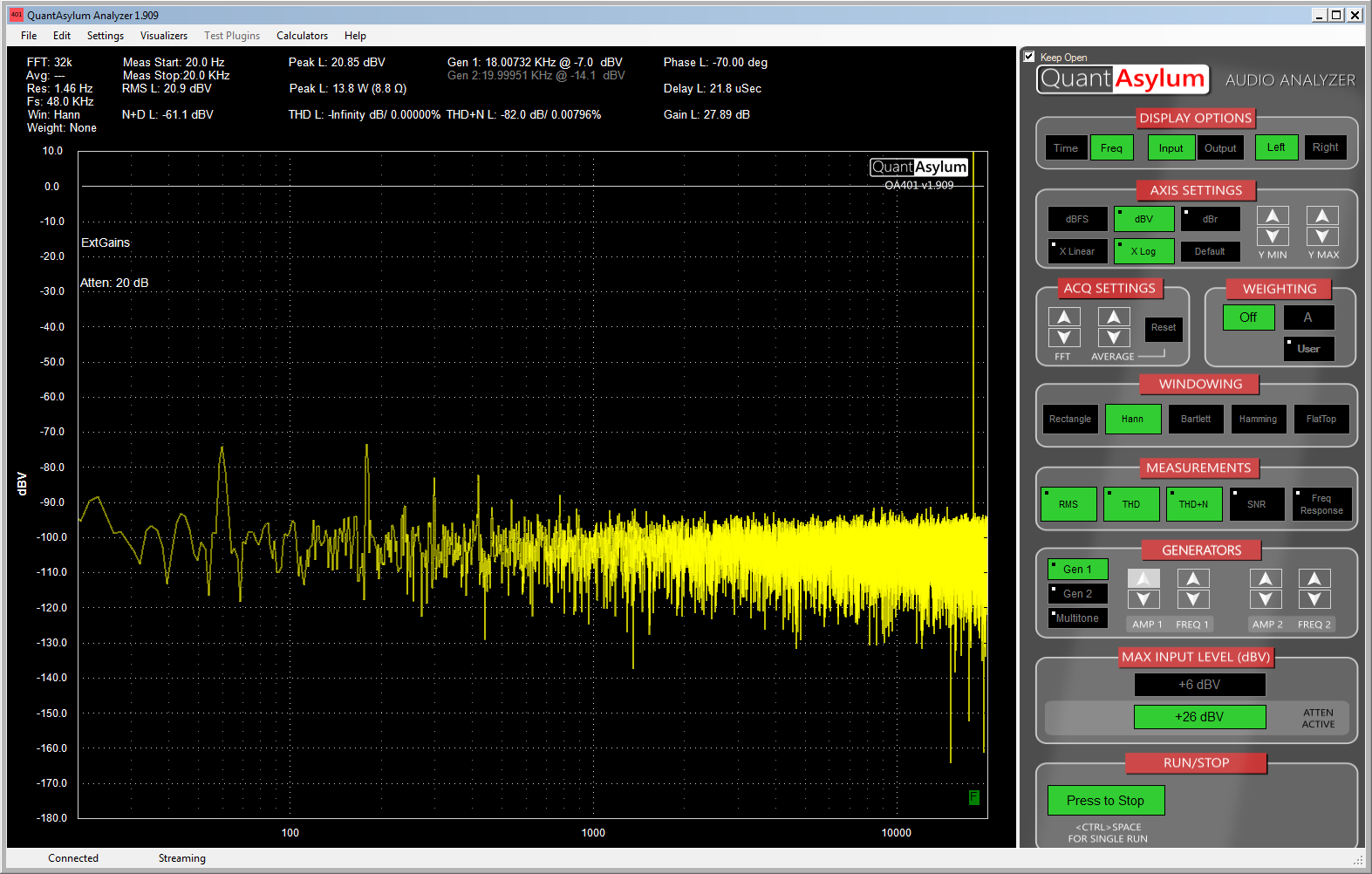

Gain reported: 28dB
"Thd + noise floor" never goes above 0.04%, even for 20kHz signal.
Just "Thd" is usually lower.
So if these results are correct, that's not too bad..
Strange thing - the higher the frequency, Thd seems to go down a bit.
FFT profile measured/shown is pretty much indstinguishable from 'noise floor' with exception of harmonics showing spikes, which looks more or less normal.
So far I didn't go over 40W of power - not sure if my dummy load I built for this test can take more than 40W for more than several seconds...
It was running pretty hot..
Few screenshots attached.

Very good results. Very low even harmonics, as expected from this topology. It is similar to the ASR Emitter, as I mentioned earlier. Although I don't think Hugh will like this profile.
