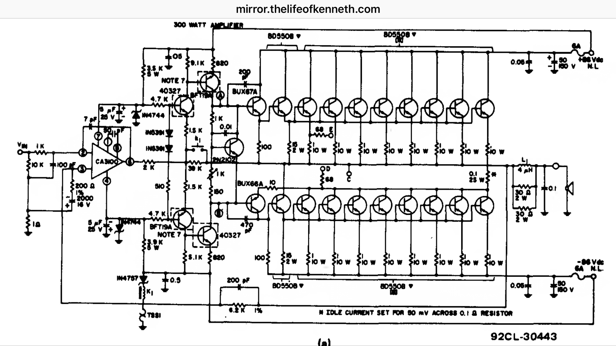

This is amp was supposedly designed/built by Philips.
Here I found on my PC, some old schematic that looks _exactly_ the same,
and it's branded as RCA 92CL-30443 amp.
RCA schematic is using different transistors.
Both amps, Philips and RCA were released in 1978.
I wonder what's the story behind this...
Did RCA work together with Philips on this? Or one copied from another..
