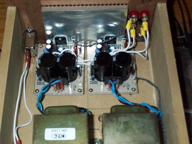

Ok, I changed the resistor values as Chris suggested (adjusted for what I had in stock) and I can say it was a good move. The amp seems to have more "energy" and headroom now. I think lowering the gain on the LM3886 helped substantially. I am really enjoying this amp. Excellent transient response. I have been listening to classical music all day so far. I will try some rock/alternative later.
All in all a very successful experiment! :up:
The DCoffset is 3.4mv on both channels. Not bad....
I added a 10K3W resistor across the rails to drain the big caps after power down. 🙂
Cheers!
Russ

well, in this case i say good, however remember the gain of this modified circuit is a little bit higher then the one you listed. in many cases, merely listening to slightly louder music can seem to bring out more detail, impact, energy, ect...
really, with the chipamps, anything beyond the schematic shown in the datasheet* is extra. not to say these modifications aren't worth exploring, but from the engineering standpoint, well, the added complexity almost nevers serves a purpose.
*exception of the inverting config listed in the 4780 datasheets which has errors. i've emailed them twice on this one.
Yes, I had thought of that, but it truly beyond that. I have been listening at all sorts of different volumes, the volume knob never stays in one place all day. 🙂 I think that what I am hearing is a result of the LM3886 itself being at lower gain, which I know from past experience does have positive efftects, especially inverting. 😀 Still that is a very good tip.

In this case, I think it works because the stages compilment each other. The first stage aids the inverting opamp, the secondstage aids the low gain inverting power opamp. It seems many agree that virtually any inverting opamp(power or otherwise) benefits from a fast buffer.
The next test I will do is toi use the AD8620 as it has a bit higher current outpout capability, and it is a bit faster yet still well compensated internally.
That's my experience too, and I have posted this several times.
They work better with gains up to 20~22, which are fine for a power amp.
This is true for inverting or non-inverting.
The rest of the gain should be on the preamp, instead of using more gain on the power amp chip and a volume pot (with or without buffer) behind it.
