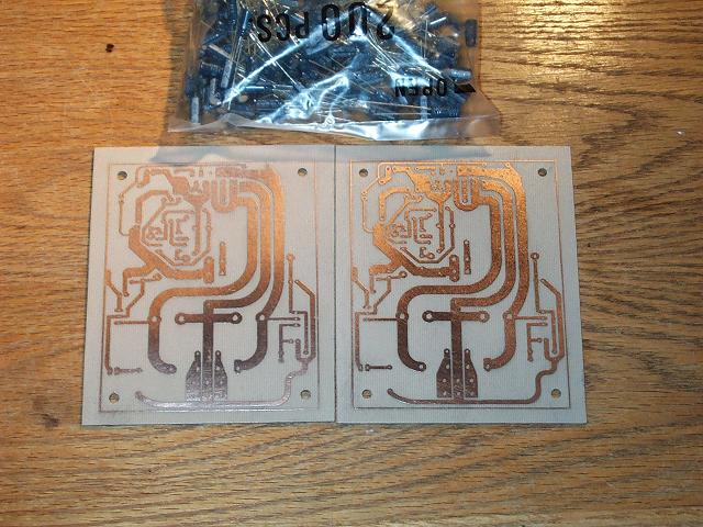

Latest experiment... Inverting-NOT
Boards etched. I really like this tonertransfer method with the jetprint paper. 🙂

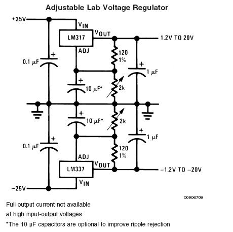

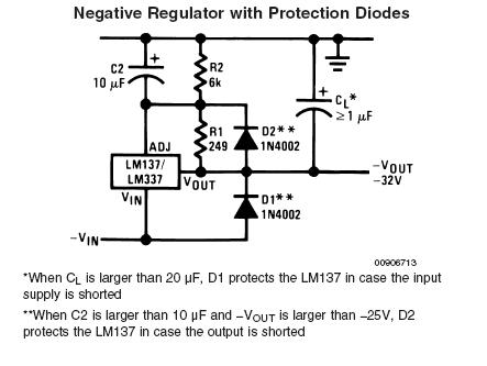

Russ White said:
And here is the schematic for diode protected regulator. Notice that you only need this if the inputs can become shorted.... I really don't anticipate that... 🙂
I recommend that you use the protection diodes, as you are using 'big' caps.
Read the text on the National datasheet.
Not that you will have problems without the diodes, but if you care about reliability.
