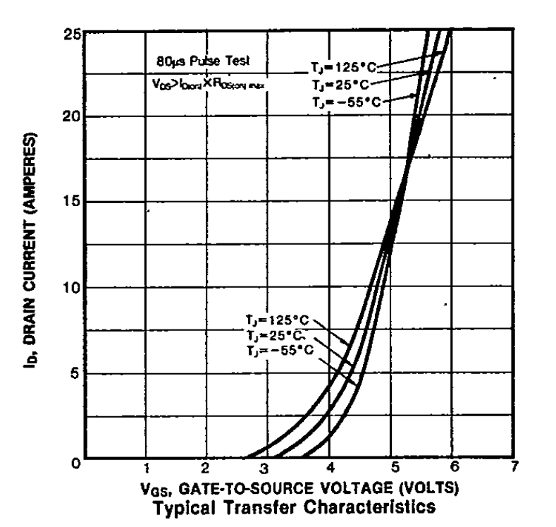

In the Hitachi datasheet the graph only goes to 1A.
From your test, do I understand that right... linearity with 2A bias would be much better than with 0.5A ???
And in the datasheet of IRF250 it looks like you need 6A bias to enter the most linear region ?

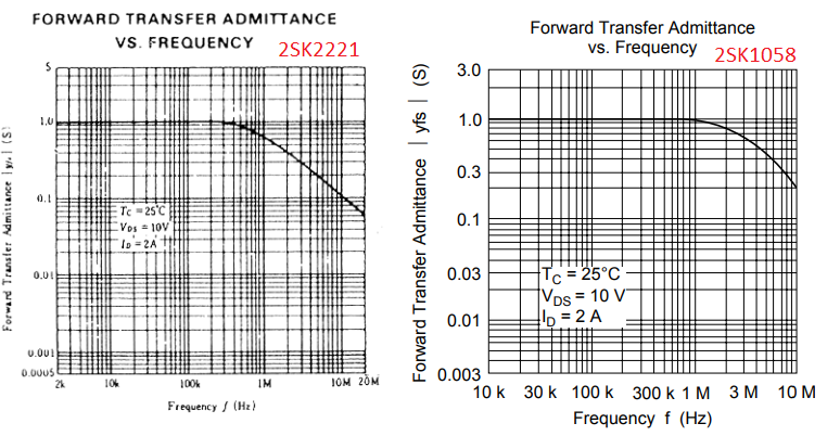

BTW, does anybody have experience with the 2SK2221? Less expensive than 2SK1058. I saw the tests that EUVL posted that indicate the Exicons are the best laterals, and they have the capacitance curves on the datasheet (will be very linear in a complementary output stage, especially for low amplitude signals and zero crossing). How does the K2221 compare to the Exicons?
I should have said "have the edge in transconductance" rather than "are the best".

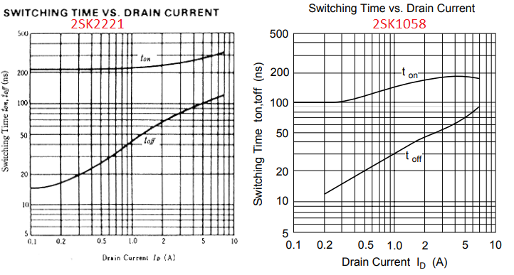

The Exicons seem to be very good in other aspects as well, such as the capacitance curves. I have not found complete capacitance curves in the Hitachi datasheets. The one thing that can be said about the 2SK2221, looking at the datasheet, is that it's slower.
About capacitances and switching times: I used to link one thing to the other, this is wrong of course. Parts can be very fast yet have high and non-linear capacitances. For example: the big sony and yamaha VFETs.

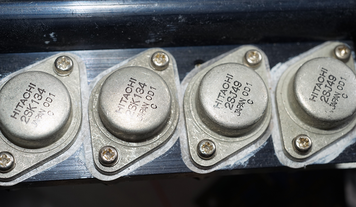

I first built a amplifier with single fets, now want test groups of 3.
No matching, just use triples with same date code, removed from PA amps.
What kind of matching would you suggest ?
I was thinking about matching for Vgs at working Vds and working idle current.
And comparing /monitoring the in-amp waveforms across the source resistors.
