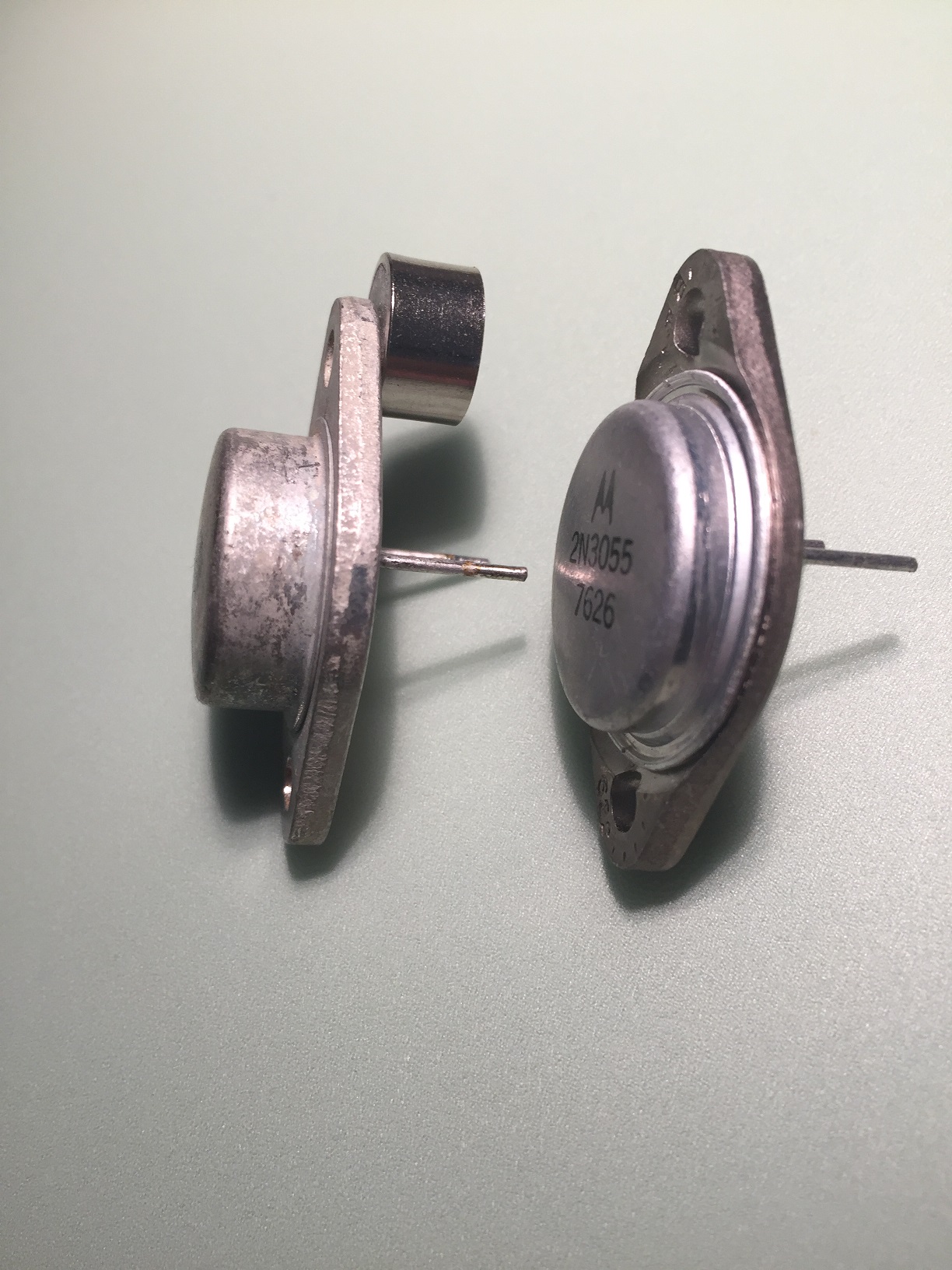

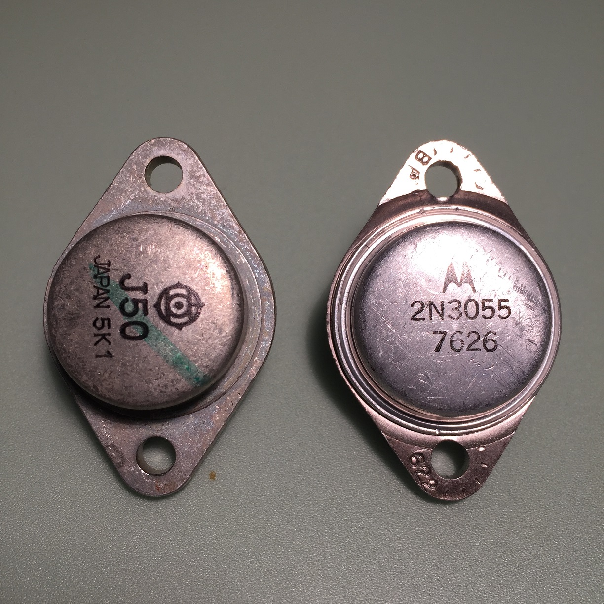

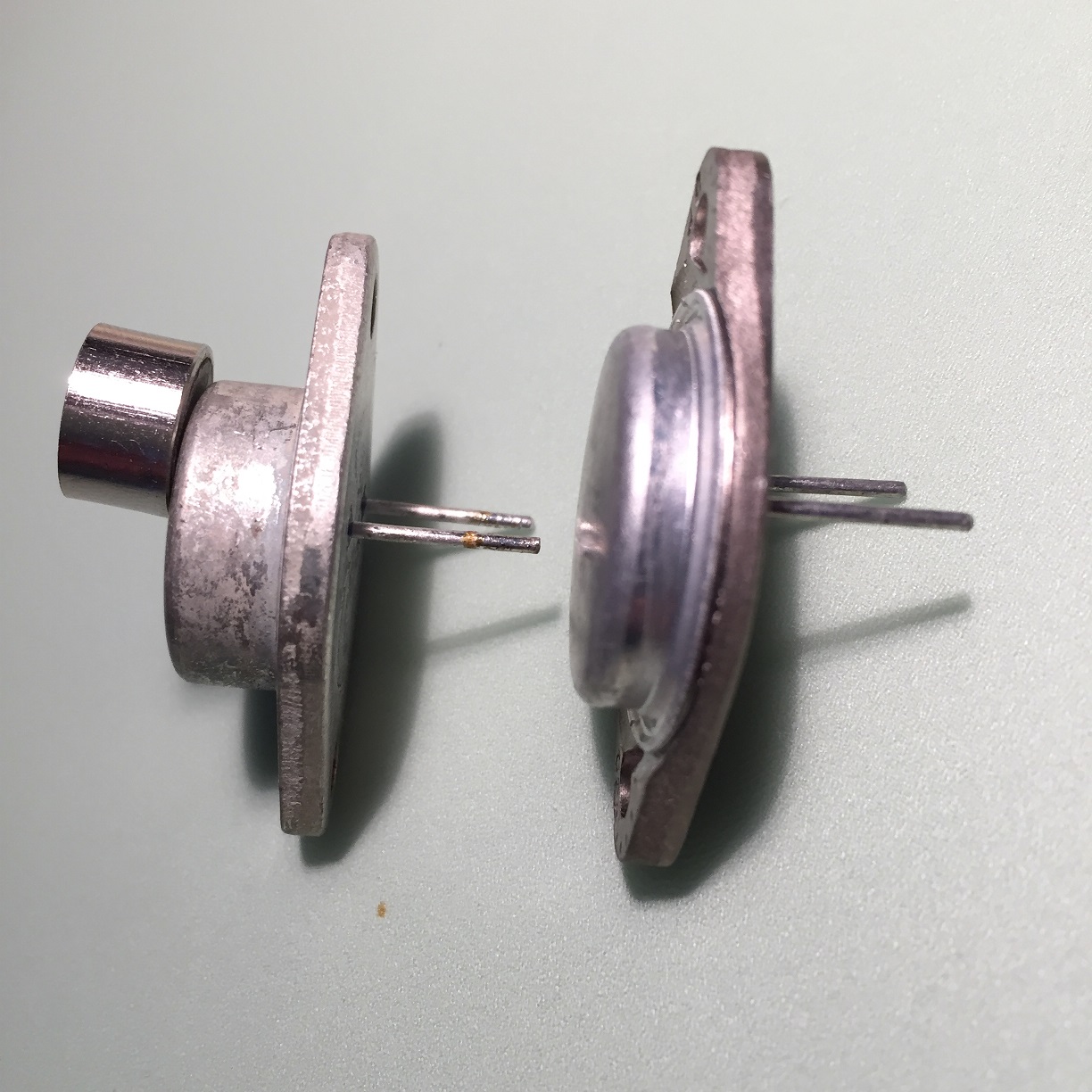

No, look at the attached pictures. The magnet sticks with a "smack" noice.
The Motorola transistor is made of an aluminum alloy and does not stick to the magnet at all. All standard aluminum alloys contains <0.7 % iron but they are all non-magnetic.

Hold your magnet to the leads of the Hitachi device, steel.
Magnesium has half the magnetic susceptibility of aluminum, but a magnesium gearbox acts soft magnetic, despite a Km barely over 1.
Only hard magnetic metals are iron, nickel and cobalt. (not counting manganese or buckyballs)
Stuff like alnico is highly ferromagnetic, but can only be casted, at least two times as heavy as aluminum, and hardly corrodes.
As you confirmed, regular aluminum alloys contain 0.7 percent iron or less.
4000 series are 0.8 percent, but most of the high silicon types are intended as welding wire.
8000 series go up to 1 percent Fe, but very very unlikely to have been used for a transistor case.
Of 1000-7000 series alloys, the TO-3 hat can only have been press (pulled) formed with either 3xxx or 5xxx aluminum alloy.

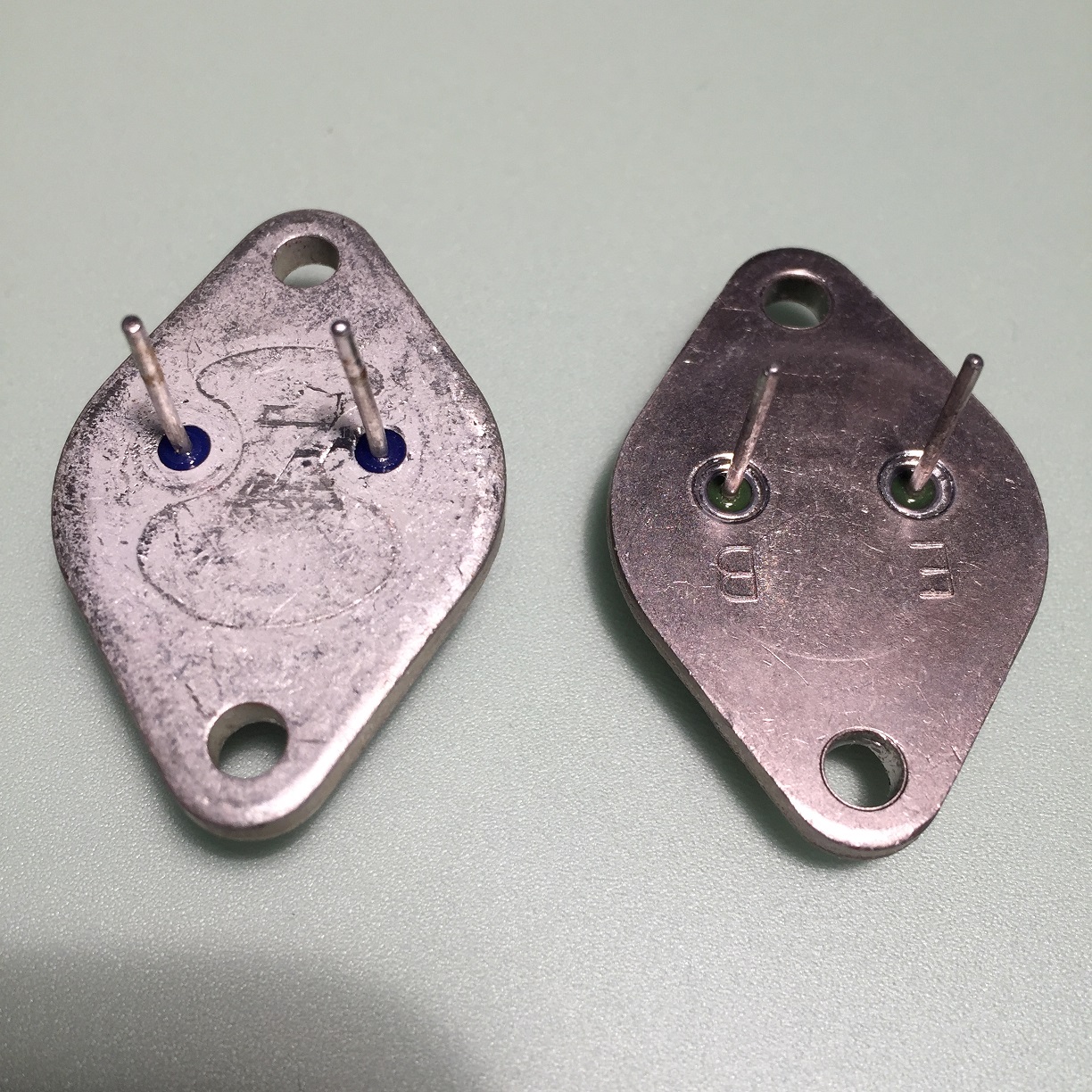

post69 Pic2 left side shows the "8" shaped copper slug in the surrounding steel backplate.No, look at the attached pictures. The magnet sticks with a "smack" noice.
The right device shows a thin curved line.
Is that the edge of a copper slug in the middle of the aluminium alloy backplate?

Sorry but that *thick* steel base transistor is a fake in my book.
Thick copper is good; thick iron is useless.
The "8" shaped copper plug is an attempt to correct this; good on choice of material, bad because it wastes base surface (the iron part does not count for all practical purposes).
My very old To3 Toshiba 2n3773 have the "8" copper slug in the steel surround.
My ONsemi To3 MJ15003/4 & MJ21193/4 show a plain steel backplate.
Looks like my collection of GE/RCA 2N3772. Unfortunately they are highly magnetic (if it matters), but strangely they are very clean and shiny, free from any corrosion.

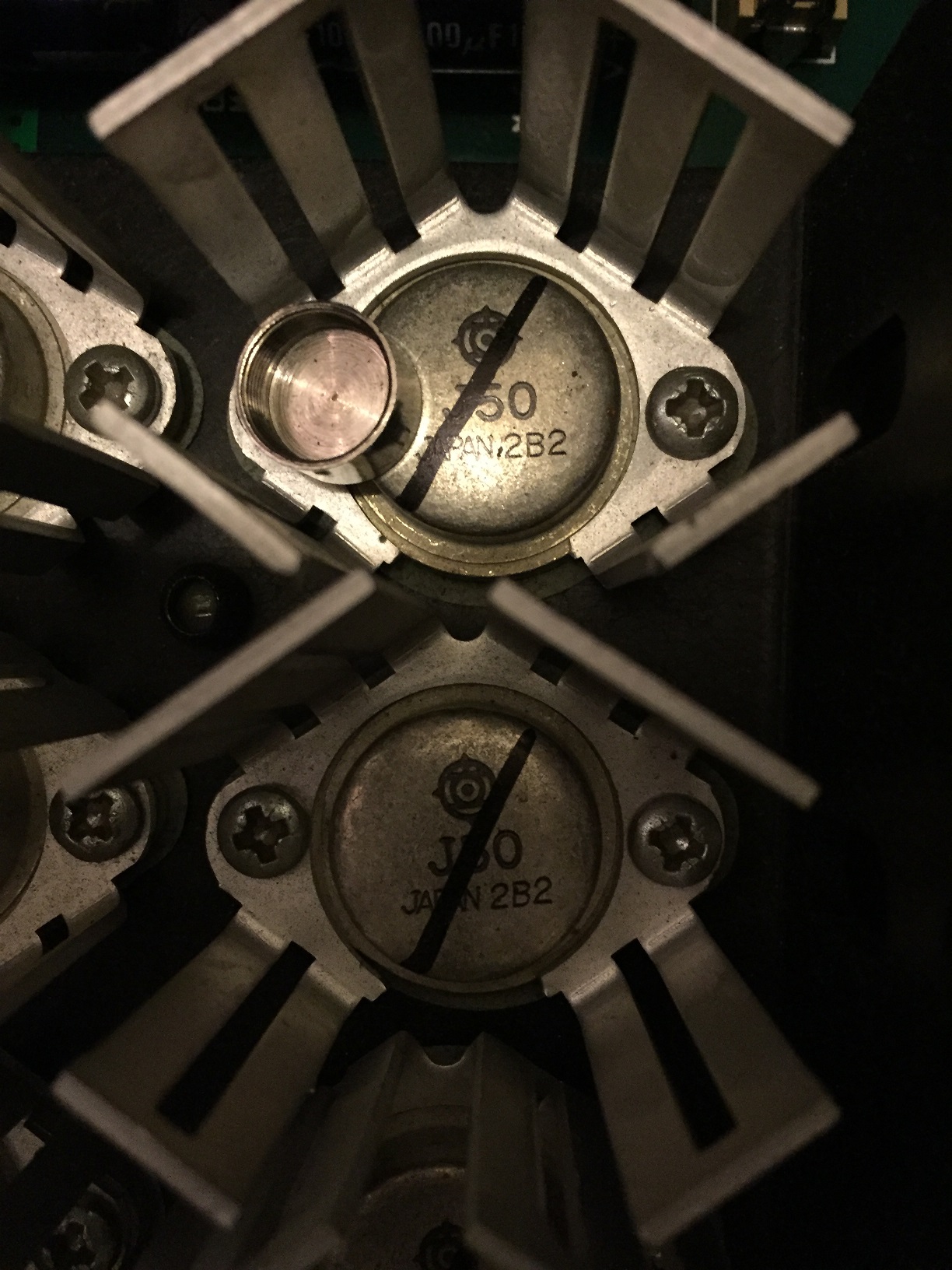

No, it is not a fake. Here is a picture from a working amplifier that has never been repaired. The magnet sticks to the top in the same way.
