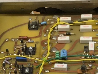

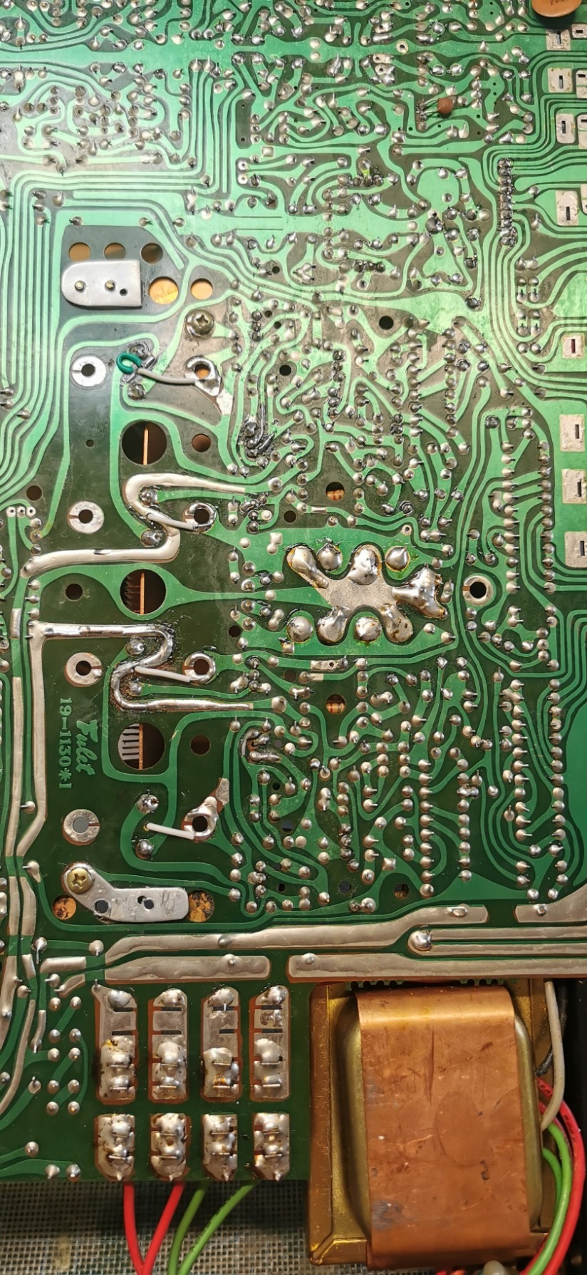

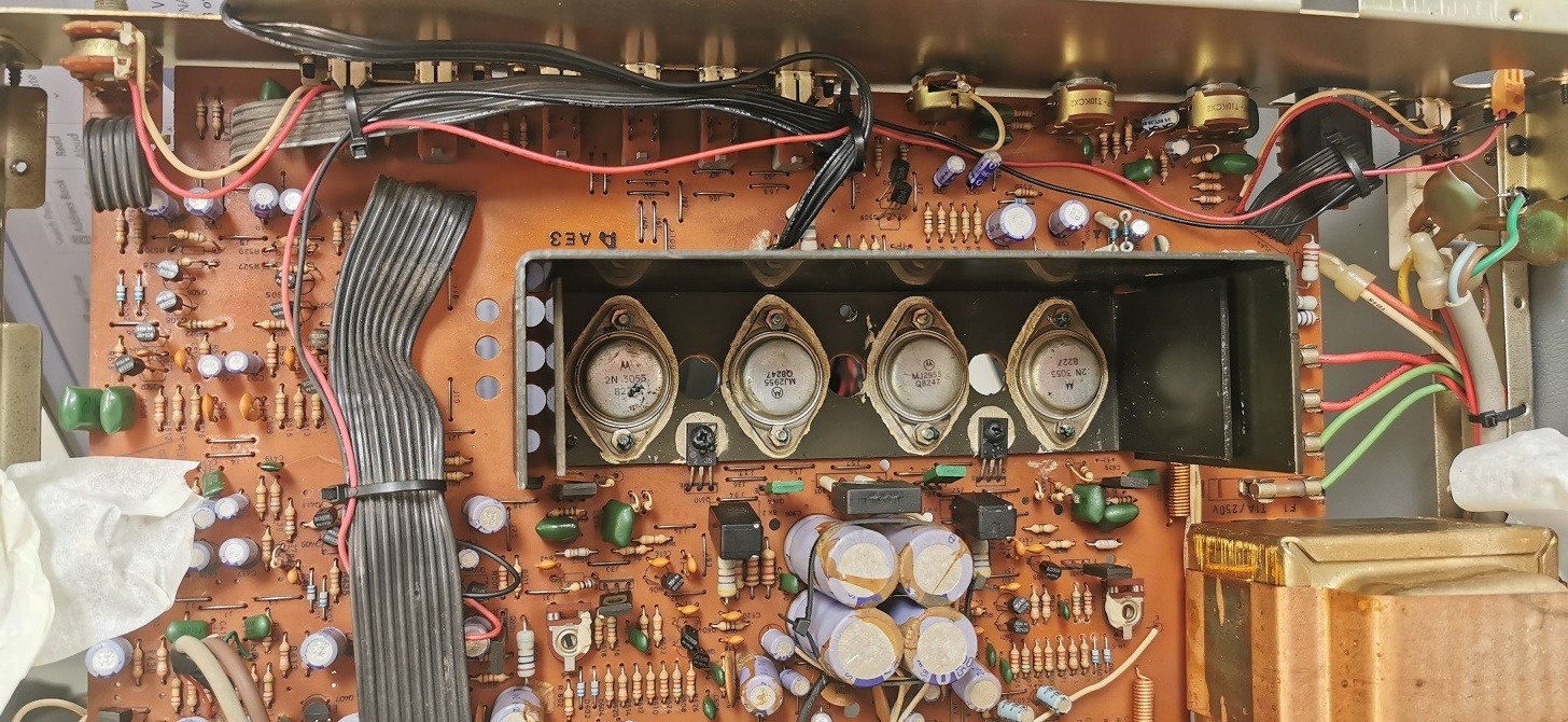

Last, but (hopefully) best ever modified and complete NAD 3020
all in now.It needs a clean up, but what a shame about the 3rd transistor down, the print came off and broke so i had to do a repair.
I have to decide now if to take it of and connect with wire or leave it.
It just looks scruffy like this
would you leave it or take it off and connect it up more neatly with wire?
so much better access around the amp now
before and after photos, and the set up now complete.Ive not removed or modified for driver removal yet, ill try the amp first with them in to make sure it all works first.

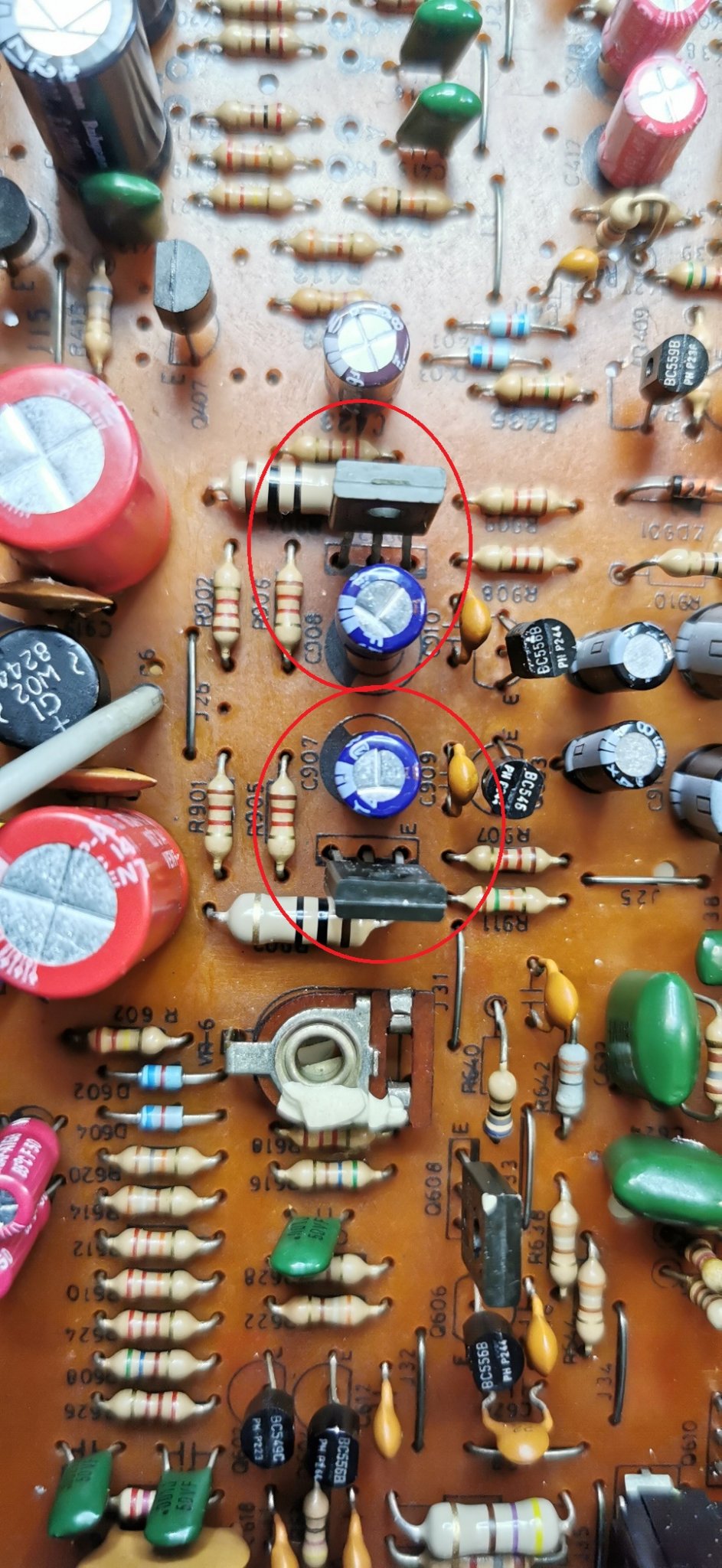

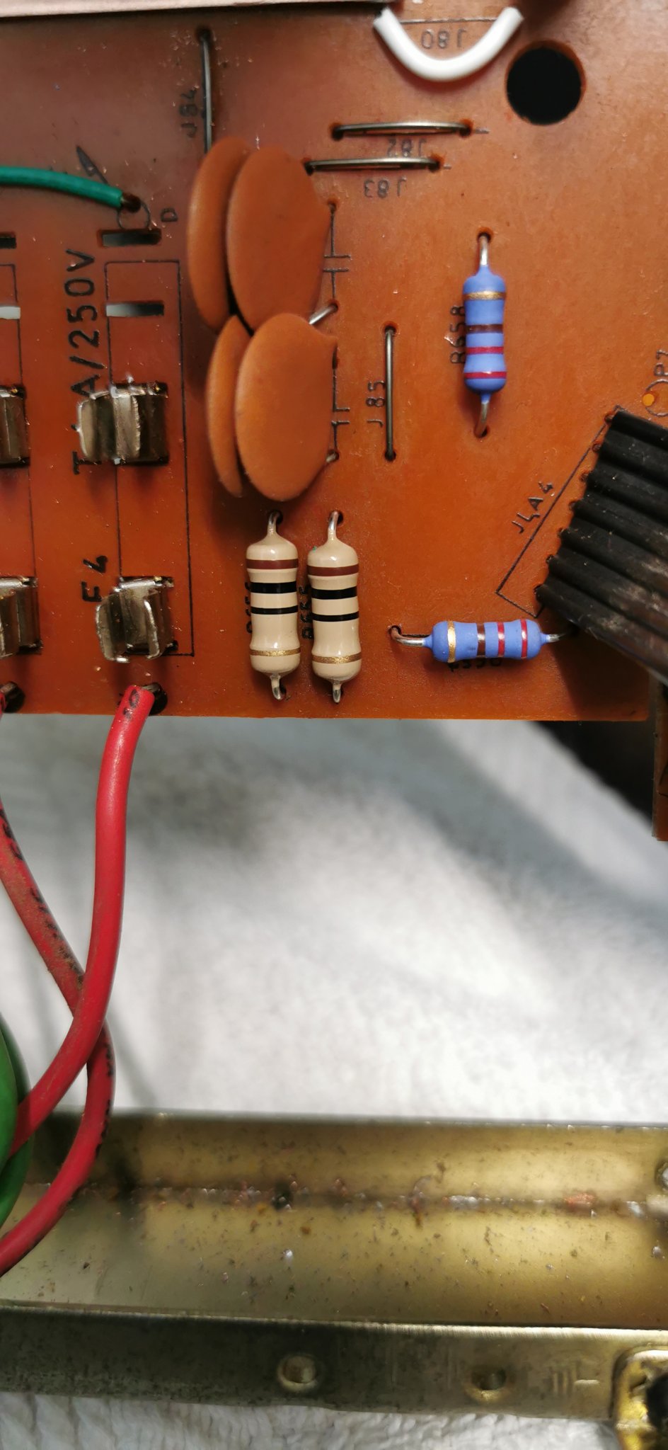

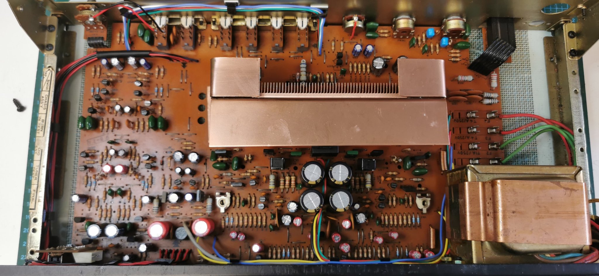

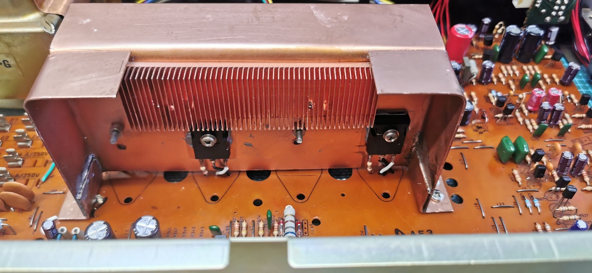

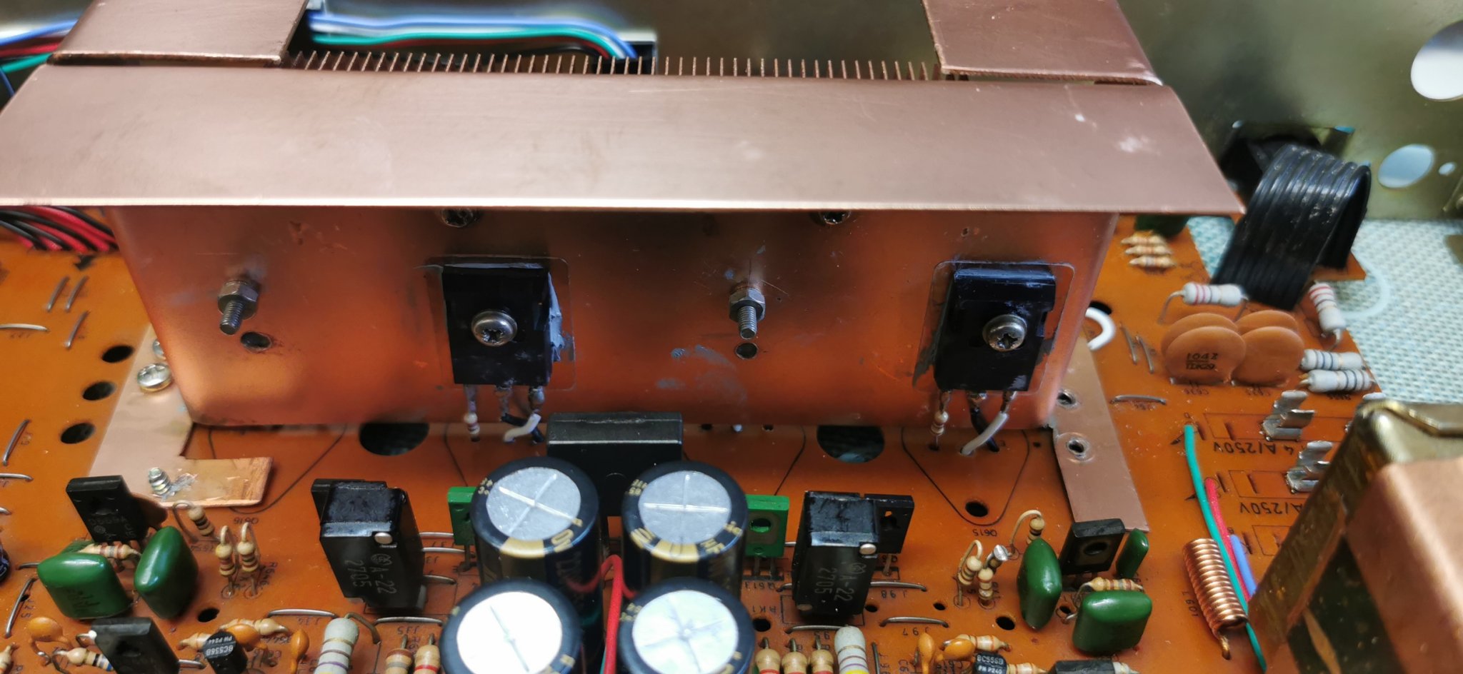

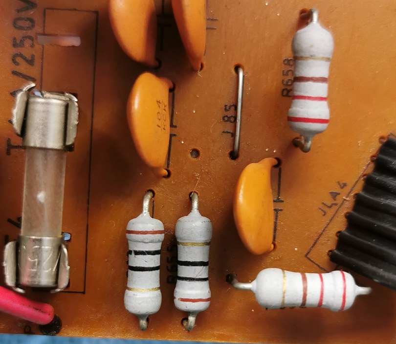

so im getting close to do some of the final bits now
ive replaced the old composite resitors with film types
ive also altered the regulated supply transitors so they are not near the caps(as @Vrystaat stated the caps dry out) all of these ar also uprated to 50v so they should last longer
as you can see in the 2 comparative photos

Thought about putting one of these little heat sinks on those pass transistors? Makes a hell of a difference in operating temperature when you’re dissipating a watt or two.

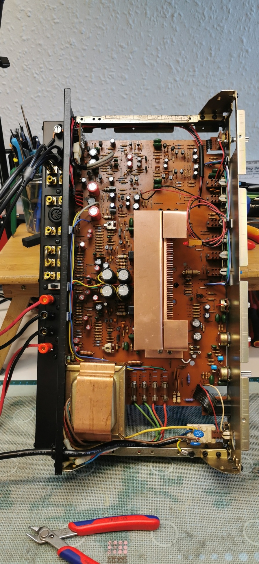

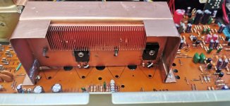

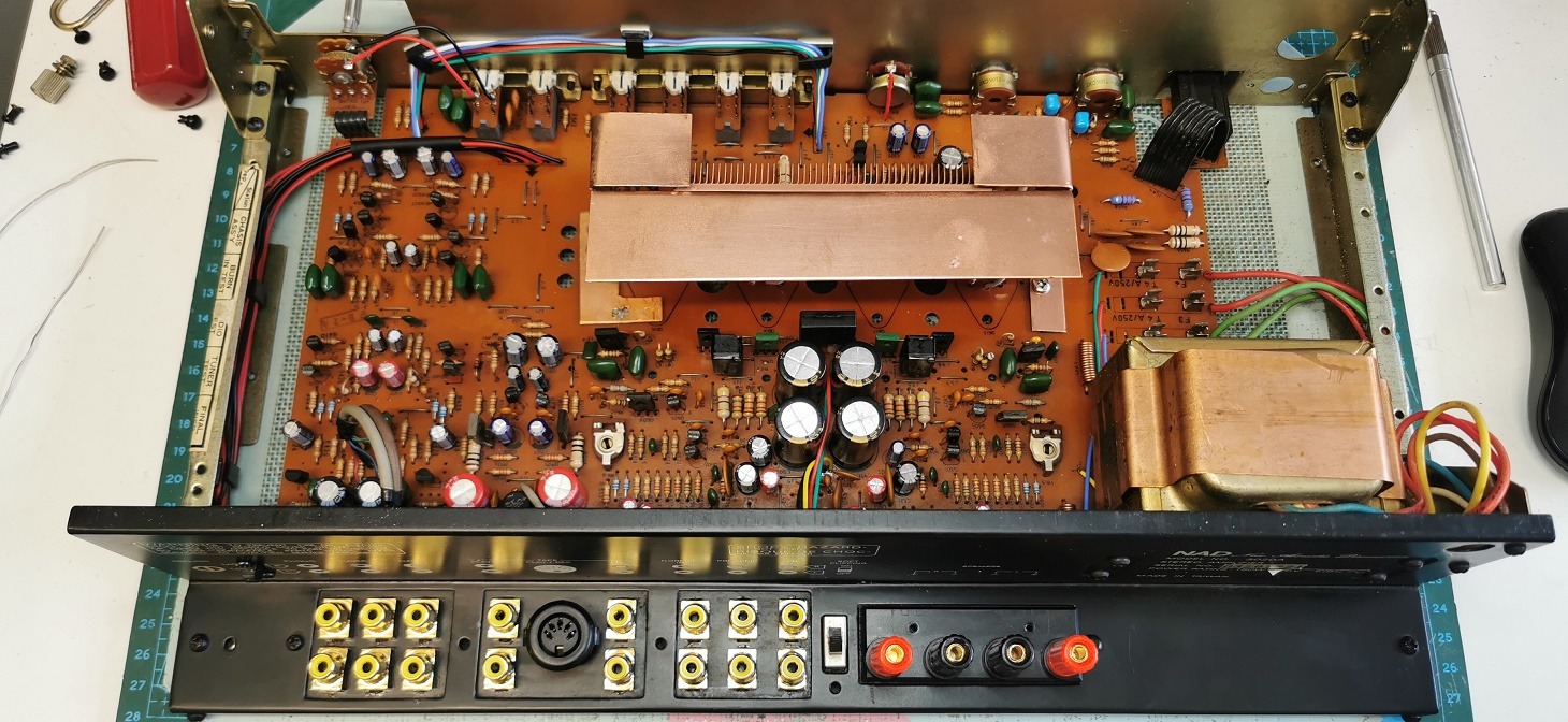

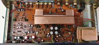

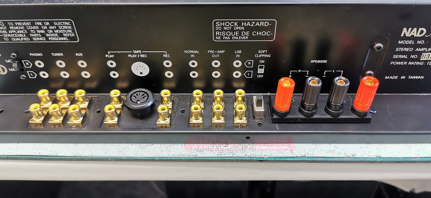

finished converting the back now, so its all down to a few little bits really,put the power cord back in and the switch,alter the base feed to the multiplier for now
I will try it with the drivers first to make sure it works.
Actualy the design, i think is actualy quite good from a lay out perspective,now the cables have been removed you can see its almost mirror image more or less for each channel on both pre and power sections,this proberbly accounts for the spagetti junction print layout.
Hopefully by the time ive finished, i will at least given it justice with the work that has been done.

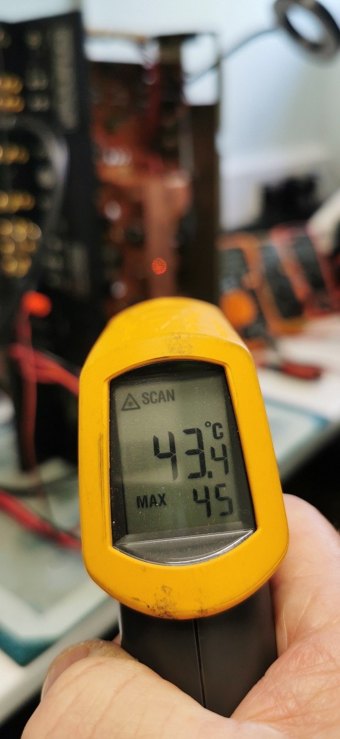

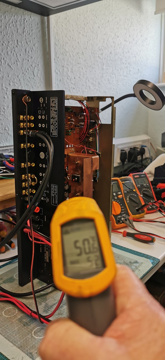

So turned on this morning, no lamp. Set up the bias at 100ma and the heatsink is getting hot but not too much. The amp sounds great, so taking my time paid off
Tried it at 30ma and then 60ma.sermed somewhat lacking at 30ma,like I had to raise the volume to hear it properly, and I'm sure a bit of distortion. Over 100ma, def less 'effort' I would say to acheive same volume and clearer
Well 100ma is the recognised point to aim for. There is also 'expectation bias' 😉 which is an appropriate term and where you are wanting the higher figure to be better. It can be worth listening for a few days at different settings and see if the impressions really are real or not.
Nice work though 👍
