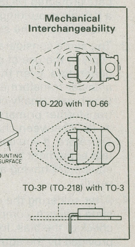

Odyssey pad has excellent thermal conductivity of 12.8W/mK but is WAY too thick to be effective here. Aluminum heatsink is about 160-200W/mK, and copper is 400w/mK.
And you've already taken a hit on thermal performance with the TO-247, which has only 1/3 the surface area in contact with the heatsink as TO-3.
Be interesting to test though. If it doesn't work I'll make up some aluminium or copper spacers

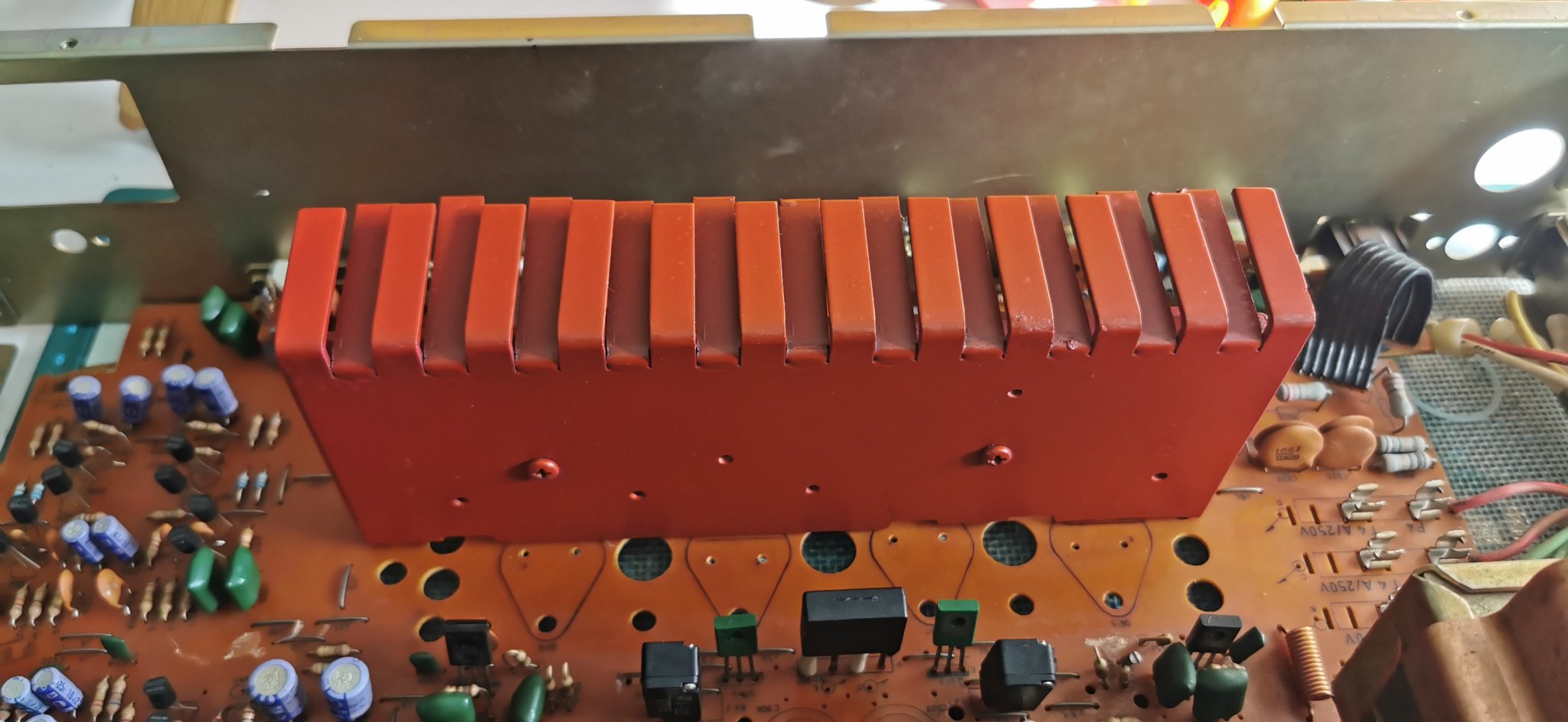

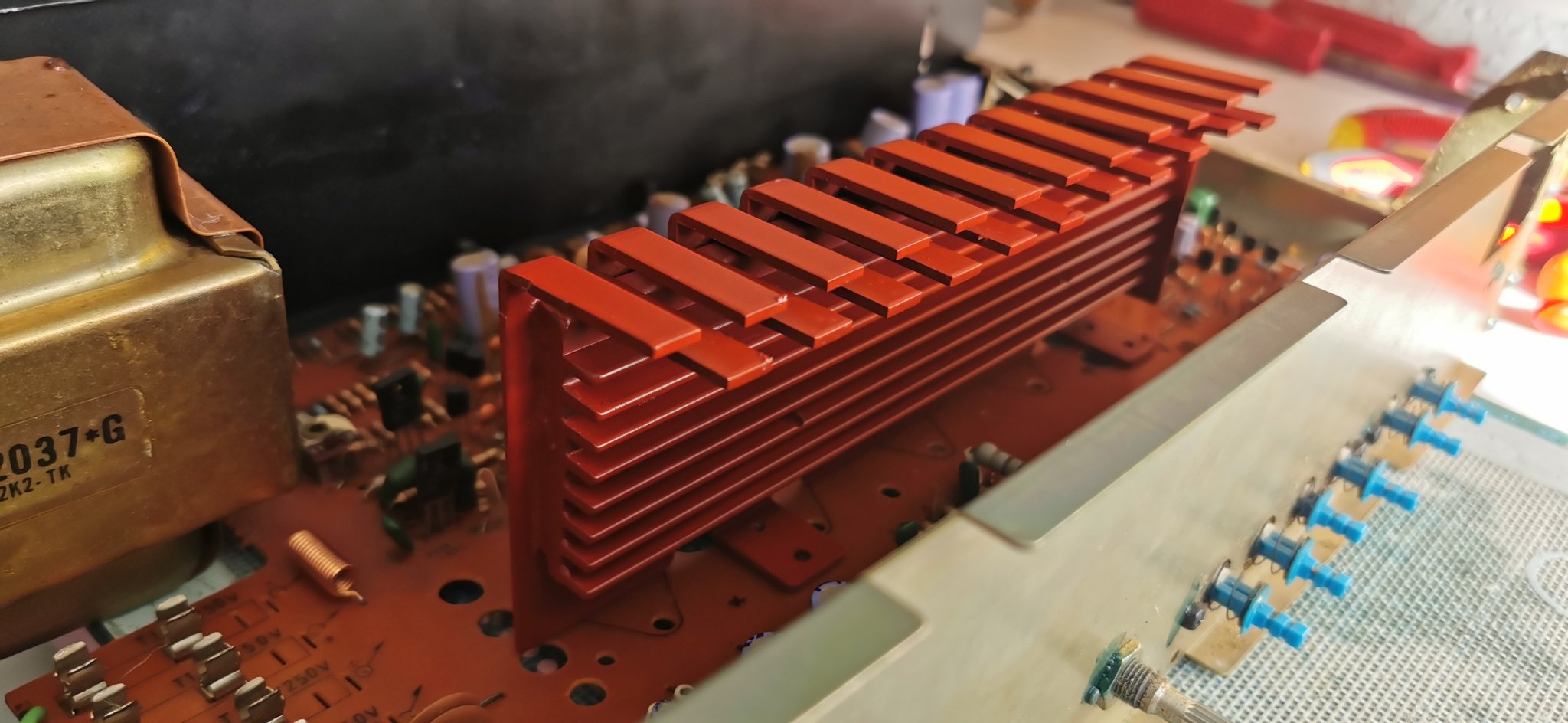

How about leaving the heatsink in the original orientation and mounting the TO-247's in TO-3 sockets the usual way?

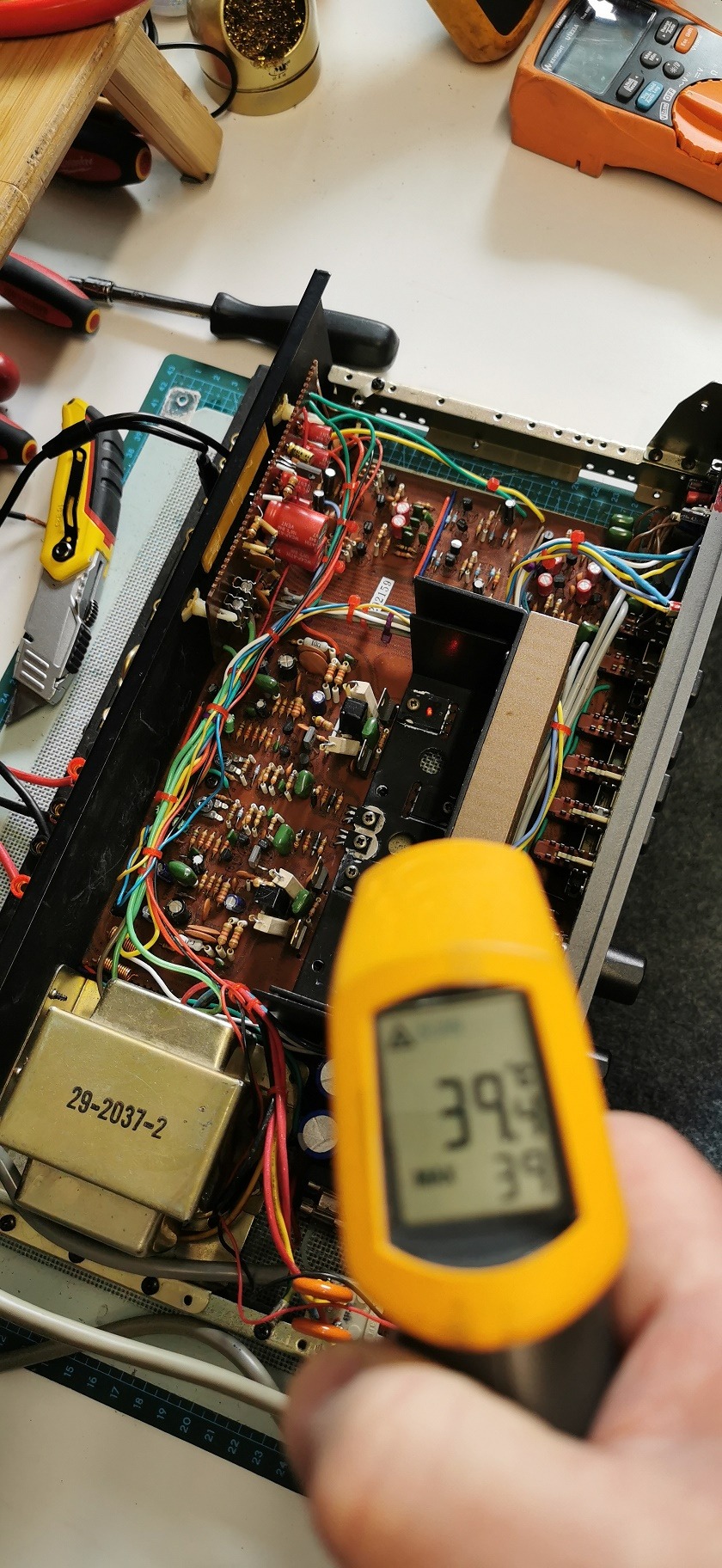

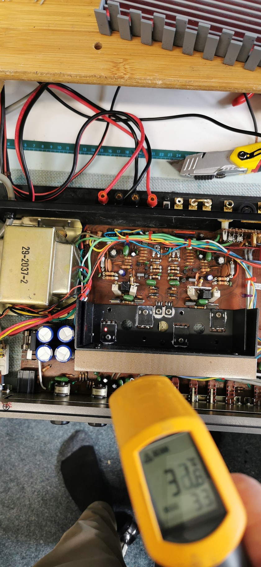

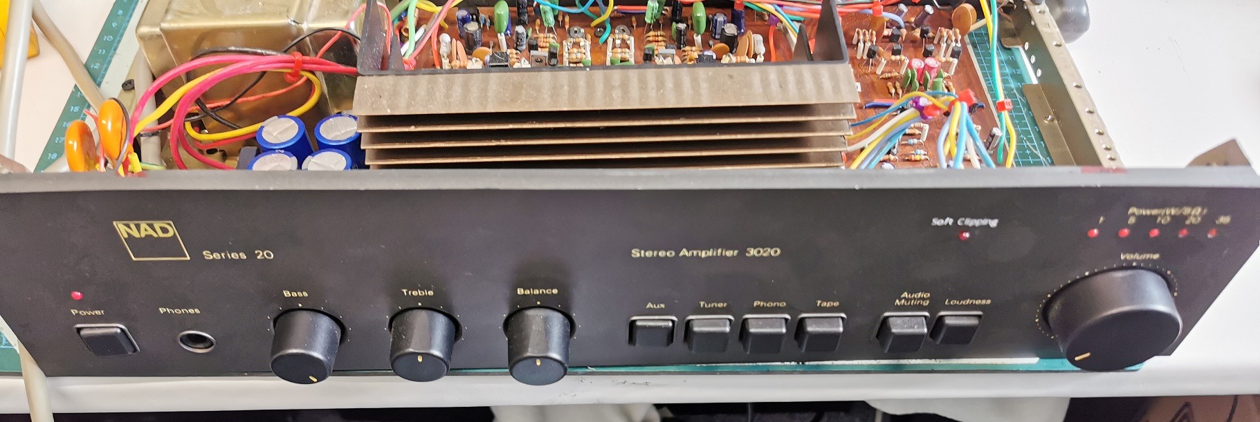

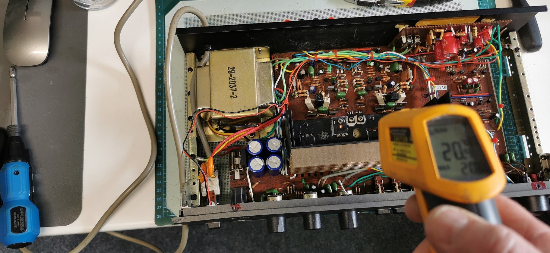

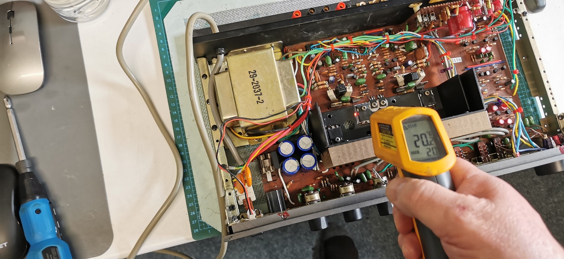

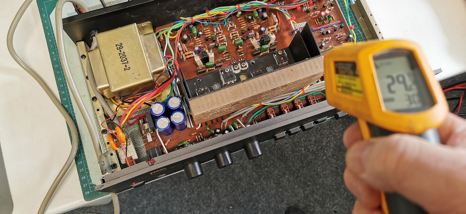

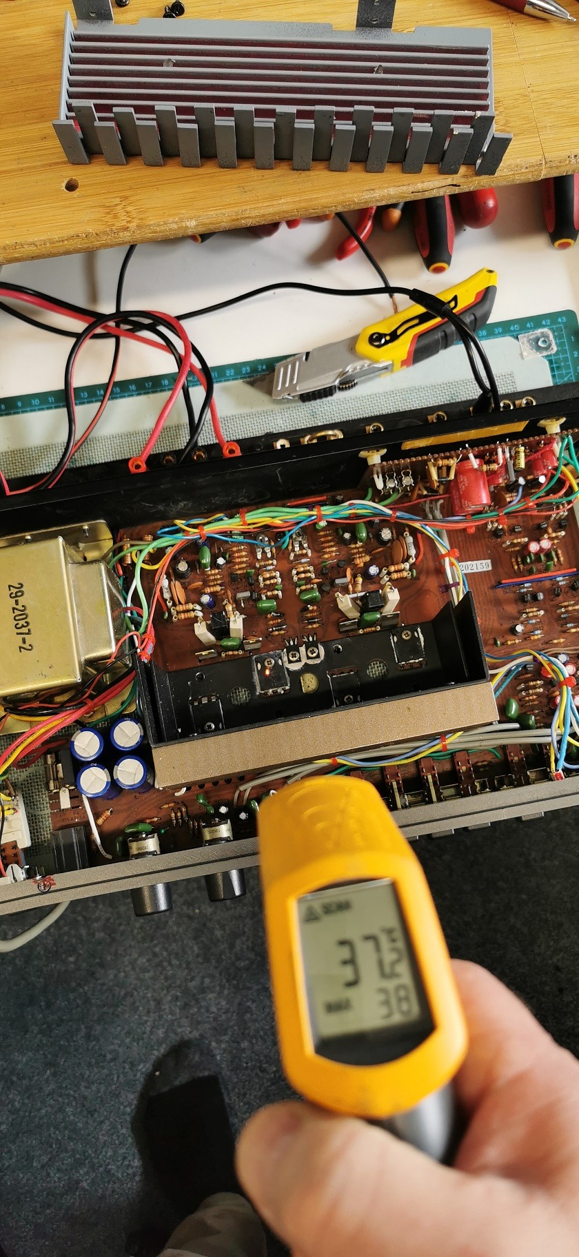

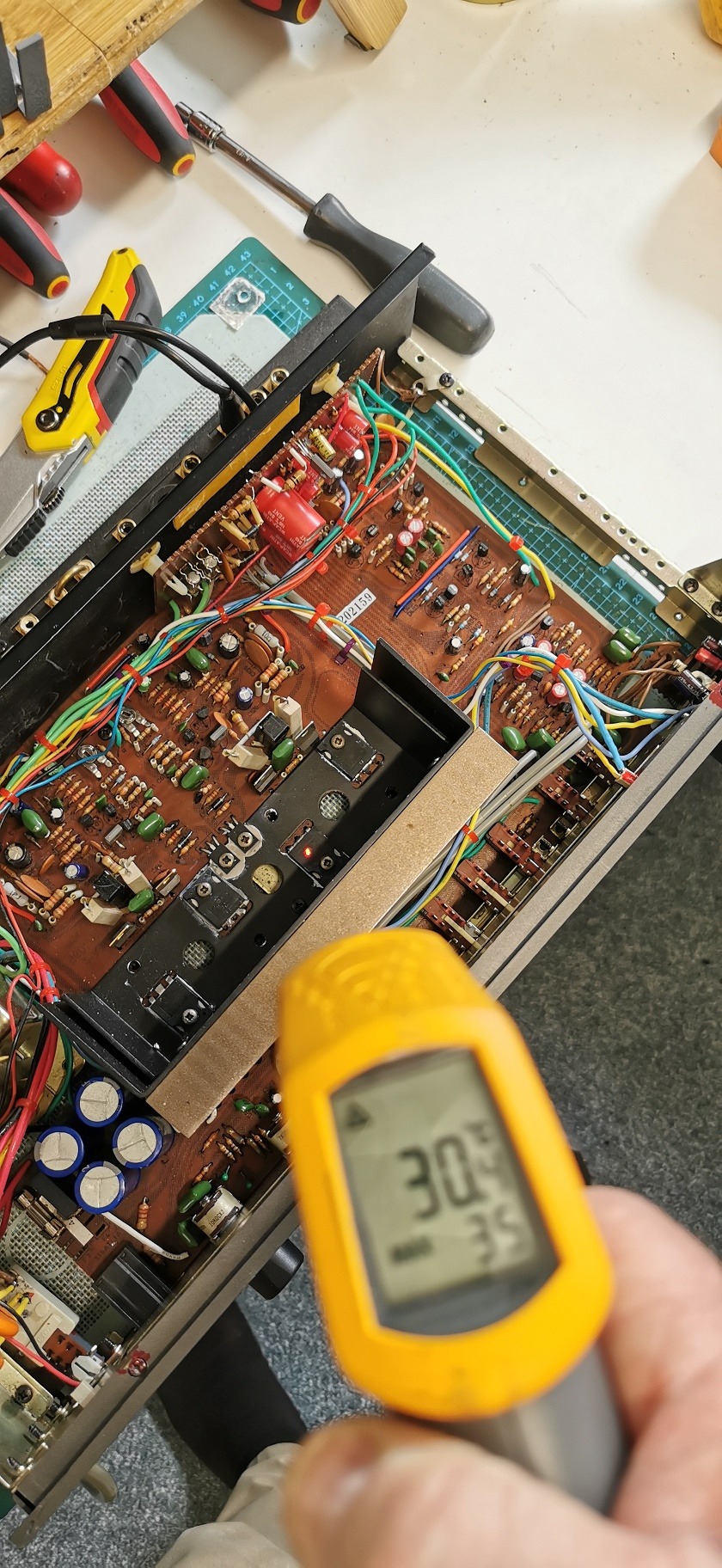

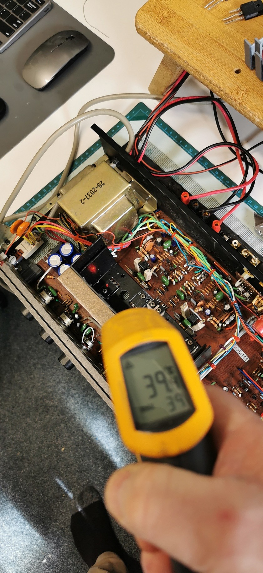

@Phloodpants I have done one already as you suggested, I just wanted to try them vertical this time to see how it looks

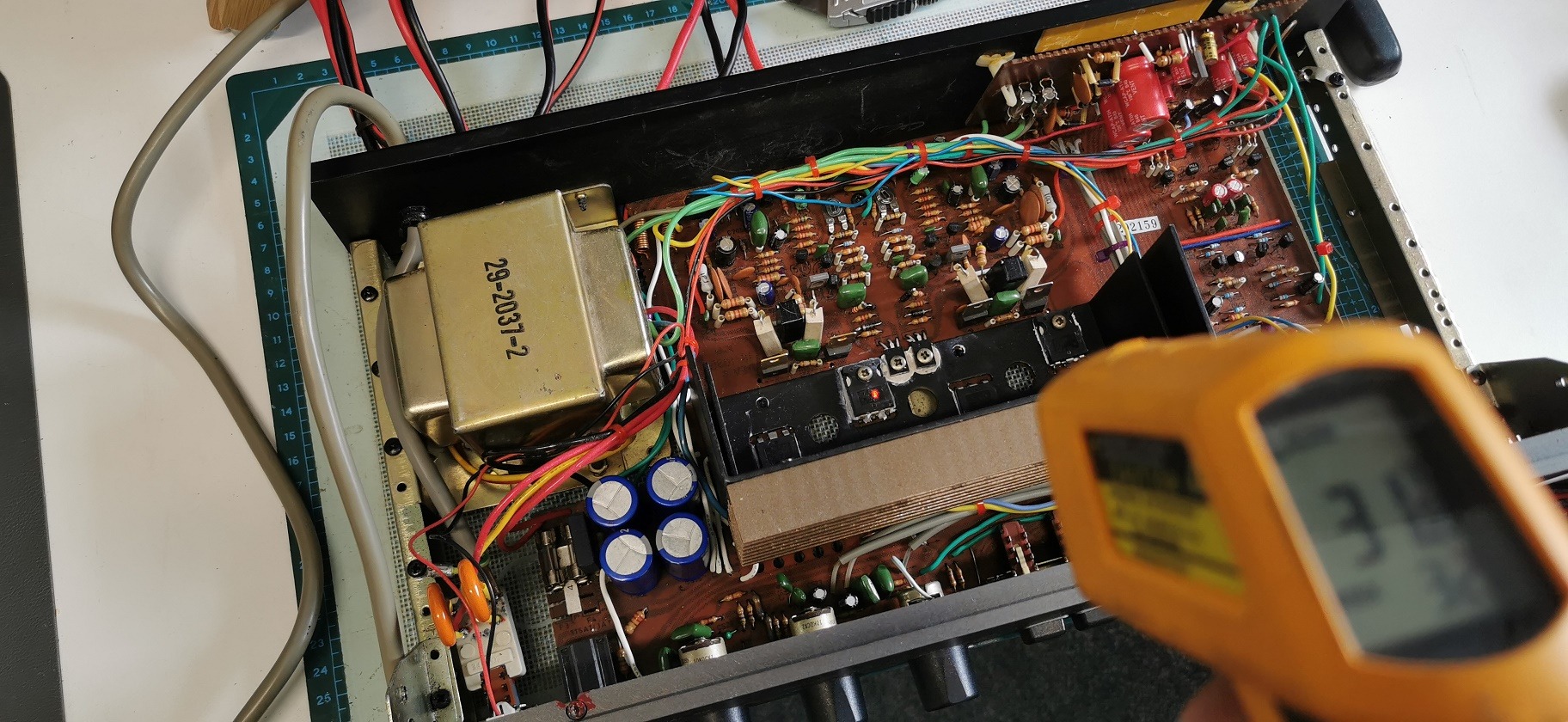

ok so here we are

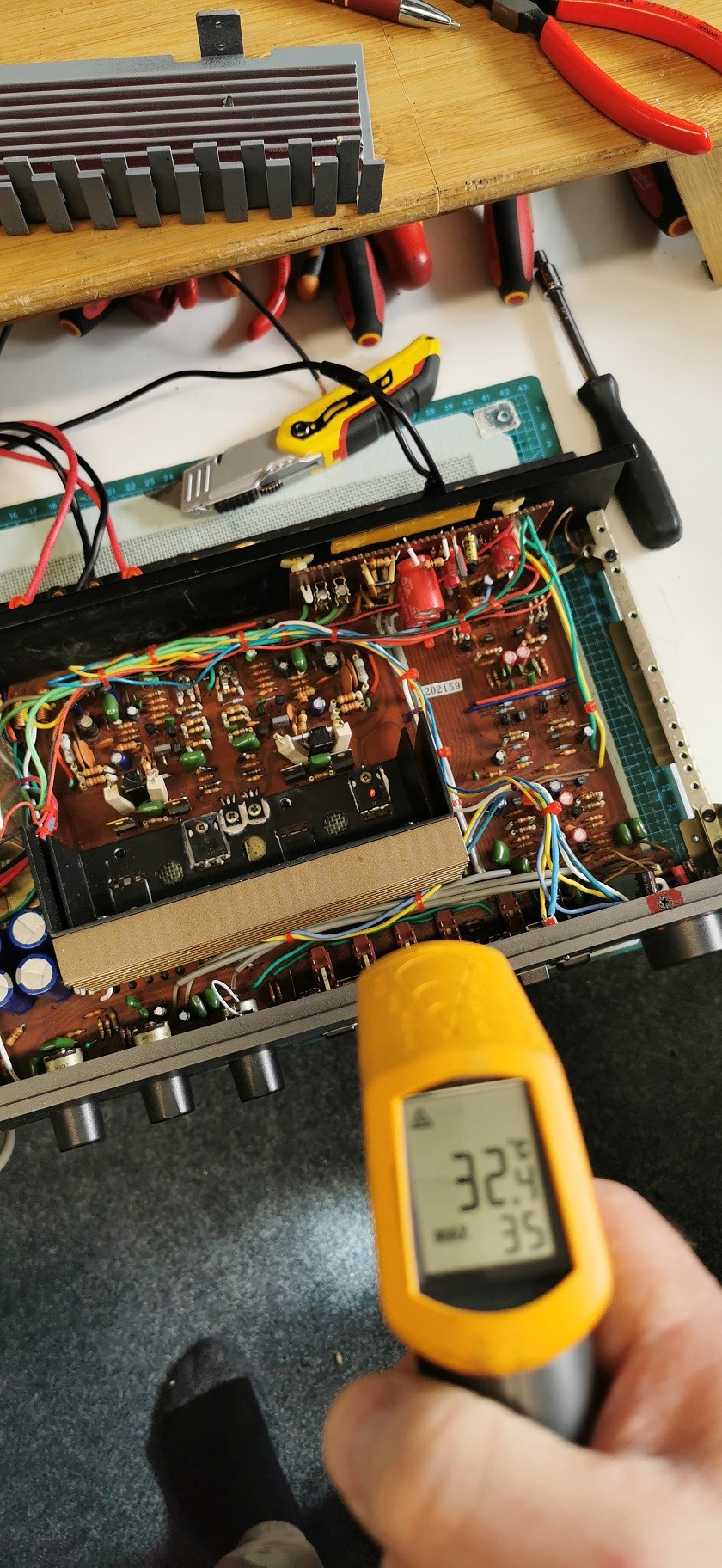

@Mooly i used the amp we converted with the soft clip light and TIP35 transistors
as you can see therte is very little difference,so the pads must work
appologies for the sock veiw and a bit blurred but i had to hold camera and infra thermal at the same time

Wouldn’t it just be easier/better to form the leads such that you don’t need a spacer?Be interesting to test though. If it doesn't work I'll make up some aluminium or copper spacers
What's being compared here? Two kinds of sil-pads and mica? Are the 3mm thick pads involved here somehow?
5C on top of the transistor is actually a pretty big difference and that gulf will widen with more power applied.

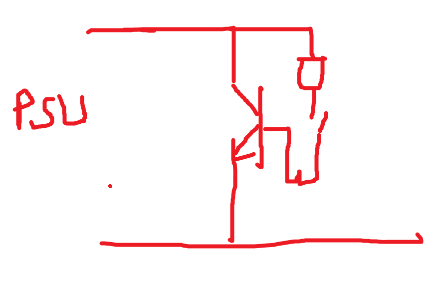

You can test how good it is with any old power transistor and a power supply and heatsink. Set a voltage in the 20 to 30 volt region from a current limited bench supply (set the limit to say 1 amp) and choose a resistor to give about 1 amp current when connected. The transistor will heat up super rapidly.
