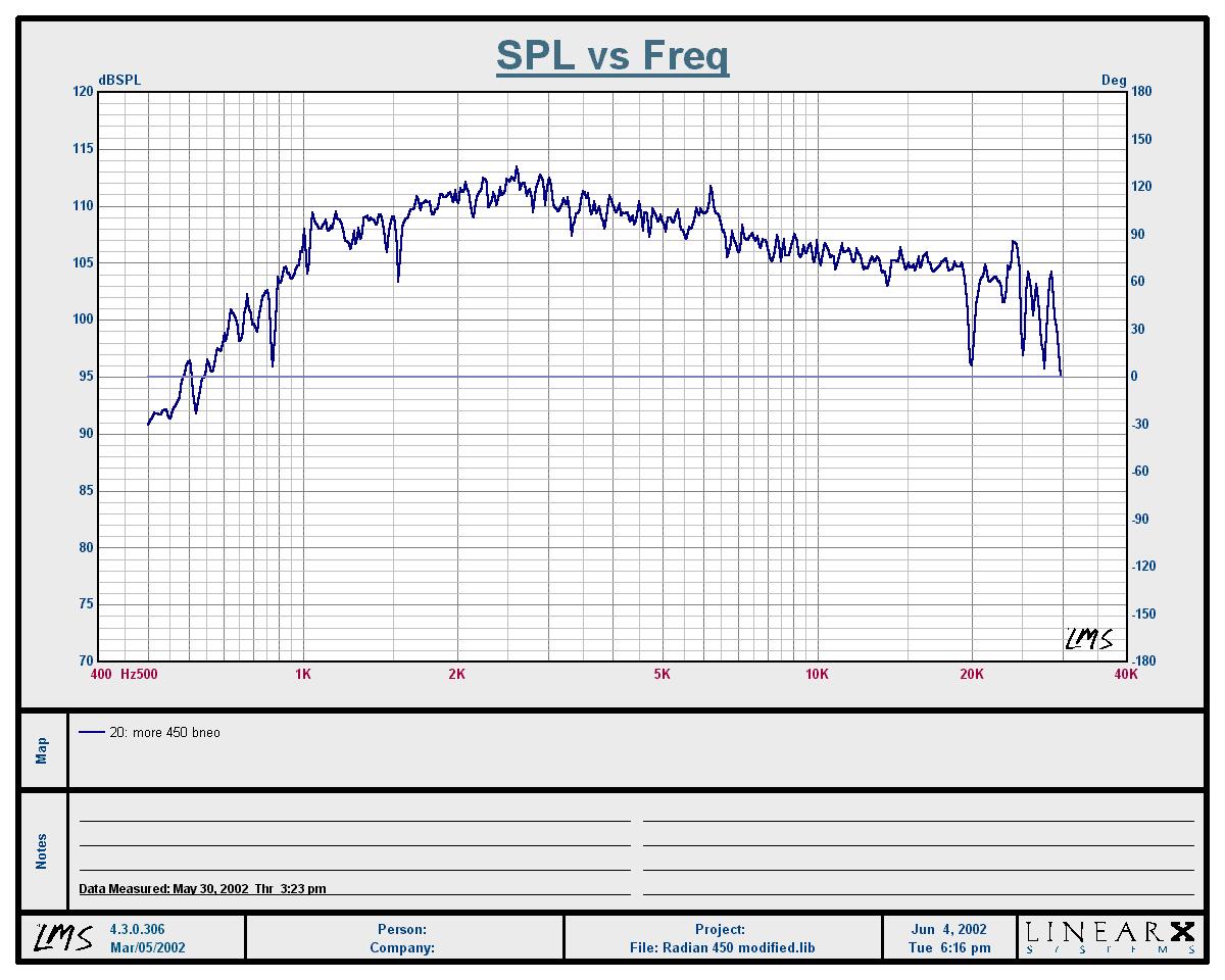

Dear all and in particular panomaniac,
I have finally managed to find my measured response for the 'home made' 1" driver with Radian diaphragm.
Please find the graph attached with my best wishes for your kind perusals.🙂

Looks like the alteration to the phase plug worked well!
Do you still have the impulse file to "convert" to CSD?
