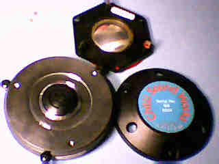

Modified 1" exit Radian 465
Hi All,
I'm unfortunately no David Bailey and my webcam certainly isn't in his league, but here's some jpg's of the above mentioned.
I will post some SPL curves later this week when I get them measured with my freshly refurbished HP35665A DSA - Dynamic Signal Analyser, using a B&K 4133 mic on B&K 2606 pre Amp.
Please observe the label at the back cap represents this as a integrated device part on a proprietary Horn flare of a Pro Audio loudspeaker product offering from CSW - Chilli Sound Works.
I work at this company as an effort to try and earn a keeping and hope it will be OK to ask to please keep this in mind.
Best regards
a1greatdane

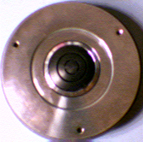

1" exit Radian 465 structure close up with 3 slit phase plug
and finally close up of structure with 3 concentric slit plug...
Took some effort to get this compressed down to uploadable format...
Hope this will be good food for thought and will get on to the measures next.
a1greatdane
