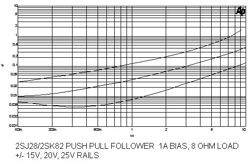

I'm taking at 2SJ28 / 2SK82 amplifier to BAF.
MuuuHahahahahaaaaa...
:cool:
Is this what you are referring to?
These parts definitely seem to like voltage
What does Ciss vs Vds look like?
