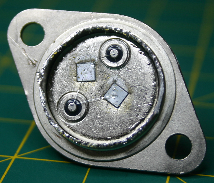

Here's an opened 2SK82. 2 x 4mm dies. $25 for science.
Michael,
Just for my information, is there a reason you can't still use the 2SK82? Is it sealed from oxygen like a tube or something? Or just sealed to keep the delicate wires from damage?
I bet if you could hook it up it would sound more "Open" 🙂
Also, is the 2SK60 only one 4mm die?
Rush
We have two chips in parallel. What they are remains to be proven.
I do not have any physical samples of 2SK60, and the curves I have for them wouldn't quite make a 2SK82 (with two in parallel) although I'd place it in the realm of possibility at least, since they are somewhat close and I have no way of knowing how good my 2SK60 curves really are.
