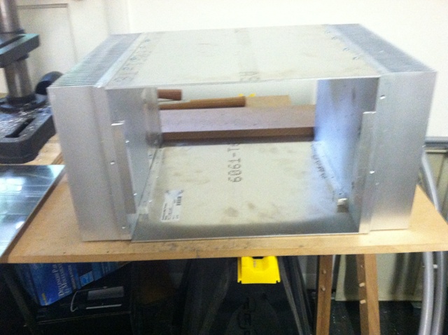

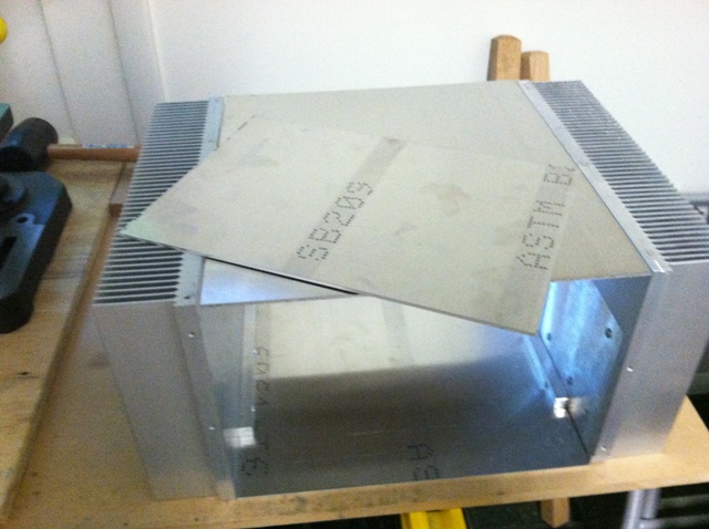

Here's my L'amp CCS so far! 😛

Mike,
Where do you get those black extrusions you used in making your SIT amp case? Not the heat sinks, but the legs between the wood panels. I think they could make a nice equipment rack, if larger extrusions could be found.
Any idea what they are called?
thanks,
Vince
