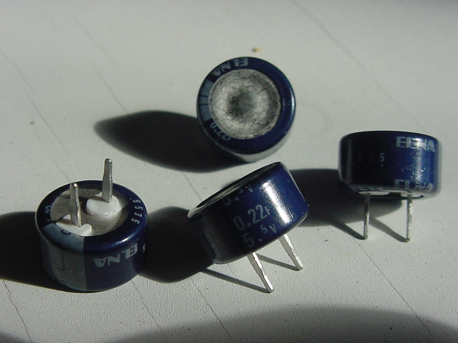

Hi Juanitox,
Thanks for your kind words. The source resistor (3 ohm) in currently bypassed by over 240,000uF. The little button like cap in the picture is an ELNA 0.22F 5.5v capacitor (yes 220,000uF ! ) and together with the two (in line) much larger caps (10,000uf 10v) totals 240,000uf, not including a 100uF and 10uF cap lurking unseen beneath the circuit board .
As the bias voltage rarely exceeds -5V at the selected operating point, I am comfortable with the ELNA's 5.5V rating.
Before switching to the ELNA's , I used two VERY large 100,000uF 50V Connell Dublier caps. I was initially very dubious about using the ELNAs. How could this tiny midget of a cap provide the huge capacitance needed even at 5.5V ?
Boy was I wrong ! Not only did I not notice any change in gain, the amp sounded smoother and the sound stage depth and width stayed the same, when I replaced the Connell Dubliers with the ELNAs.
I have attached a picture of the little ELNAs so you can have a better look.
