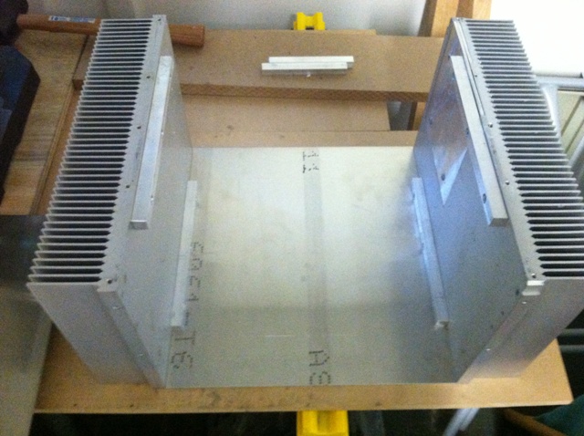

'sinks are overkill , but situating those L's on upper portion is nono
except in case that you'll turn them upside down , in use
and - proper L's are at least 4mm thick

No one said anything about Kasumi's horizontally mounted heat sinks. I think that's worse. No offense Kasumi.
Those are the heat sinks I had on-hand. The other I have are too small.
The way things go today, this amp will evolve into something else or bigger.
I'm aware the L bracket is not in a good position, but, I'm not sure the position of the bracket is a problem and it's a large heat sink. It's effectively 1/3 of the way down on the HS. The way the heat sinks were sold to me, was with 2 aluminum plates to fill a routed hole on the face of the heat sink. The plates are stacked. I didn't trust mounting any transistor on them. This sort of made it a problem as to how I was going to mount the FETs and work on them at the same time.
The L bracket is 3mm, and using very good conductive paste. I was told once that dissipation was about surface area and not thickness of a heat sink. If anything, the bracket should be longer. My Mini-A survived for years playing in humid, +90 degree Fahrenheit summers. L bracket is in the same manner as this new amp. Mini-A runs at 2 amps per channel.

I think that the main thing that ZM wanted to warn you about is that heat tends to go upwards and if you mount your SITs so high up the heatsink the heat won't spread evenly, and the lower parts of the heatsink will be much cooler i.e. unused and your SITs will needlessly be exposed to much higher temperature. Lowering the position of L-profiles to about 2-3 inches above the bottom would put your SITs in much more comfortable temperature zone.

Thanks Juma. I know, but I can't move the L bracket on one of the heat sinks. See pic attached.
On the right heat sink back corner is a set of stacked plates that are not physically flush with the face of the heat sink. It's imperfect. The plates are more or less cometic.
If the L bracket is moved down, the same problem exists because of the plates, except it's half the heat sink in the lateral direction that's not being utilized.
This heat sink was meant for an F5, where there would be more space to mount TO-247 directly on he heat sinks, without the aid of the L bracket.
If I mount the L bracket vertically, that's not good either. Best thing to do is flip the heat sinks and have the bracket be lower, but does that make sense?
Heat distribution is still uneven. It's still not in the middle of the heat sink.

Yes, this way or that way there's always something that needs extra care or attention. Never you mind, it won't kill the SITs for sure. It's just that nagging feeling that it could have been made a bit better... 😀

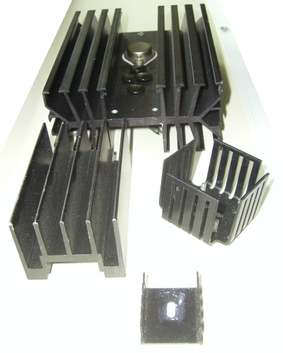

This makes me wonder if my smaller heat sinks, already drilled for TO-03, would have worked. Will take picture and post it. I have 4 of them. They are maybe 5x5x3 inches in size, but have fins in all directions like Mike's photo in L'amp CCS article. Although on visual inspection, not as heavy an extrusion as Mike's heat sink.
Do you have a photo of your amp here?
Found a picture on the web. the one in the back. Not exact, but close. Mine is more like a cube.

this is mine..
That's it?!?!?! That's all? 😱 Tell me they go into the case, please!
Had no idea it could be that small!! The extra heat sink I have are at least that big, maybe bigger.
Also have 8 heat sinks that are bigger than that one, if I take apart my Zen v1. I used the transfo from the Zen 1. It ran at 2 amps.
