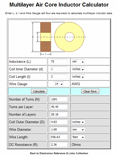

I calculated the inductors with with "Air Core Inductor Designer/Calculator", trying to get the most mH for copper weight, with minimum DC resistance. I did the cores myself and had the chokes wound by a lady who runs a transformer winding shop. (Still a lot less expensive than to get the Hammonds shipped and pay taxes on them.)
Data are approximately 75 mH for 2.6 Ohms DC resistance. At first sight this seems to be very low inductance for fullrange use. However comparison with a 150mH choke does not make a big difference for my ears..

The Multilayer Air Core calculator from Pronine is more convenient, but the results are the same..View attachment 537119

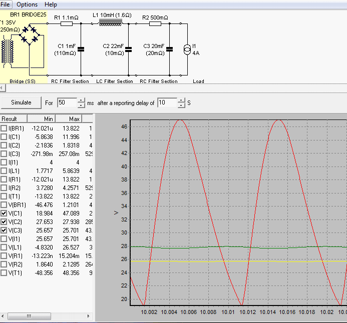

(i use a quasi choke input power supply where i can tune the voltage through C1 c.f picture)
