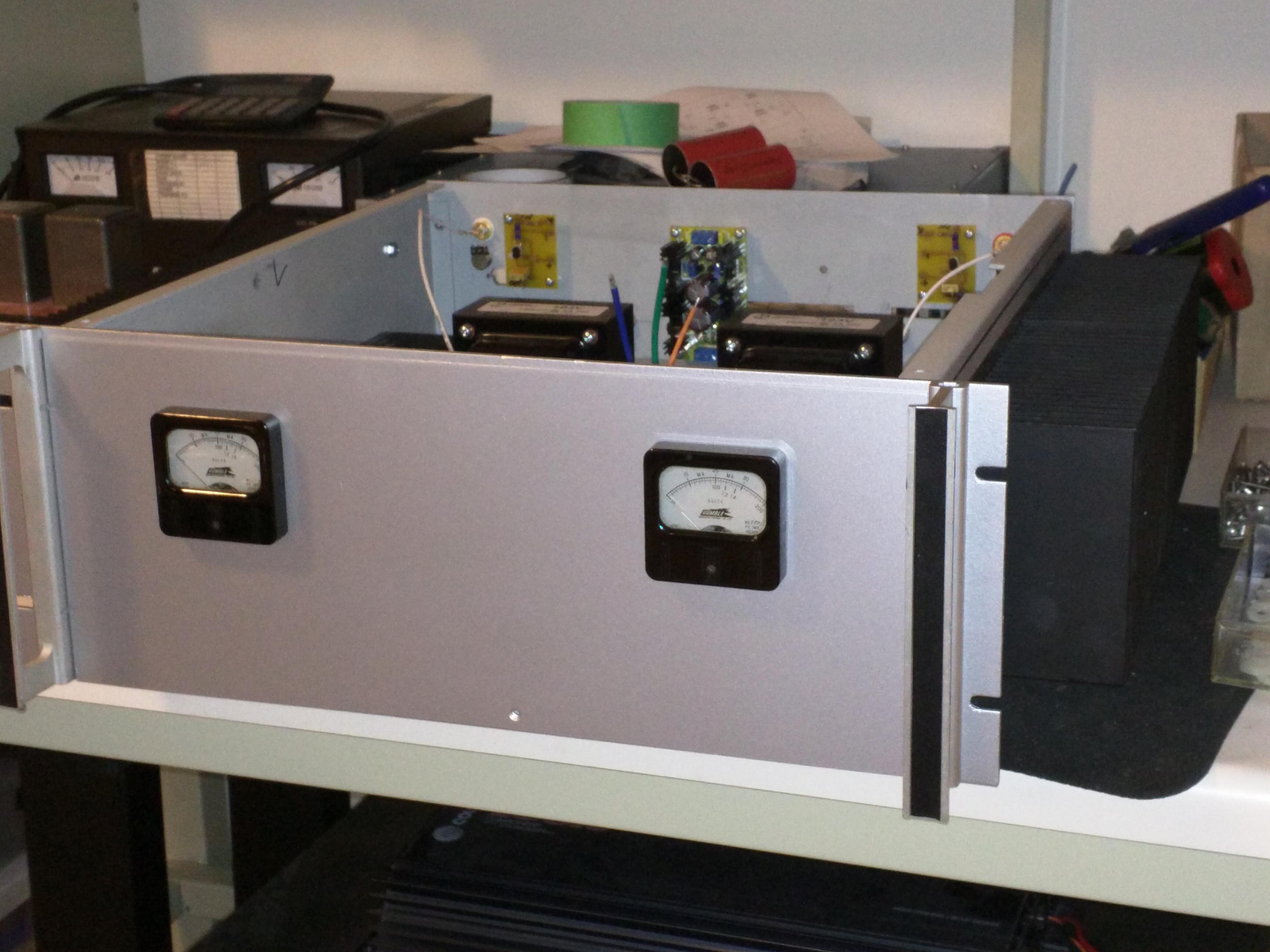

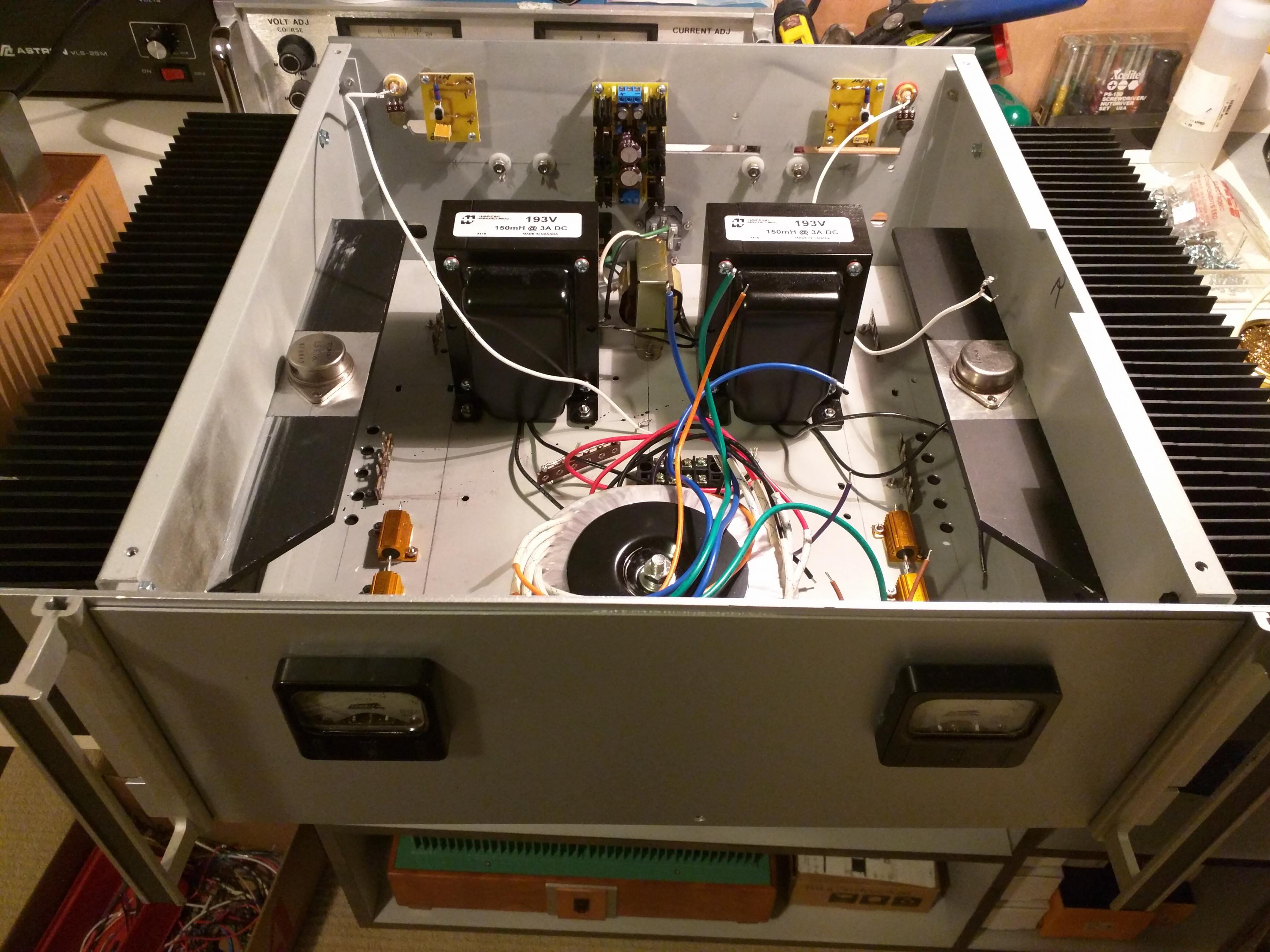

What I've found to work for a given pair of reasonably matched SITs is to use a 50 watt rheostat to dial in the best value for the source resistor then I order the 50 watters as needed to make that value. There is thermal drift on my rheostat though so I have to measure it "hot".
I meant to say side effect from "adjustable cathode bias" along with WE conection. The value of the additional resistor and pot are yet to determined, probably around 500ohm to 2k?
the bracket L in in direct contact with heatsink ??
or the side are in between![]()
They're direct connect with lots of compound in between.
