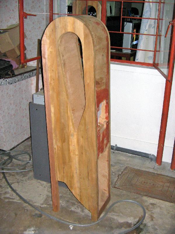

I'd build a pair of hedlund, using 3mm plywood laminate.
Damping is never a problem, just keep add layers of ply until you are happy with the good old trusty "knocking test". mine is 8 layers.
