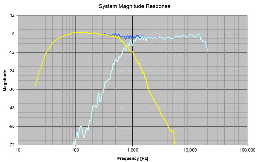

Well, after a good day's work I have managed to get LADSPA filters working in ACD. I've decided to name the new tools "ACD-L" so that I can distinguish it from the original version. ACD-L fully supports the ACDf and mTAP LADSPA plugins that I wrote for doing crossovers in software under linux. I no longer have a use for the original "minDSP" version, but I will keep it around for others to use.
Once the crossover is developed it's very easy to implement it. ACD-L generates the text string that describes all of the LADSPA filters for ecasound. Copy the test out of the ACD-L tool and paste it into a text file on the machine that is running ecasound. Configure ecasound to read and use the filters in the text file (you do this only once, really). That's it.
As an example of what you can do with the tools, attached is ACD-L's system response plot for the MTM that I am bringing to Burning Amp. I used it as a test bed to verify that everything in ACD-L was working correctly, so I took the opportunity to make a few changes to the previous version of the crossover.

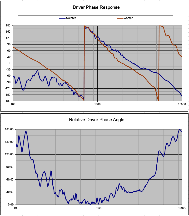

Now that the LADSPA based crossover design tools are working it's nice to be back to loudspeaker/crossover design for a change!
Meant to post this with the MTM frequency response, above - it's the phase alignment of the drivers in the system - please see the attached plot.
