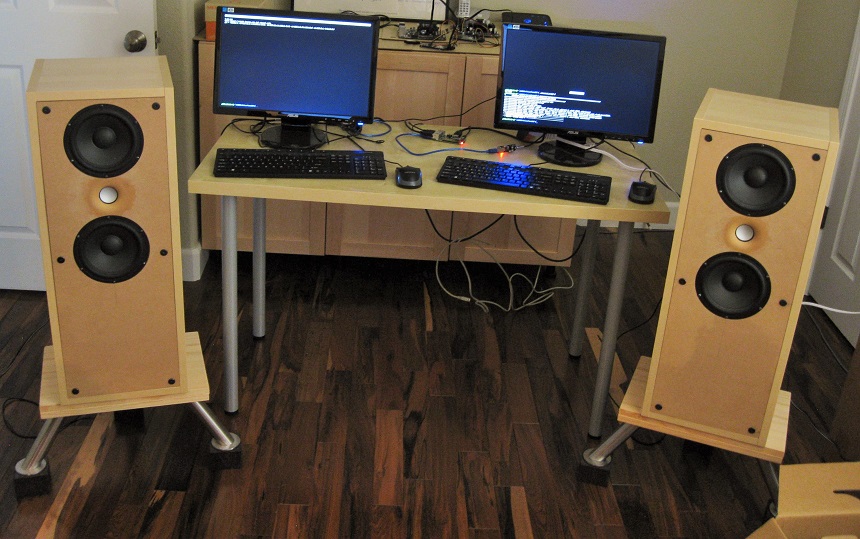

Attached is a pic of my current LADSPA/ecasound loudspeaker test bed using a pair of Raspberry Pis (one per speaker). The Pis are receiving streaming audio over wireless ethernet, processing it with ecasound to implement the crossover filters, and then outputting to the active MTM speakers. I'm listening to some music and all is well.
Although I am still ironing out some final details for headless operation, I am planning to bring these speakers to Burning Amp to demo the systems to anyone who wants to drop by.

After ironing out some bugs in the startup scripts so that this can all run headless I am pretty satisfied with the result. Best result is had when the Pis are left on all the time so that kernel time is well sync'd. If there are gliches or delay becomes apparent I can stop and restart streaming at the server or the client, or do the same with ecasound on the client, and often this results in a re-sync-ing of everything. I assume issues arise as the clock is being adjusted aggressively by NTP after restart(s) and while playback is occurring. Just a guess on that...
Anyway, just so I had another DAC to compare to the $10 ones that I have been using, I decided to exchange those for a pair of minDSP miniSTREAMERs (USB SPDIF I/O) connected to a couple of DACs that I reviewed on this site a while back (see: http://www.diyaudio.com/forums/digi...dif-input-24-96-dac-only-40-measurements.html). So far this setup is playing away, with only a very minor hitch at the beginning. What was nice is that to make this change I only needed to make a single change to the ecasound output specifier, from
Code:
-o:alsa,front:DAC
to
Code:
-o:alsa,front:miniSTREAMER
So it should be easy to "roll" DACs to see which you like best, etc.
I have written some shell scripts that I can use to start and stop vlc (the streaming client/player). These run on startup. For instance, if I want to stream to the speakers from another machine I can SSH to each Pi, supply the new server IP address, and then re-start the vlc client. Seems to be working smoothly now. I will continue to test over the next days and weeks in the background. It's set up in my office so I can do other things while listening to the audio playback.

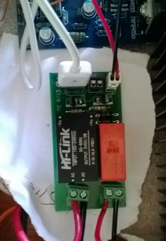

Hi Charlie,
I just built a few of these boards... if you're curious (I've got two spare bare boards). They contain a 5v supply (always on) and a 15A/250V bistable relay along with two driver transistors. It takes two GPIO pins from my RPI and turns power on and off. The upper-left connector is a stock USB female pointing up (to save space).
Hi Charlie,
I still need to put something like this together... am considering using GPIO pins when the Pi is available, but may make a board that can also be used along with my audio-output-driven, LADSPA based signaling since I am planning to use a small computer that doesn't have something like a GPIO pin available.
I will have to roll my own boards because I want to use up some of my relay stock... thanks for offering, though!
