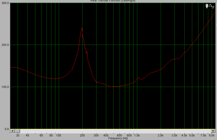

Horn theory alone, doesn’t justify the Turbo low freq. efficiency. Try to apply the formulas, if you know them, and see what I mean.
Also try to remove the front camera volume (band-pass resonator) and all the efficiency is gone!
Also analyse the impedance curve: Nothing to do with a horn, everything to do with a pass-band.

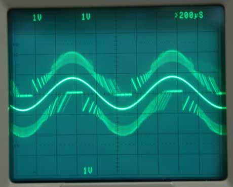

Take a look at the attached picture. These junk it is what they are injecting directly on the amplifier rails.
Scope probes are 10x.
Is that ugly thing that you appreciate as good practical engineering? How should this amplifier sound with this kind of supply?
This waveform that you call junk is carefully shaped to exhibit exactly the same average value as the own audio signal, so it does not produce any distortion, it only adds carrier residuals to the output, 630Khz (or whatever) and its harmonics. This is the trick. You are telling us that you don't understand switching mode electronics at all, and as a result, you just hate it, you call it junk and you discard it (typical human behaviour).
