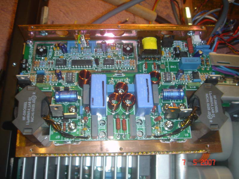

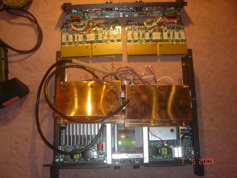

darkfenriz said:Is the SMPS modulated with audio signal?
P.S.
Or is it SMPS with two class D amps on secondary working as supply for main linear amplifier??
Study the big picture, it speaks for itself...
Eva said:
Yes, the SMPS PCB layout almost screams "I'm single ended, not push pull", but it's hard to believe that a flyback of that size could produce 10KW during anything but short intervals.
Also, the 614Khz figure is hard to believe considering the parasitistic inductance of the TO-247 switches and diodes and the gate drive requirements...
Seeing that kind of stuff motivates me anyway 😀😀😀
Evita, flyback setup uses 3 parallel connected high voltage 1200V IGBTs and a custom made RM24 Core....and SW frequency is 75Khz...
For this kind of big power, I would use a FullBridge for sure...
The Rail tracking switch is actually IRFP260N driven by TC4420 Mos Driver with floating supply.....The logic is optocoupled with 6N137....to gate drivers....at idle the max Vce across output devices is only +/-7.5VDC, The input to rail Tracking sensing is taken from VAS to match the delay and the Tracking isn't tightly followed, If a full sinewave signal of 15Khz or greater is sensed at input, the amp is muted....
I think Class-D is much more promising than the Class-TD rail Tracking amps...Much less complex...😉

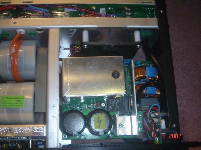

Hi, EVA,
The SMPS, even it is very powerfull, is a flyback type, with 1 secondary with 1 rectifying diode for each rail. Do you have a tought why they do this and not imply full bridge rectification?

A friend bought LabGruppen FP6400 power amp. These amps sounds different than so called Hi-End amps. What makes them sound different? (Hi-End amps sound better from his POV). My friend's problem is that he could not find any Hi-End amp that has big enough rating. Too late The owner just cut the main 220V cable head plug of this brand new amp (not even 1 day arrived in his house) just to get these 3 modules out of the amp. Anyone got suggestion what to do? Since this amp is already disassembled (Darkfenriz tells me too late ). Yes, LM4562's are ready to be plugged. But what can be done with the main CCT structure? I often feel that changing caps and opamps are giving better sound, but not in a significant way.
This so- called friend is either deaf or he has very inefficient speaker. Did you tell him what active crossover can do for him? Activating the speakers will give him at least 3dB more power if the amp is only driving the bass and the possibility of dedicated amplifier for each driver in the system! Is he listening to music or is he only putting the amplifiers on the bench for sinusoidal test signal? Which pro drivers is this so-called friend using? And I’ll agree - that changing an opamp or a cap won’t do much!
Eva:

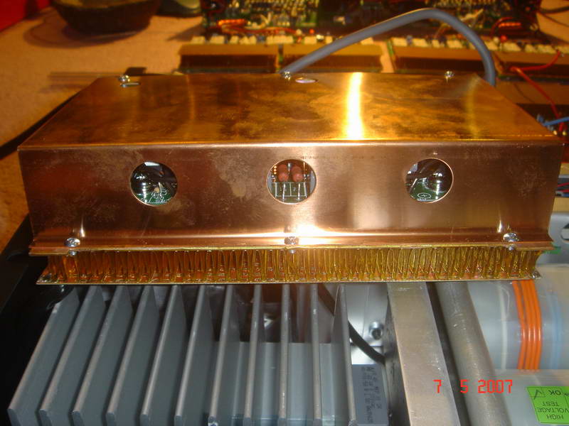

I'm curious about the heatsink arrangement. Could you post more detailed pictures?
The heatsink system is the way to dissipate a lot of power in light weight and compact fashion. I even think they have a patent – for what it’s worth!

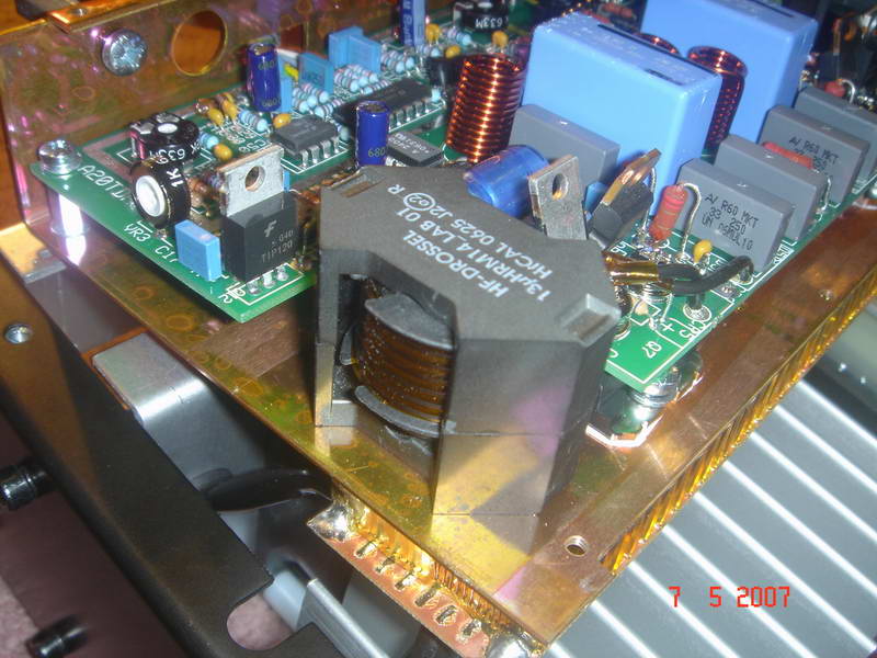

Let me clarify some details about these amplifiers... I have repaired a few and I know it VERY well.
First the power supply:
It is a flyback working slightly above 20KHz and its is why it needs a big transformer.
The IGBTs are heavily current limited each cycle. Otherwise it doesn’t sustain the colossal primary current without immediate failure.
The supply is regulated and in the case of the picture posted by Workhorse could sustain only one channel at specified full power 1kHz-4ohm for one or two seconds.
The only advantage I could see in this power supply is that is naturally short circuit proof. I mean: in the short circuit the only components in stress are the output rectifiers, electrolytics and secondary wires. This is inherent to all flyback psu.
About the dissipator:
It is simply an automobile motor thermal radiator. I have seen it for the first time in my car, and second time in an old H/H British amplifier.
About the 15KHz protection:
The amplifier mutes at this frequencies simply because the tracking power supply doesn’t follows the signal… it is not fast enough.( mute or die)
About the modifications in the circuit for better sounding:
No way! The HF noise on regulated rails implies that the amplifier must have a high power supply rejection noise factor. The way they have implemented it, it is not good practice for Hi-Fi. Regular amplifiers will be instable here.
About the patents:
This is the patent: http://www.pat2pdf.org/patents/pat5200711.pdf but the implementation is more like this:
http://www.diyaudio.com/forums/attachment.php?s=&postid=1200773&stamp=1178281024
But the NFB scheme is more like this: http://www.pat2pdf.org/patents/pat4507619.pdf who in my humble opinion is the first UCD patent from Philips.( note the “23” in the schema”).
For other patents, take a look here:
http://www.diyaudio.com/forums/showthread.php?postid=980363#post980363
About the power announced (10Kw)
Let me laugh… The size of buck converter coils on the picture, tells everything. The output power is highly policed. No chance on big concert subbass boxes compared with “traditional monsters” like Crown VZ5000 (near some announced per channel power).
About the power chord for 10KW amplifier: 16amp regular European home appliance.😀 😀 😀 😀 😀

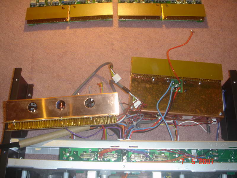

Thanks all for the input. I'm not the owner, I just follow the owner's will. If you are a car mechanic and someone you know ask you to hit a baseball stick into front glass of his brand new McLaren Mercedes Benz coming out from the dealer (and he will not sue you) will you do that? And you got paid for doing that 😀
I ended up modifying this amp. The sound now is better (to the owner). He likes modified FP6400 more than his FMAcoustics F50 pairs. I won't tell you what I done exactly, I modify the front end, a bit here, a bit there, because if someday this amp is producing smoke instead of sound, Darkfenriz, Mikeks, EVA, RobertGS, PhaseAccurate all will be laughing at me.
This is when the amp is disassembled. Note that the power cord is cut with scissors by the owner, not me.
