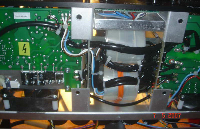

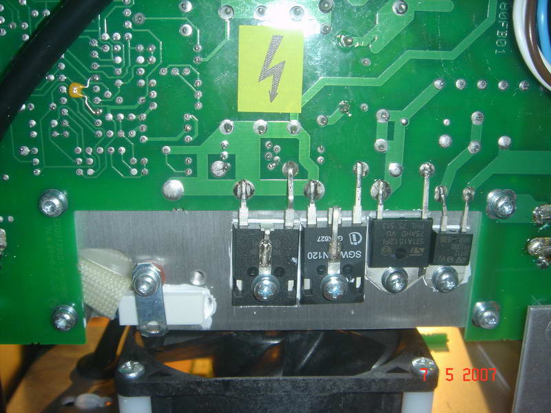

See that 15A TO220 triac on the last picture?
Is a crowbar protection from output to ground…
Strongly recommend that you found another kind of protection.
In case of catastrophic failure, the loudspeakers and triac will probably burn…

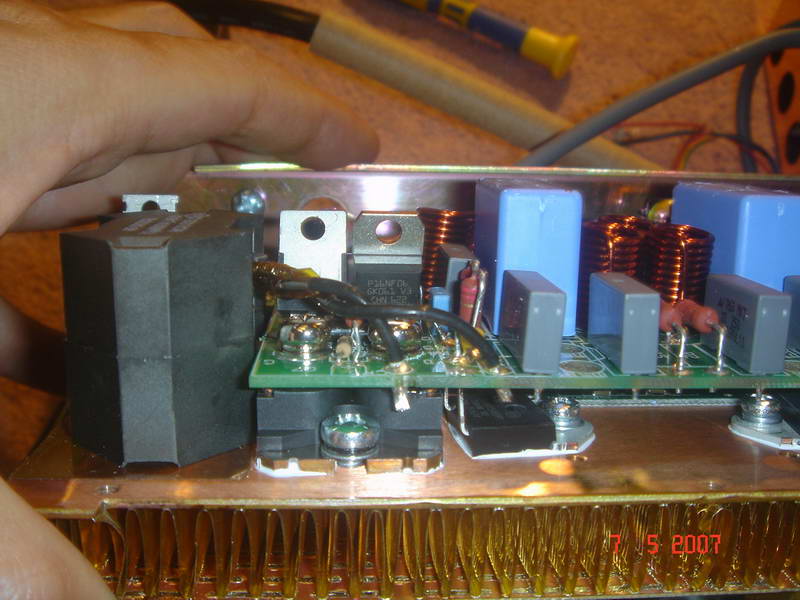

Flyback SMPS works at 27kHz according to LAB2000 sch. In the new fP+ series it’s properly higher as workhorse says – I only own one and have seen it on the factory. I will ask again are these amplifier made for music which has crest factor of around 10-12dB or a bench test with sinusoidal test signal?
Exactly – no current limiter can be seen from the amplifiers point of view!

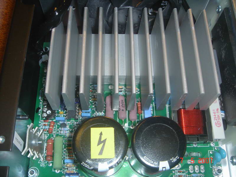

In pro amps enemy number one is heat – this is a good way of dissipating the heat do you agree?

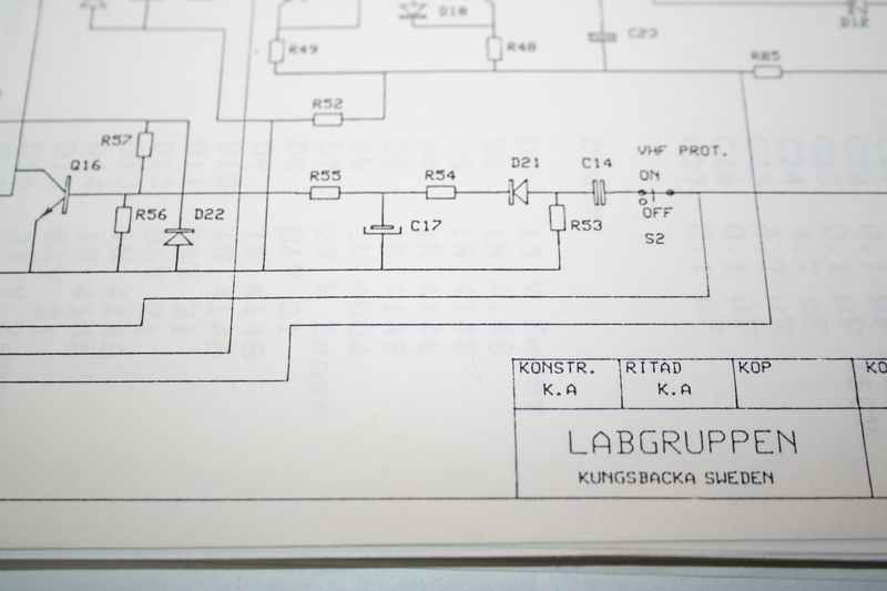

Simply look at the picture blue sw and look at sch. I will ask again who needs 3kW above 15kHz or even 1kW? This feature is implemented in all of their amps.
When I look at the LAB2000 sch it looks exactly like that - just simplified. I know the new fP+ series has self-osc circuit at the high and low side class D stages a la UcD instead of the fix 830kHz osc in fP6400.

Don’t you worry I have been living with this crowbar circuit since 1987 in 100’s of amps.
Would you replace it with a relay? How fast do you think it reacts?
It is a flyback working slightly above 20KHz and its is why it needs a big transformer.The IGBTs are heavily current limited each cycle. Otherwise it doesn’t sustain the colossal primary current without immediate failure.The supply is regulated and in the case of the picture posted by Workhorse could sustain only one channel at specified full power 1kHz-4ohm for one or two seconds.
The only advantage I could see in this power supply is that is naturally short circuit proof. I mean: in the short circuit the only components in stress are the output rectifiers, electrolytics and secondary wires. This is inherent to all flyback psu.

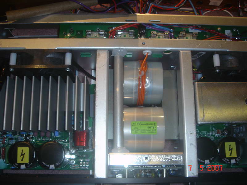

About the dissipator:It is simply an automobile motor thermal radiator. I have seen it for the first time in my car, and second time in an old H/H British amplifier.
About the 15KHz protection: The amplifier mutes at this frequencies simply because the tracking power supply doesn’t follows the signal… it is not fast enough.( mute or die)

Let me laugh… The size of buck converter coils on the picture, tells everything. The output power is highly policed. No chance on big concert subbass boxes compared with “traditional monsters” like Crown VZ5000 (near some announced per channel power).

The problem with this Crowbar circuit is not their reaction speed, but their destruction speed… how could a 15A device stop all the accumulated energy on those big capacitors? Do you know the price of concert loudspeakers?

Well… the “Intercooler Cooling System” stuff …I cannot forget that is simply like my car heat radiator. Only difference is that my car sustains full power for more than 2 seconds without thermal protect!

There is nothing wrong with the triac crowbar approach as long as the triac and the related PCB traces are sized to exhibit a somewhat higher i^2t product than the rail fuses. A short to a 150V supply rail (4 ohms load) is likely to cause 40A to flow and relay contacts just arc and burn and stick together in these circumstances, relays are only practical for AC or low power (or low voltage) DC applications like the usual 100Wpc hi-fi stuff (or 12V switching in cars).

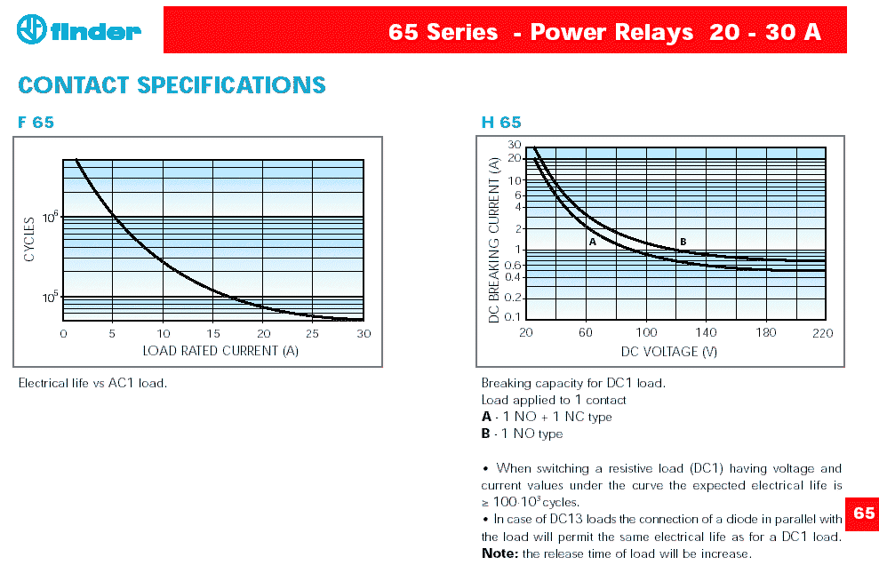

Concerning relay DC blocking performance, the following graph shows what we can expect at best... just 0.8A blocking at 150V from any high quality 30A device 😀😀😀

My own experience with this amplifier crowbar circuit in particular, is burned triacs and burned loudspeakers…
Guess why? They are no means to stop the PSU when you have DC on the output.
So the triac short circuits and the regulated PSU pumps even more current on it until (if) some fuse goes down.
The solution is good practical engineering and you could found it here, for example:
http://www.meyersound.com/pdf/products/legacy/ms-1000a.pdf
Page 68 we have scr1 and scr2 who could disconnect the supply (before capacitors). On Switched PSU is even simpler…
