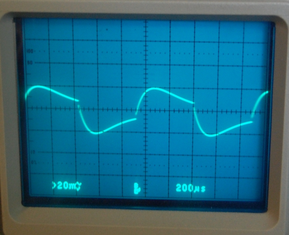

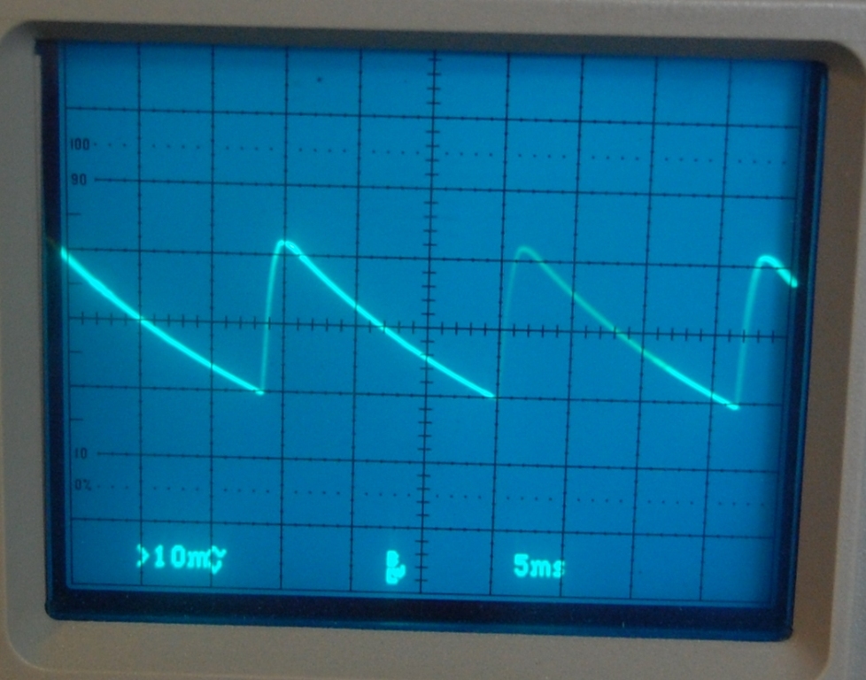

quick question, short the oscilloscope at the sensitivity you have chosen, what do you get on the screen?
I have run 1,000 simulations and yes there are oscillations. Very hard to control. It depends where they come from. If however you are talking about ripple then of course there will be a ripple shape at the output, and you'd need to trace it to the source(s). it may be for example you're drawing too much power out of the transformer, or the filter caps are too low and the base ripple level touches the output level creating kinks... Also the quality/stability of the voltage feeding the base is important. If I remember correctly you are feeding the pass transistors from some rudimentary voltage with no regulation.
Honestly, if this is your best assessment of the circuit and the data I just presented, please save it.
You obviously don't get it.
I'd rather suspect a problem with the voltage regulation loop than your current limiter. It looks like the global loop crossover frequency is as low as about 25 kHz so I'd suspect local oscillation. Perhaps it's the three transistors in the regulation circuit that are acting up in their local loop through the global loop compensation network. It could also be the darlington output stage that dislikes the 10 nF capacitor across the output.
I'd probably redo the voltage loop compensation to go to the base of the "VAS" transistor instead of the LTP input to make sure the regulation circuit itself is well behaved and make the loop crossover frequency a couple of hundred kHz.
It may also be easier to get the thing stable if you use an electrolytic capacitor on the output. A couple of hundred microfarads is often used. As long as the ESR zero (at a couple of tens of kHz) is well below the loop crossover frequency it should be very stable and have low output impedance up to high enough frequencies that it won't matter any more.
BTW, did you set your scope Y amplifier to variable uncalibrated gain on purpose? I've got it's 150 MHz little brother 2445 here. These are pretty nice instruments! 😀

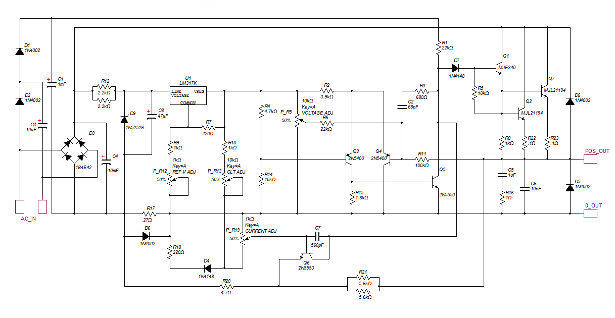

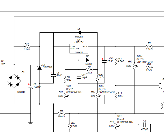

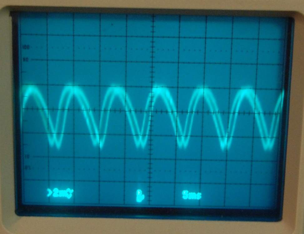

Ok, I tried several things - first I'll re-post the schematic so as we will know what I'm talking about:

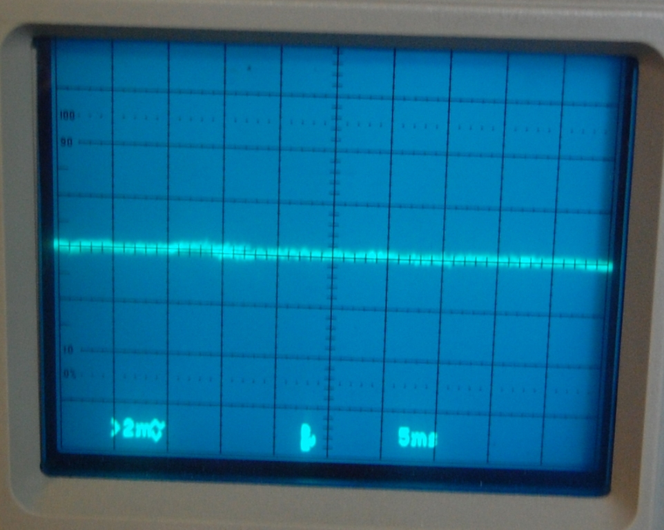

I changed C7 to 1nF - slight improvement. I dicked around some with other things then I changed C2 to 1nF(this is big, I know but I wanted to be sure) - bigger improvement, nearly gone. I then added a 220uF electro to the output and viola! Is gone! 😀

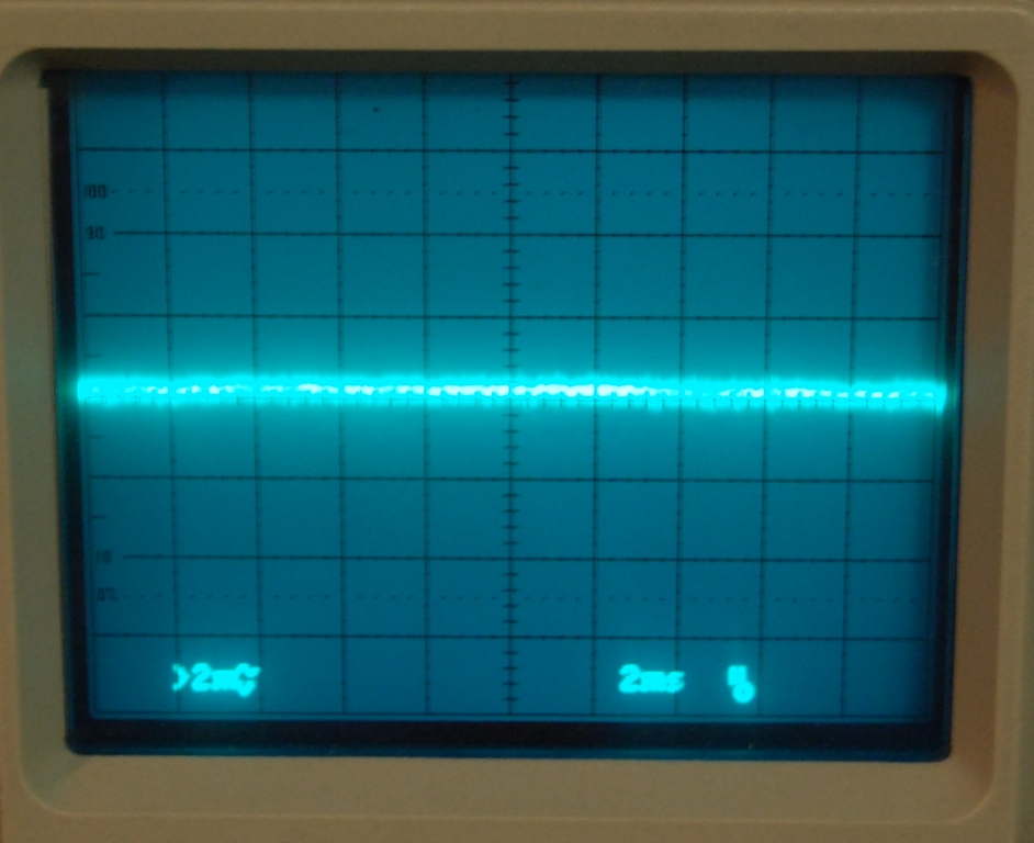

So, here is the output with no load at 15VDC:
And here is the output with a load drawing 1.8A at 15VDC:
Did someone say ripple? 🙄

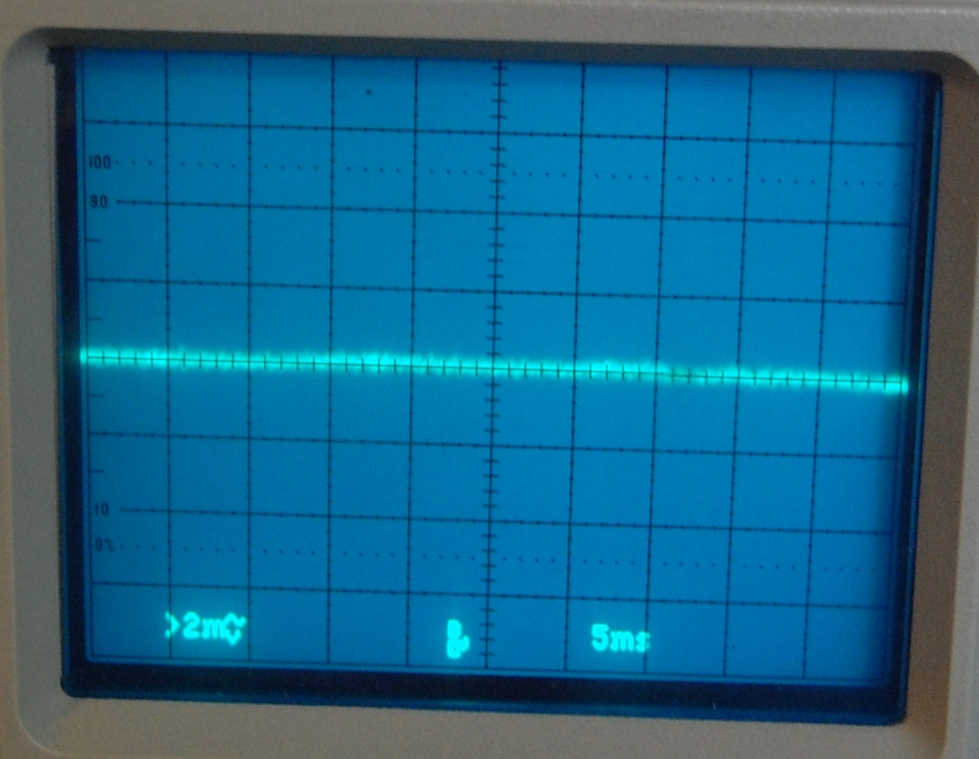

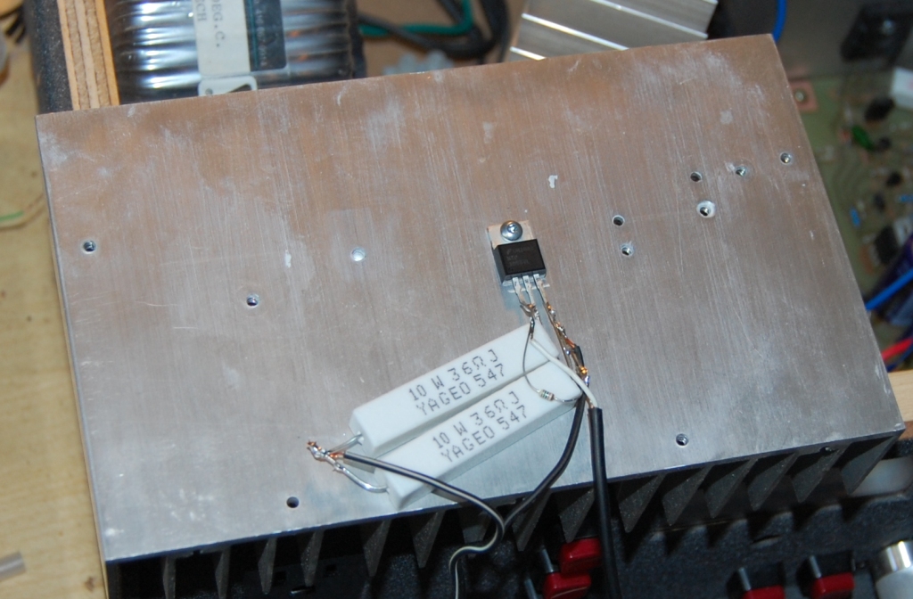

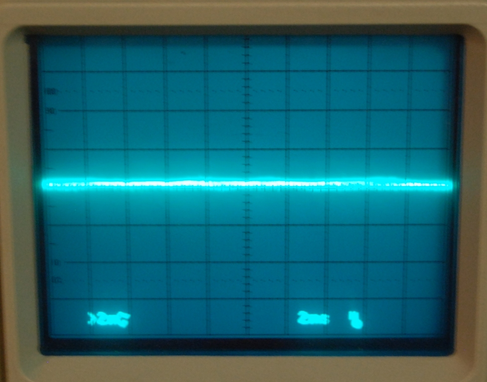

By popular demand, another look. Less blurry pics and a bigger hoop to jump thru 🙂
Got to try out the internal dummy load as well.

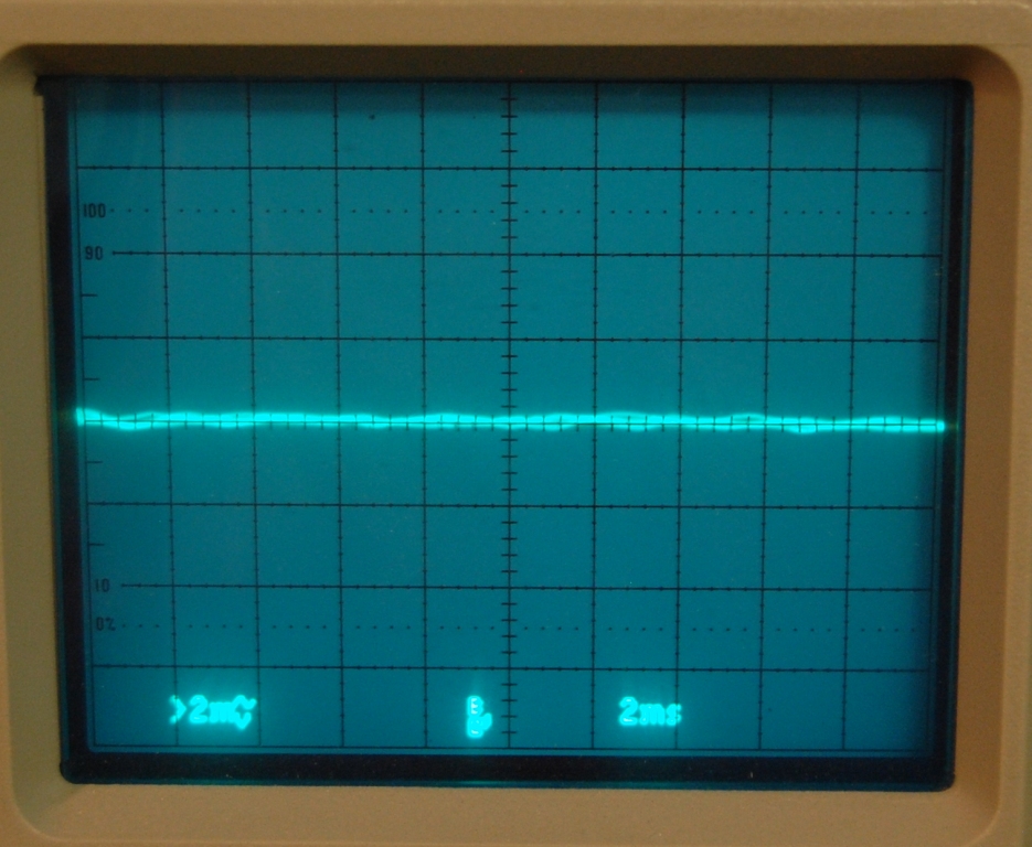

30VDC output, no load:
30VDC output, 16 ohm load (~1.8A):

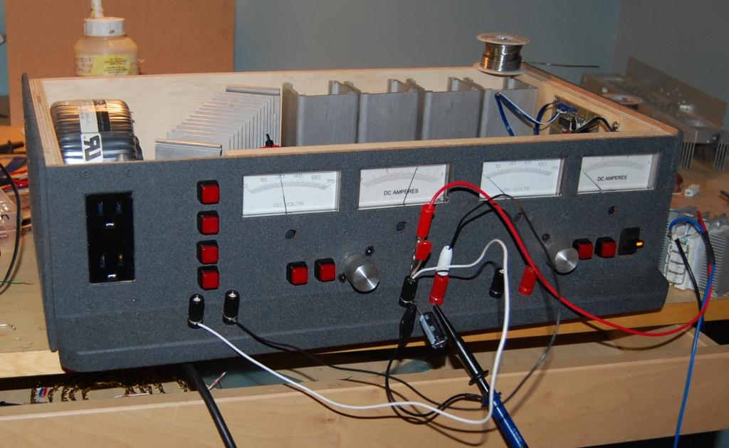

The subject:
This is outstanding IMO. I really couldn't have hoped for better.
Ripple is non-existant.
Ultra low noise.
Next to no voltage drop with the load connected.
Sweet! 😉
PS: Thank you Mega for your very effective help - you saved me again! 🙂

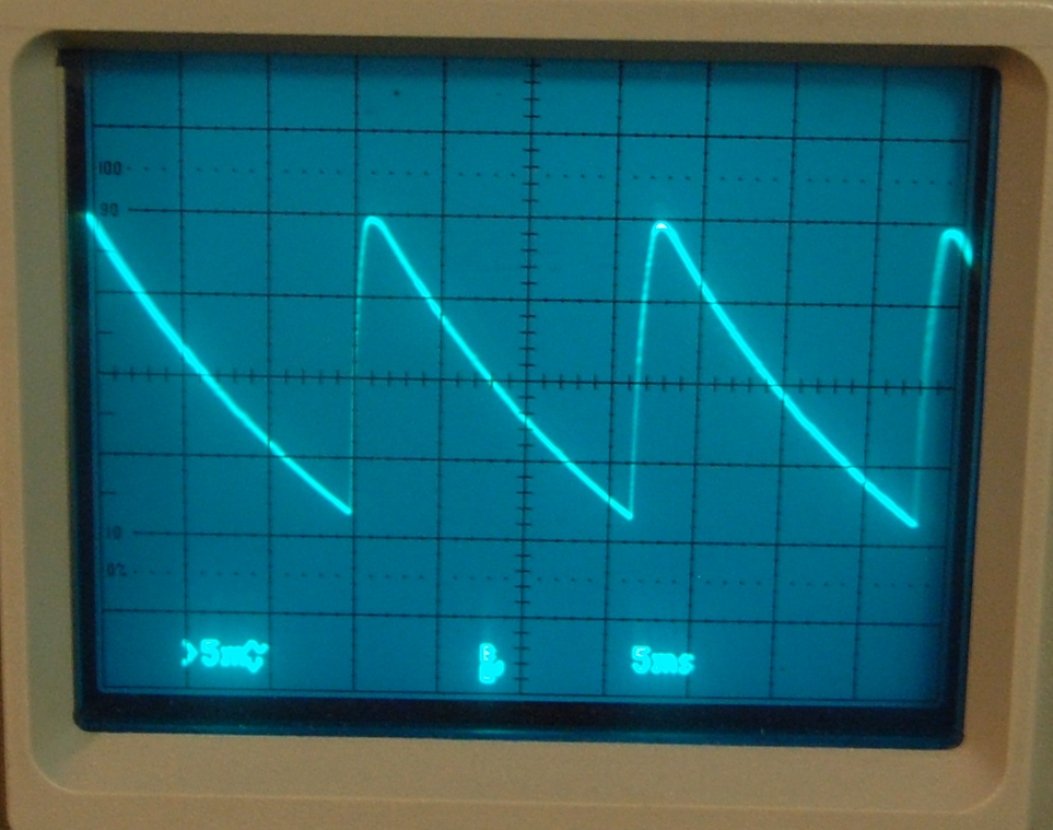

Extras, in case someone out there in TV land thinks my scope doesn't discern ripple.
Output of the doubler supply, NO load on output:
Note the v/div.
Output from the raw supply (at the main smoothing cap) with a load - 30VDC @ 1.875A:
I measured voltage drop with the load connected - it went from 30.29V to 30.13V. Not too shabby.

Do you really want the weak foldback characteristic given by R21 or is it perhaps tuned to counteract the early effect in the current limit transistor?
Going back to this from page one, I'm beginning to wonder if this is the cause of the instability. Looking at the function, R21 serves 2 purposes: First it (along with R20) provides a dummy load for the output so that it can be adjusted down to zero. Second, it supplies positive feedback to the emitter of Q6. The reason for this is that when in constant current mode (current limiting), as the output voltage falls the additional drive necessary to turn on Q6 harder is supplied via its emitter, through R21. This prevents an increase in output current.
I will have to investigate further.
Another thought: while added to improve stability, what does the 220Uf cap across the output do to the transient response? Is transient response a critical factor for a supply like this? I could rig up something to measure it - a couple of resistor loads and a MOSFET to switch one in parallel with the other, thereby switching the current draw from low to high. This could be driven with a squarewave from my FG. Maybe I'll give it a try.

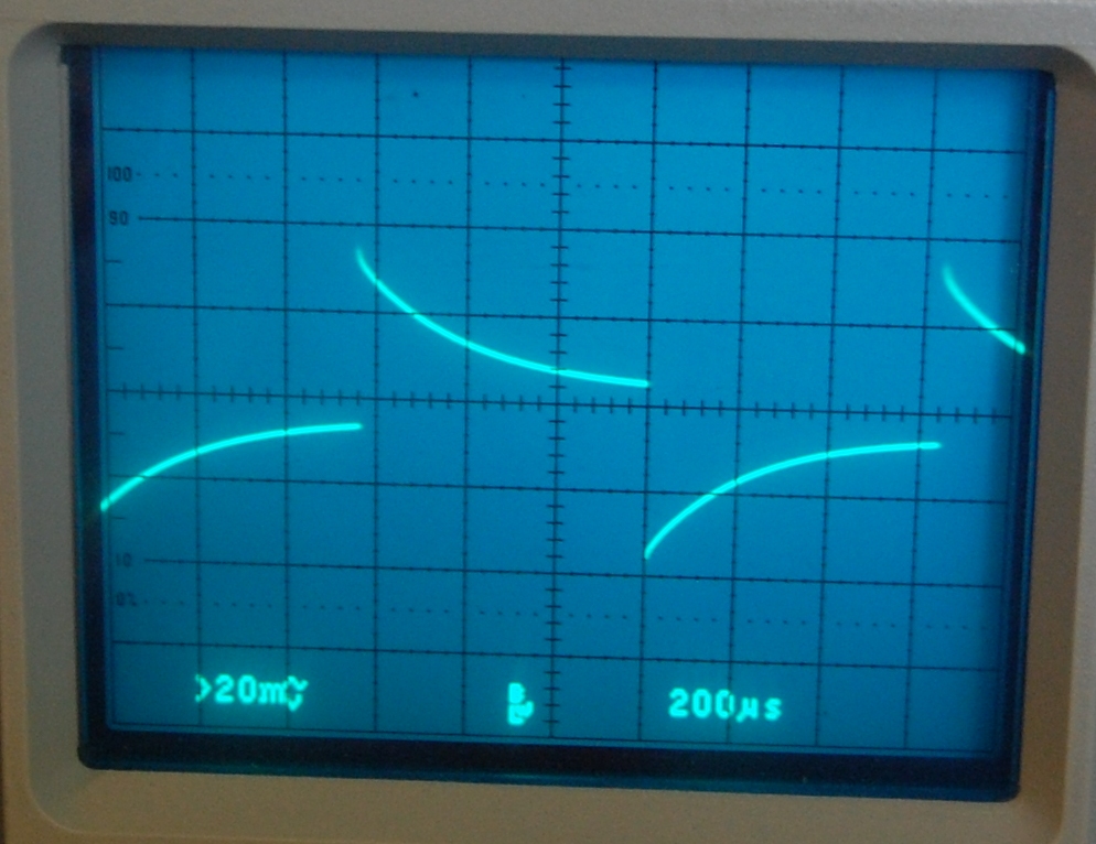

The rig:
With the 220uF cap:
Without the cap:
I see no signs of oscillation with the cap removed now. I did make one subtle change this morning - I added a 470 ohm resistor in series with pot P_R19 to stop it from hitting 0 volts. This seemed to trigger oscillation before.
As for the transient response - I think that I need to go back 'in' and fine tune the compensation caps that I replaced last night in order to stabilize the supply. The one in the CV loop in particular.

Much trial and error later, it seems I have the stability problem sorted out. I found that a cap (ideal value yet to be determined) from the base of Q5 to '0' volts most effectively tamed the oscillation. It seems that it was indeed the 'VAS' (as Mega called it, it actually sinks current from the base of Q1 to regulate the output voltage) that was responsible.
As well:

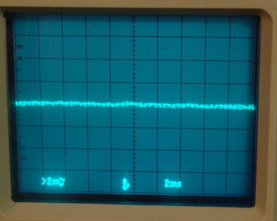

Curious if it matched the simulation results and in response to this comment (again):
Take note of the V/div scale. (~23mVpp)
I then scoped immediately after R1 (what drives the base of Q1):
note the V/div scale again, same time base (less than .2mVpp). Interestingly enough, this is free of ripple. This is (nearly) as clean an a pure DC source.
The same, but with a load at the supply output drawing 1.2A:
Virtually unchanged. There is no ripple of any significance.

I did some more measuring. I scoped the output of the doubler supply again, before R1:If I remember correctly you are feeding the pass transistors from some rudimentary voltage with no regulation
This result is not obvious at first glance. After all, we expect huge ripple from a relatively unfiltered and unregulated doubler supply, and would think it would make for a pretty rough base supply for a regulators pass transistor. TBH, I was very surprised when I saw this in simulation and I felt that it could not be a true representation of real world operation. It in fact was an accurate prediction of the outcome, as shown in the actual scope shots above.

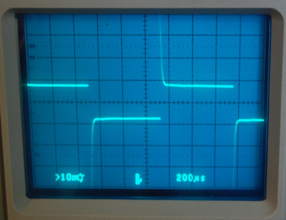

This is my transient response test and it puts a switching impedance on the output of the supply - 36 ohms and 18 ohms. The rig (shown in post #111 and 112) does this and IT is driven from a squarewave output from my function generator. This doubles the load at each cycle (if testing at 1khz, it would switch 1000 times per second) and shows how quickly the supply copes with load changes.
To stabilize the supply, I put a cap from the base of Q5 to 'ground'. I went for broke here and put a 1uF cap, just to see if it would halt the oscillation. It did and before I do more testing to see if a smaller value will work, I ran the transient response test again.
This is the result:
This is at ~1KHz. As can be seen this response is much improved over the previous runs and I'm tempted to leave things as they are. The response is free of the over-damped compensation effects shown earlier.
You should turn those VAR controls coming out of the middle of the volts/div selectors fully clockwise until they click into the calibrated position. The > symbol to the left of the sensitivity readout means the sensitivity of the oscilloscope is turned down from its calibrated value.
The ripple looks pretty good but the transient response is a little slow compared to what is possible. But if you are content with it then I guess it needs no bettering, of course. I'd use standard miller compensation around Q5, probably with a resistor in series like you have now to get sensible components values for a nice loop crossover frequency. The current R3 does not do much though. It won't have much effect until about two decades above the loop gain crossover frequency.
A large output capacitor is often used because it helps the transient response but if it's too large the protection of the current limit is reduced because a lot of energy is stored in it. My Hewlett Packard 0-50 V, 0-10 A (but limited to 200W too) power supply actually has about 3000 µF of output capacitance if I remember correctly!
Funny, I attributed the poor TR in post #112 to the 220uF cap. I'll try it again.

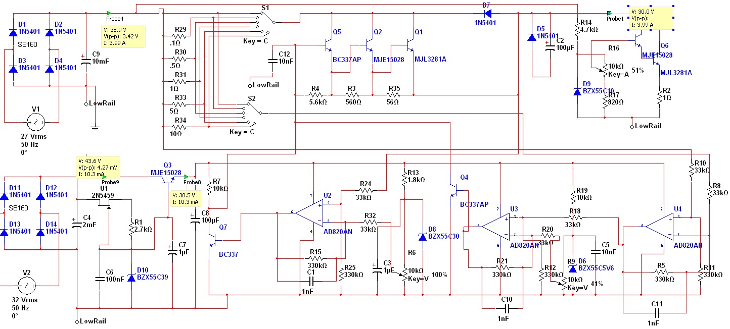

I attach my almost final schematic so you can see the similarities and differences. I use a separate supply to power the op-amps and again a separate zener to feed the pass transistors' bases and again a separate zener to provide the voltage reference and finally another zener to provide the reference for the current limiter. Lots of zeners 🙂
One more thing, you may want to put a 22uF-47uF cap at the ADJ pin of the LM317, as per manufacturer instructions to eliminate ripple from the reference voltage and from the diff amp.
Ahead of you there:
You have been busy, I see. I'll take a closer look.
You are using MS. If you don't mind, can you attach it? Just change the extension to .txt
