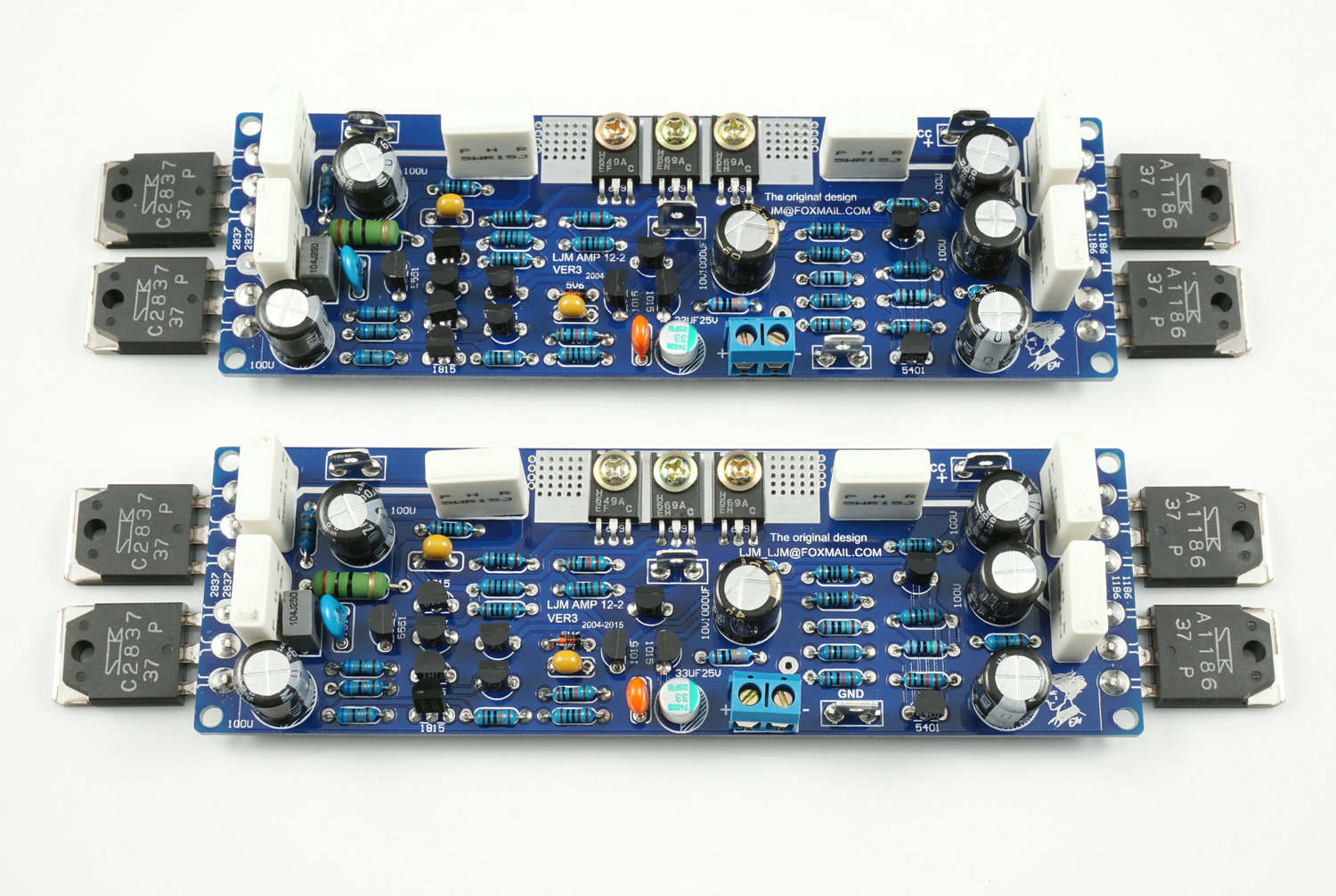

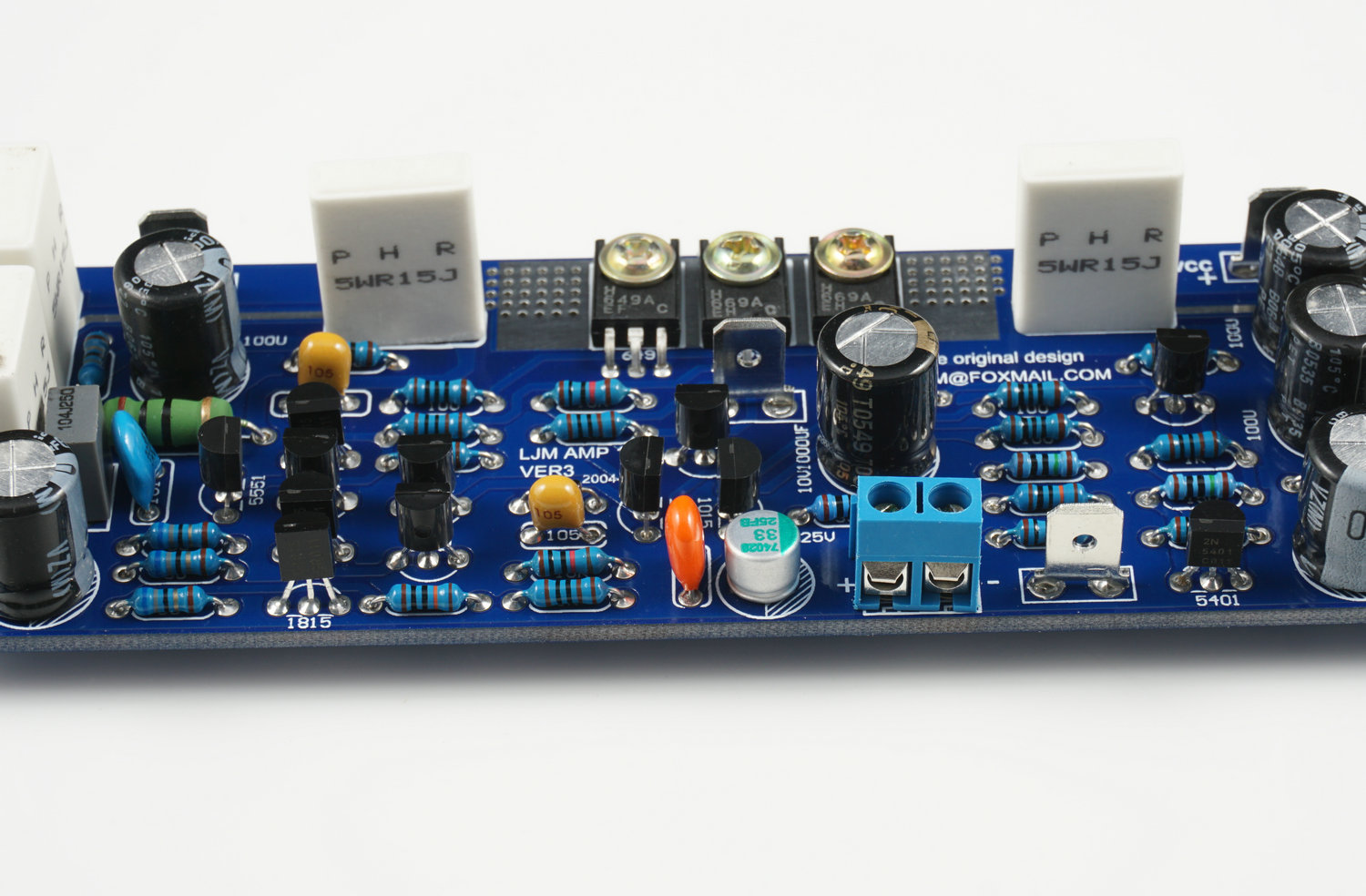

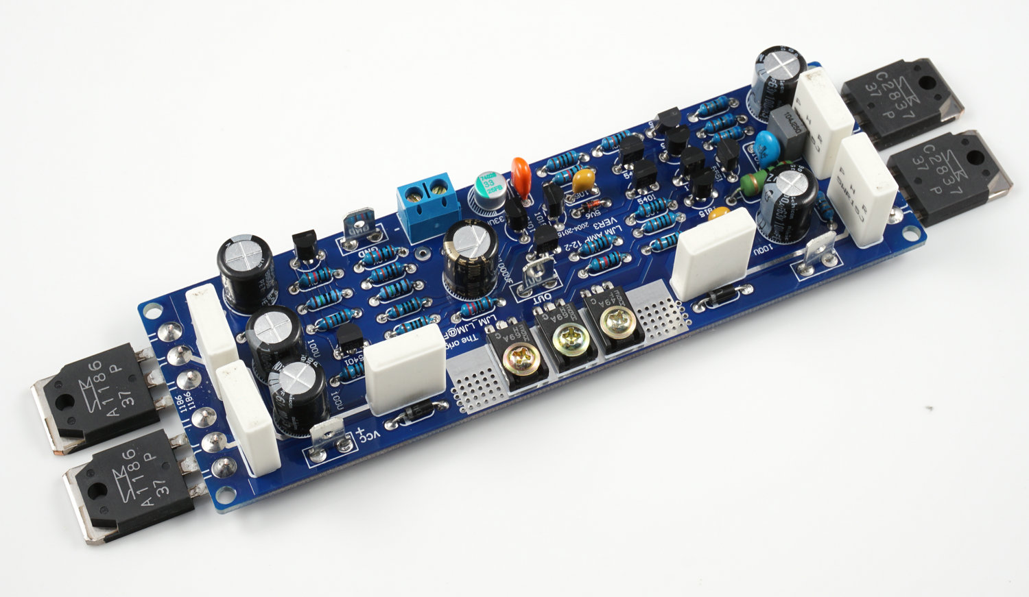

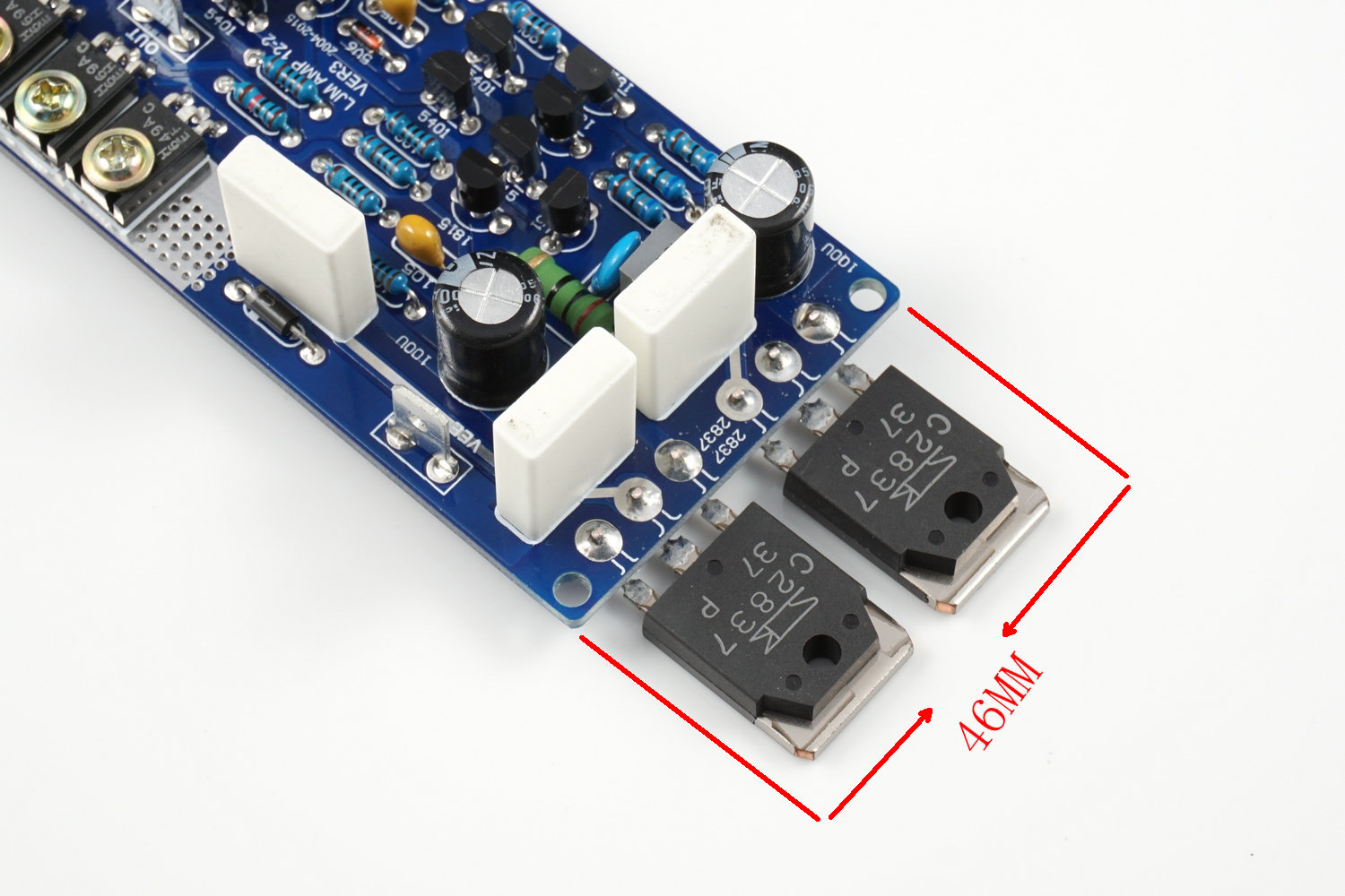

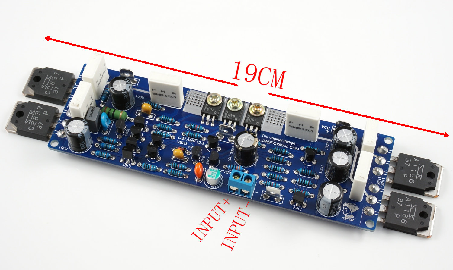

In China there are a lot of piracy L series power amplifier module. They have a plenty of red, or yellow, black.
One thing is for sure. L12-2 has been using since birth
SANKEN LAPT 2SA1186 2SC2837.
It is probably the most rapid current transistor.
Can reduce the CFP, switch distortion.
L12-2 is a little change. Better performance.
But I don't think you need to pay attention to the output inductor, only when we use capacitor as a load, rather than drive speakers.
Inductor is needed.
Our power amplifier drive capacity, rather than the inductance, there's a possibility, at least I won't do that.
If you have a really like output inductor, capacitor load to driver.
Then a knife with a self-contained silk, with copper wire around the above 20 laps.

Ten turns of 0,5-1mm dia wire around 3W resistor of 1 to 10 Ohms value. The values are not critical, anything in this range will do.
If your amplifier is load capacitance, rather than speakers. The output end really need inductors.
, of course, also include this possibility: the length of the sound box line more than 20 meters in parallel, because the sound box line is too long can produce capacitor. Such as the application stage.
If it is a home, you don't need a inductance on the output side, it will increase the impedance.

L12-2 Very good. I used to use it to assemble the machine, the use of single crystal copper transformer 500 va.
Huge radiator chassis. Such a machine I used to sell to customers a lot of Switzerland.
The price of more than $6000 each. 😀

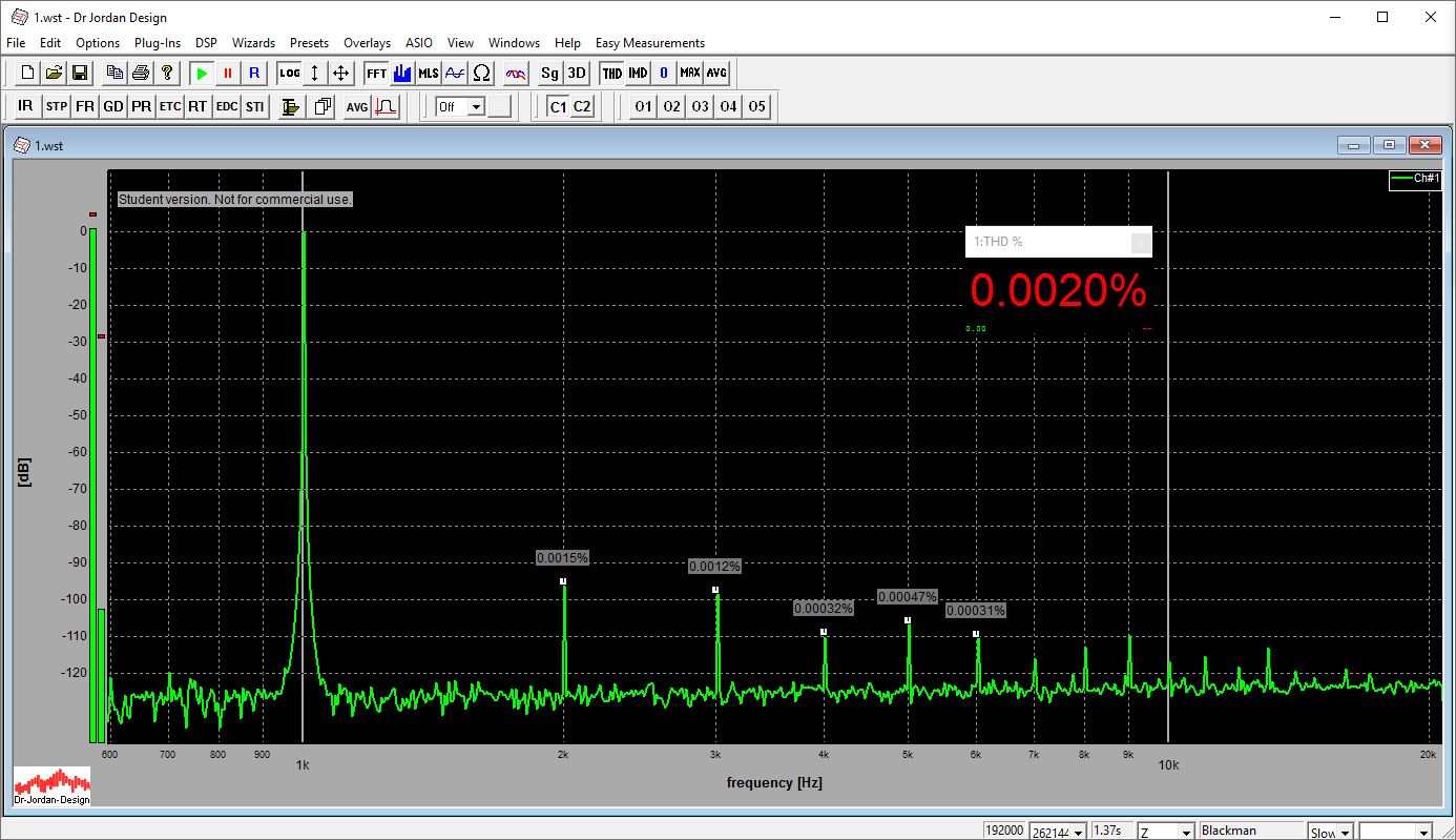

My live measurements

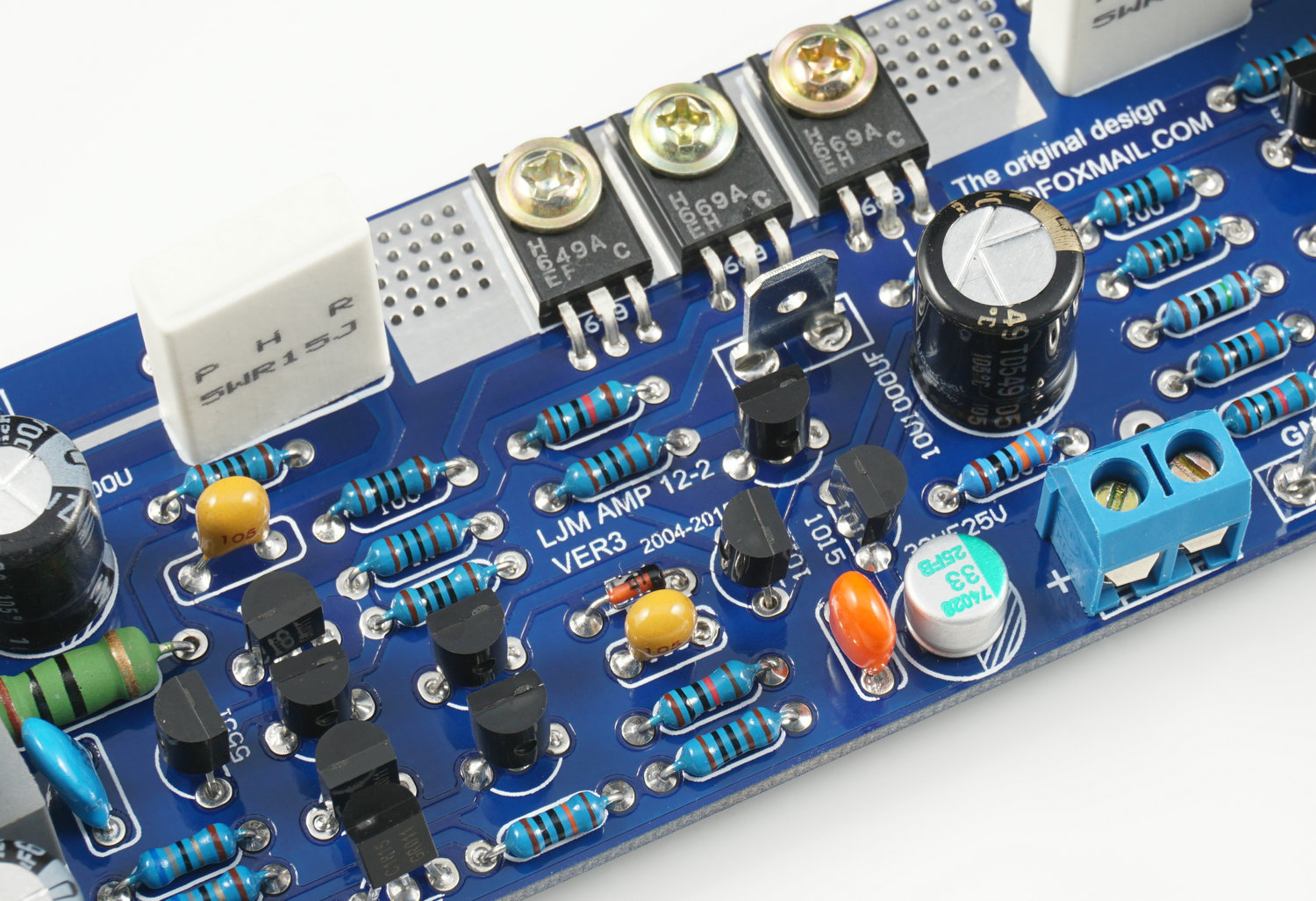

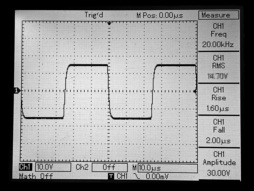

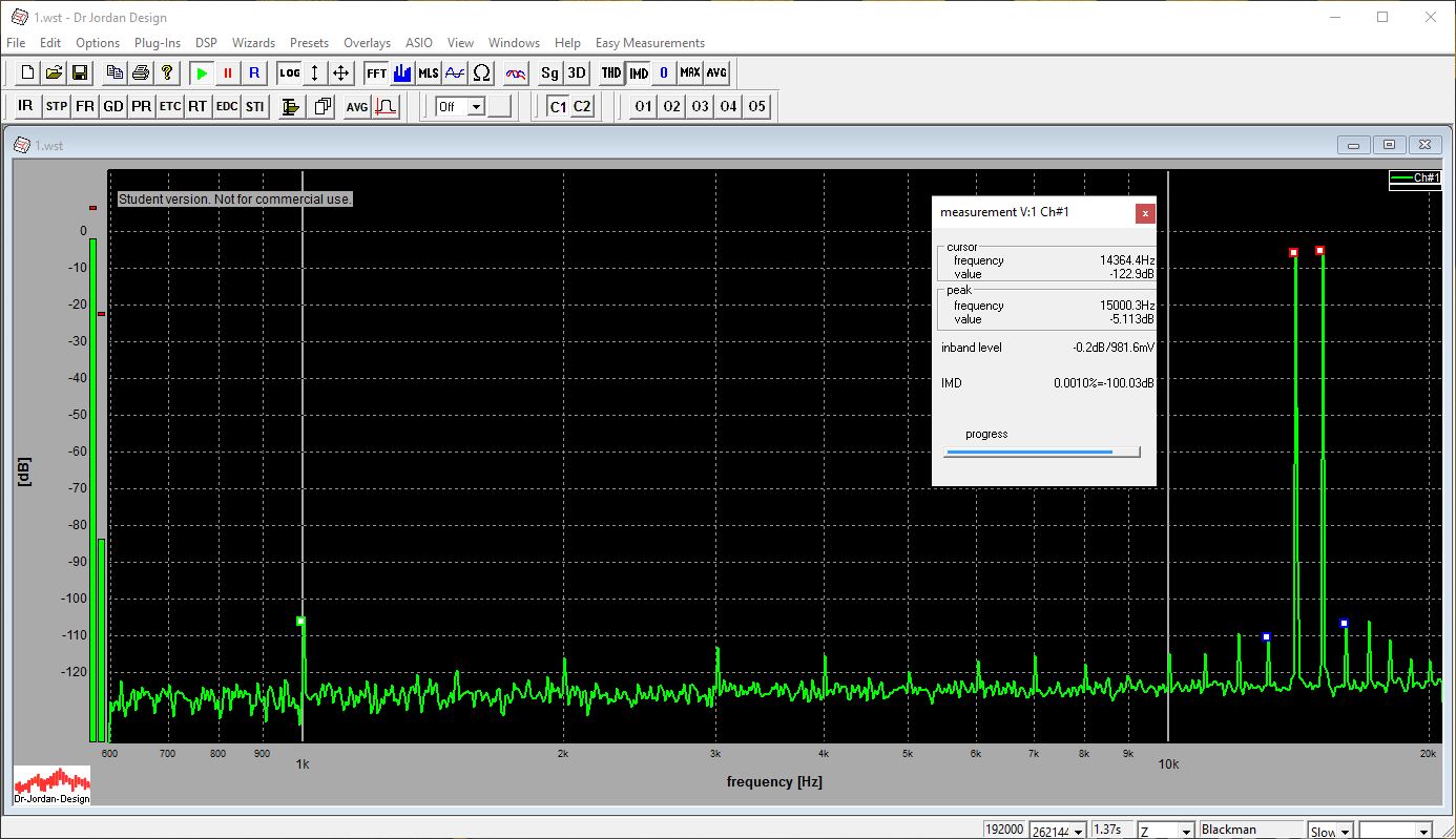

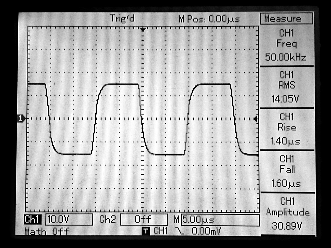

Hi All,
Just got a pair of the boards from ebay - measured the key parameters yesterday.
Power rails were +/-36V DC.
All the spectrums are measured at 20VRMS, 8 ohm resistive load - equal to 50W output. I can't go higher due to my load resistor power, rather hot already 🙂
Square waves - 30V amplitude (p-p).
Very good performance, I must say :up:
Valery

Hi Valery

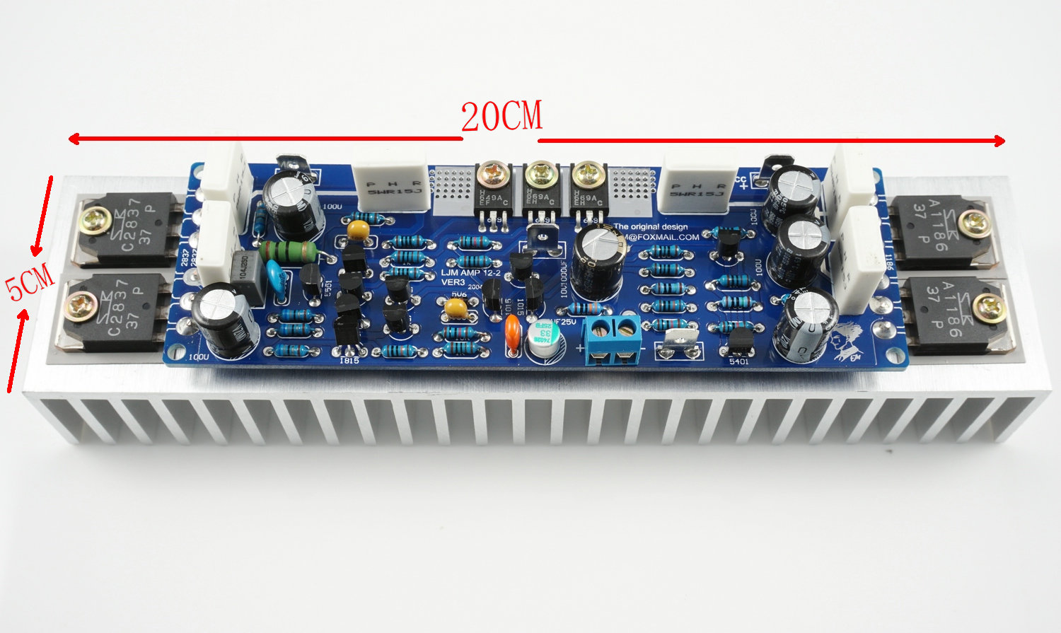

Good that you have now received your modules. The results agree with what I tested using the Quantasylum QA 400 card and they are certainly good value. How hot did the supplied heatsink become when you tested to 50W?

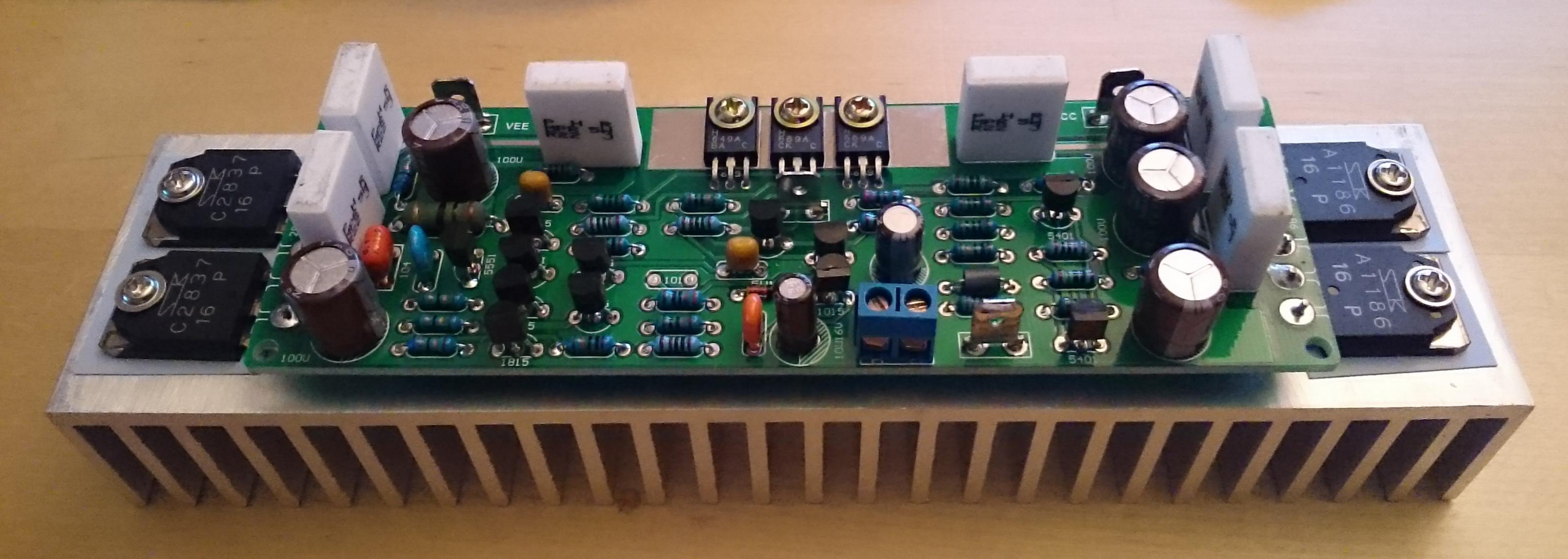

Hi Ian, the heatsinks were still pretty much ok - I would assume some 60-70 degrees, from what I felt with my hand, although they look somewhat smallish to me, especially thinking about potential capability of driving some 100W.
However, a 50W load resistor felt much more stressed at that time 😛
quick solution to heatsinks

Sorry to have been away from the forum and threads for various reasons.One of which is That I rebuilt my blown amplifier boards with replacement units .I have now used the two spare heatsinks by resting new stuff on top of older ones and wedging them tightish.
This is a very easy way to nearly double up the safety margin but Ive lost the benefit of air circulation.
I am now Using 53V rails (500VA)and having a pair of 86-87 DB sensitivity speakers in a huge room, so I still managed to blow the 3.15 fuse without the slow start setting board cutting the power off.
