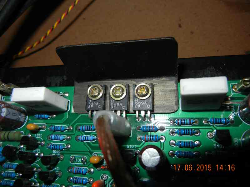

I put a small aluminum heatsink ( painted black) on the 649/669 and bias tr. Originally they appeared to just sit together on one long strip of pcb tinned track. With the current heatsink of about 45mm x 32mm x 1mm , it gets slightly warm after a couple of hours at medium volume. Would probably get quite hot without additional heatsinking at high volume (?). My sink is bent into an L along the length (45mm). So the 20 mm strip is actually perpendicular to the board.

The mini heat sink for the drivers. I bent it by hand . I couldn't bend it to 90 degrees easily and so left it partially bent. It still does not stick out of the edge of the heat sink so I left it as it was.
