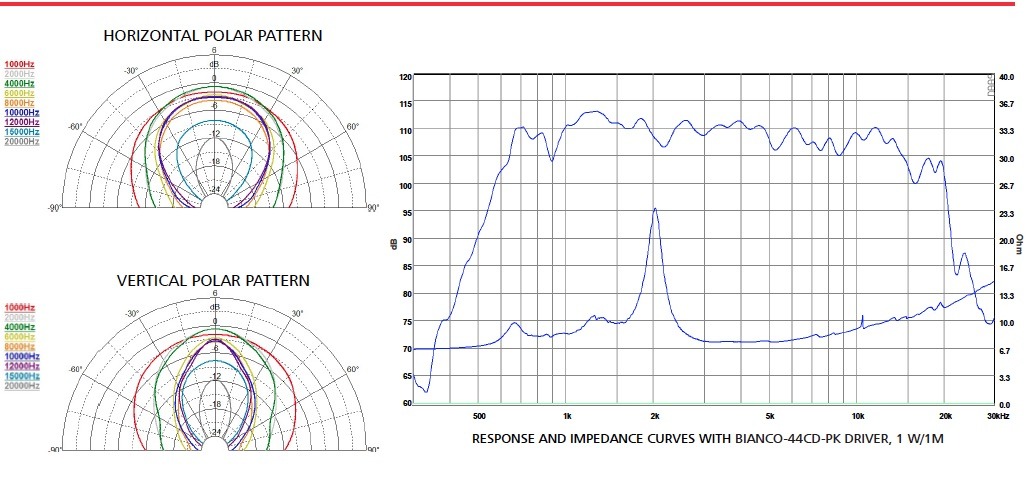

Try the SB Acoustics horn,

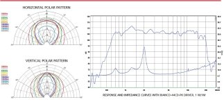

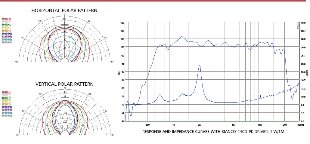

I looked at the data sheets for the H225 and H250 but couldn't really figure out why you might choose one over the other. It looks like the biggest difference in the polars is in the vertical pattern. Also in the FR the general impression is that H225 trace has negative peaks and the H250's peaks are positive, though I somehow doubt you look at it that way.

Higher frequencies are usually determined near the throat. Lower frequencies are more affected by the angles and mouth size. In this horn, the vertical (height) is both shorter and more narrow, which tends to set the limit on how low it will perform as expected.

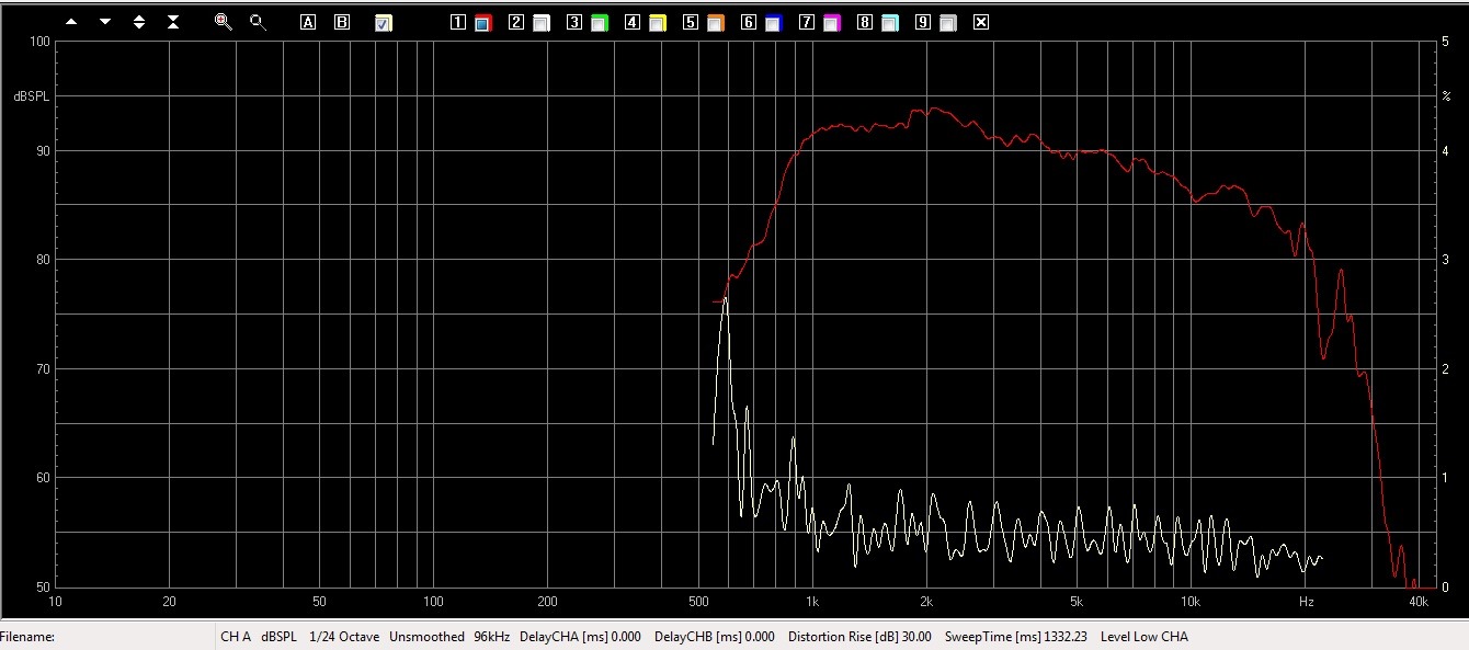

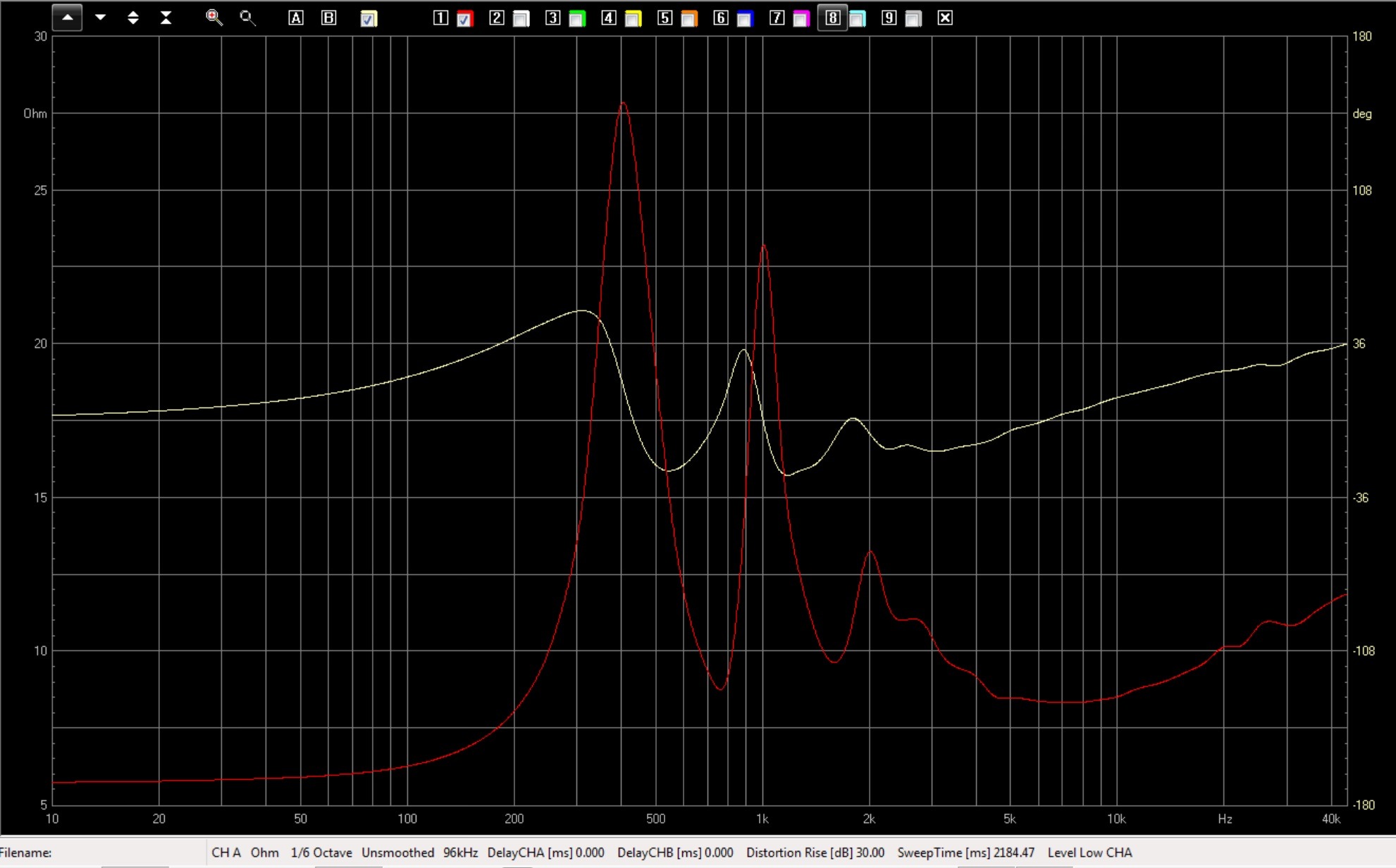

I'm finding out that the LCR meter in Clio can only measure DCR of a non-inductive element . Otherwise it is giving reactance and that at frequencies it chooses , no generator control for the user with LCR meter function , so it tests different things at different frequencies. and its reactace measurement in LCR meter doesn't line up with what it measures in the impedance vs frequency window, which I gather is probably accurate.
The DVM gives 5.7Ω for Re.

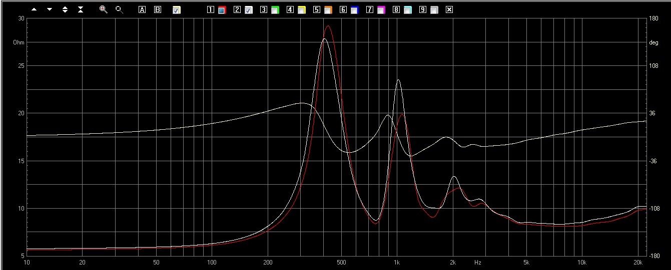

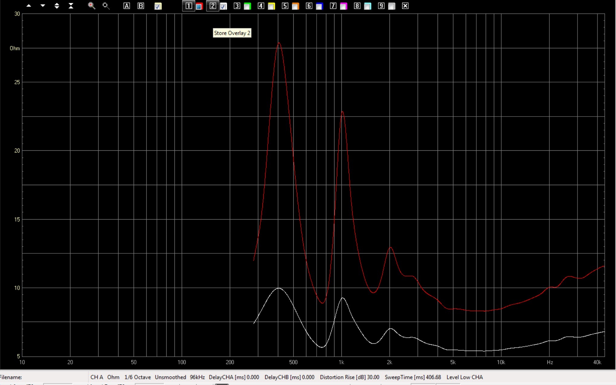

If you can post an impedance plot,
On the horn or off?

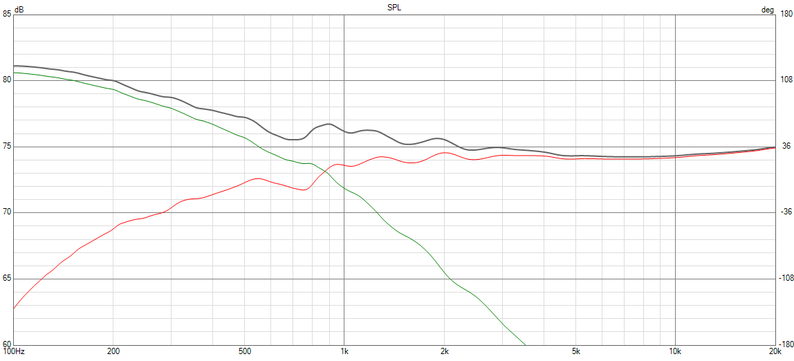

Edit : posted are plots with horn . FIrst is Frequency Response, Second is Impedance and phase, Third is Impedance and with 15 Ohm R parallel.
These were done before. I'm happy to redo them if you want parameters changed in any way.

I had this idea that smaller horns did better at high frequency dispersion than larger ones.
  • Impedance and Phase CD on 18 Sound - Red Right - White Left - and Phase copy.jpg
On the horn or off?
Normally you'd do it on the horn but I'll take whatever you have there to offer for demonstration.

"posted are plots with horn . First is Frequency Response, Second is Impedance and phase, Third is Impedance and with 15 Ohm R parallel.
These were done before. I'm happy to redo them if you want parameters changed in any way. or if you want them in txt or whatever."

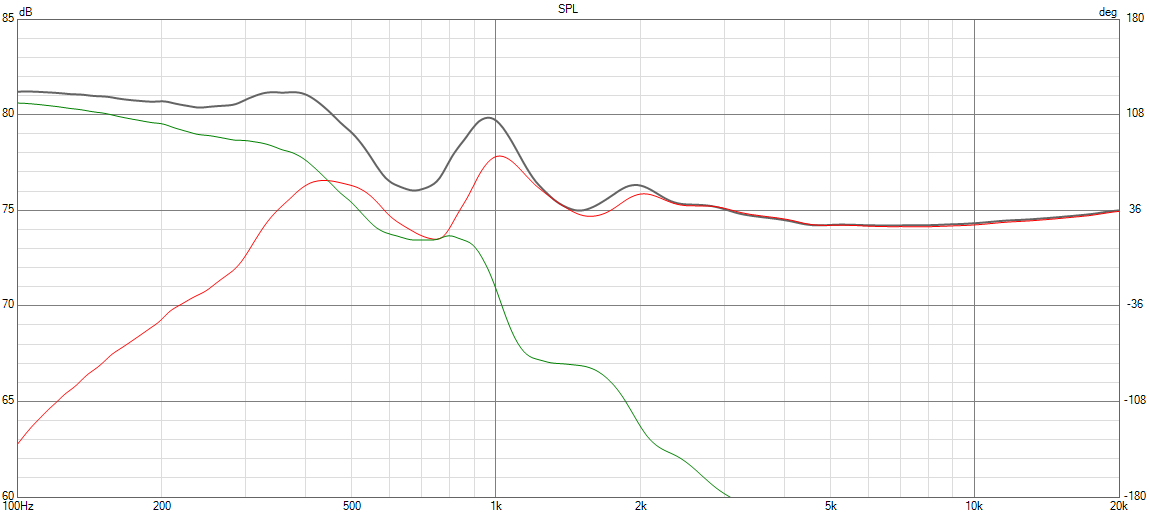

Stanislav, I agree that the series crossover can reduce variations due to impedance variations and may possibly not be necessary, especially for example as with some inexpensive commercial speakers where the tweeter resonance boosts the output for the woofer in the reduced power top end, and a couple of other things.

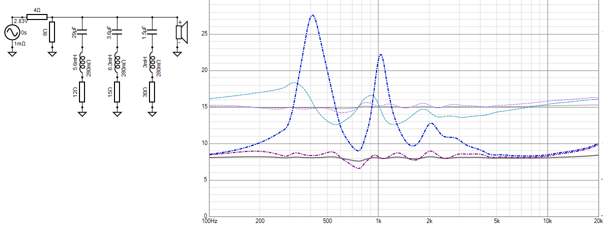

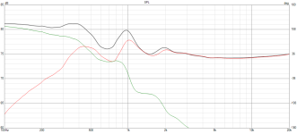

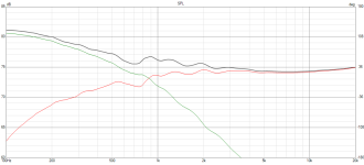

However if what we do is deliberate.. take this example of a series crossover with 6dB of series tweeter attenuation (the smoother one is with compensation)
Reactions: Hearinspace

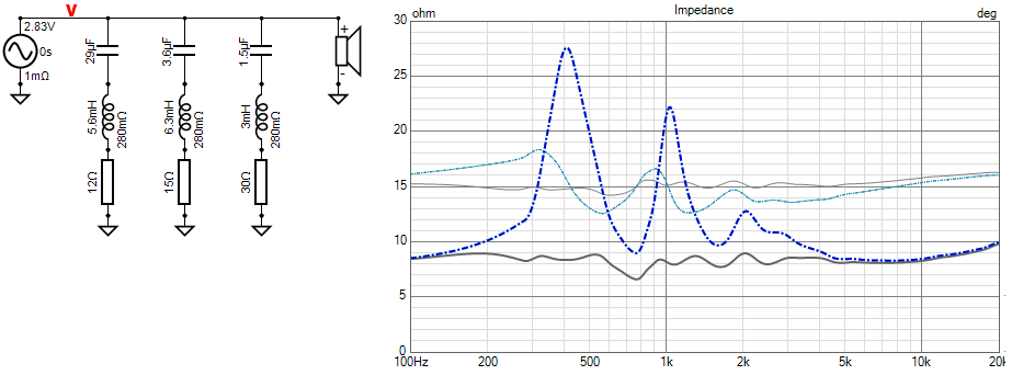

So far what I think I see is that you start with the centre frequency of each impedance peak. Then estimate the parallel resistance that will level the impedance at that frequency. Then calculate values of L and C to get a resonant circuit that goes purely resistive at that centre frequency and is the same Q as the entire peak.
Have I got that right? and if so, are those the right steps

More or less, yes. You'll pick it up in no time.

By the way, I found this calculator last night. (For Series RLC Resonant Circuits) Very nicely done.
