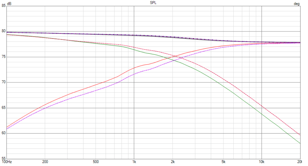

In theory using ideal resistive looking drivers, you can achieve the same result with either 1 or 2 resistors just by adjusting the reactive components.
As for using real drivers, I'm sure that you could achieve the same result either way if you were willing to add components as needed.
So with that said I'd like to run a simulation, using ideal drivers except for the tweeter impedance variations.
  • Thank You
Reactions: Hearinspace

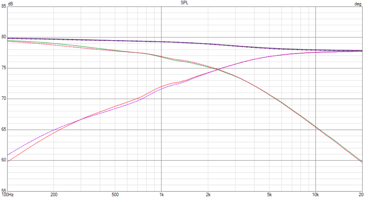

I simulated with 2.2mH, 24uF, 0.76R and 15R (dotted traces).
Then I removed the 15R and increased the 0.76R to 0.9R for the same attenuation.
It's very interesting to see how it affects each driver's output in opposite ways. I don't know what it means yet but it's something to learn about.
The big dips in FR I assume are related to distance from the speaker and maybe nodes in the room.
Is it logical to think that adding to the value of inductance would lower the woofer's output under the tweeter and allow getting rid of the resistor altogether?
What question should I ask next?
I do hear a qualitative difference though not sure yet what exactly it is. The diference with padding is not just a matter of level and so far I don't like the change that I hear.

Any crossover simulator is fit for that type of comparison. These days I often use XSim or Vcad to answer questions of this nature. The plot above uses Vcad.
What's important is that you include anything that's relevant.. in other words are careful to simulate the right thing. Any questions feel free to ask. As Stanislav mentions..

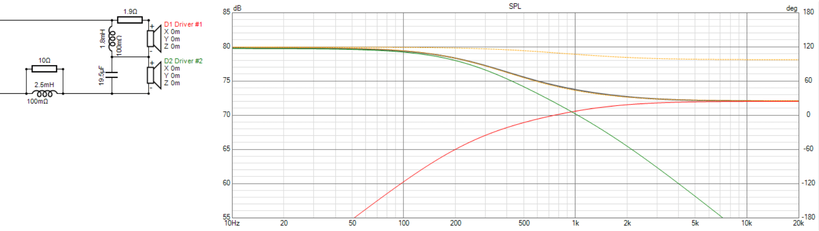

Allen's circuit diagram above is the only sensible way of doing BSC in a series xo when not crossing at the baffle step. Nicely done.

Showing a generic baffle step compensation circuit (cross=1k, baffle step=500Hz). YMMV.
While I understand the rudiments of R, C and L, this simple looking addition is more than I can grok without a little orientation. I notice that Stanislav - who clearly knows his way around - was impressed by your solution too, so can you say something about the thought process one might follow that might lead to that sort of circuit?
I'm meeting up with a friend on the weekend for some inductive horse trading so I can try out your circuit. Will post how it turns out. Thanks Allen.

It is in series with the crossover and it's effect covers both drivers.
The basic function is to apply series resistance at higher frequencies. The inductor removes itself from the circuit at higher frequencies since it's reactance exceeds the level of the resistor. At low frequencies the inductor removes the resistor from the circuit by shorting it. The value of inductance changes the frequency and the value of resistance changes the level.
It models well in a simulation where ideal impedances are used, which overall remain smooth with changing frequency. A practical series crossover benefits naturally from some impedance averaging already but it's possible you may need to tweak this in practice, as with any crossover.. perhaps by adjusting the tweeter level resistor or in some cases by adding some impedance compensation.
It can, of course, be simulated if you provide sufficient data. If you want to experiment with levels and frequency and don't have a range of component values, you can try these with EQ using a shelving filter.
