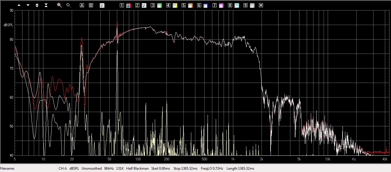

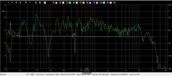

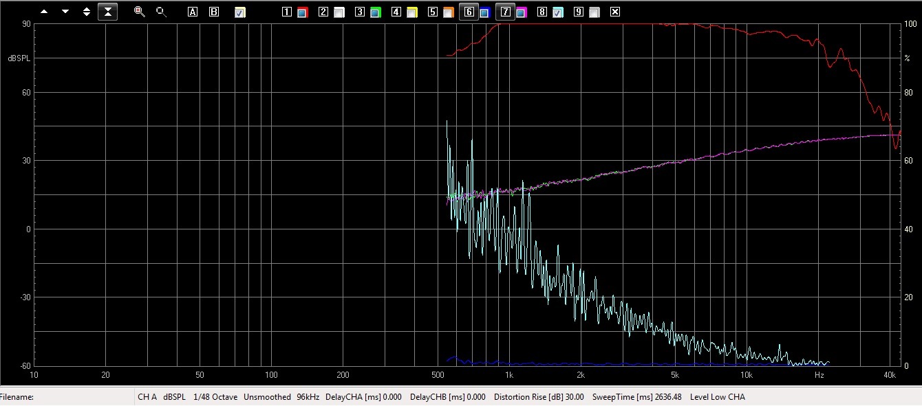

Got a little time to try this out today with Baffle Step modified XO. with results below. I have to admit , this testing stuff gets to be fun in its own right. I'm sure that I'm only scratching the surface of this Clio box's capabilities , with MLS and Log Chirp looking like they might be worth learning how to use with averaging of multiple samples in this very noisy environment but the learning curve is steep and I have to use the time with it as best I can before returning to owner.
So anyway, here's what I did today.
First is both drivers with XO (white trace is THD).

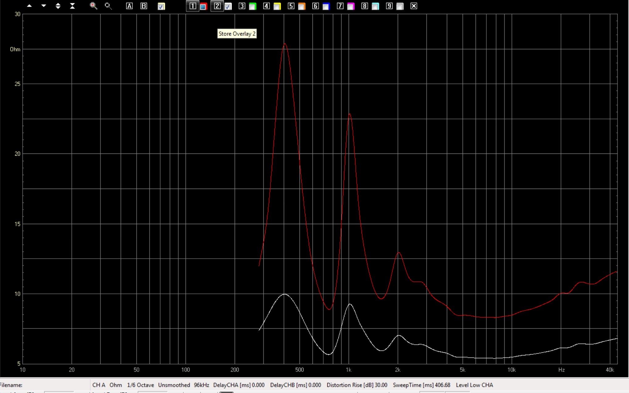

Next is impedance of both with xo .

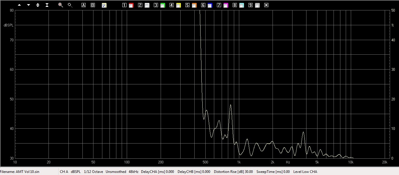

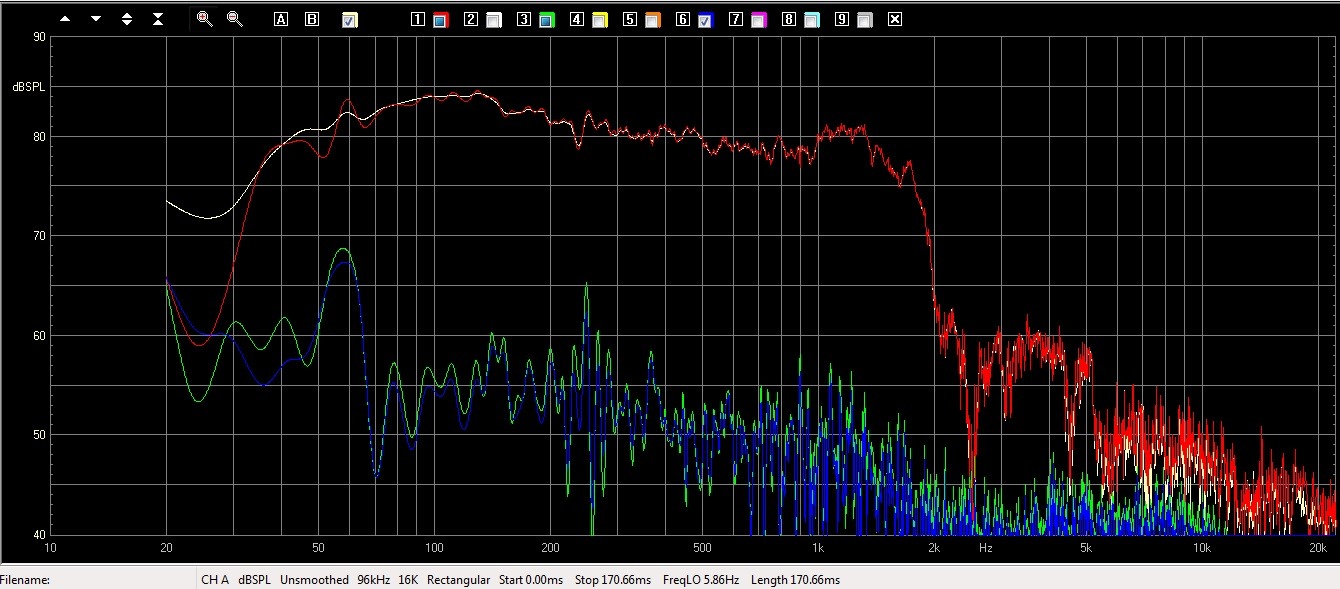

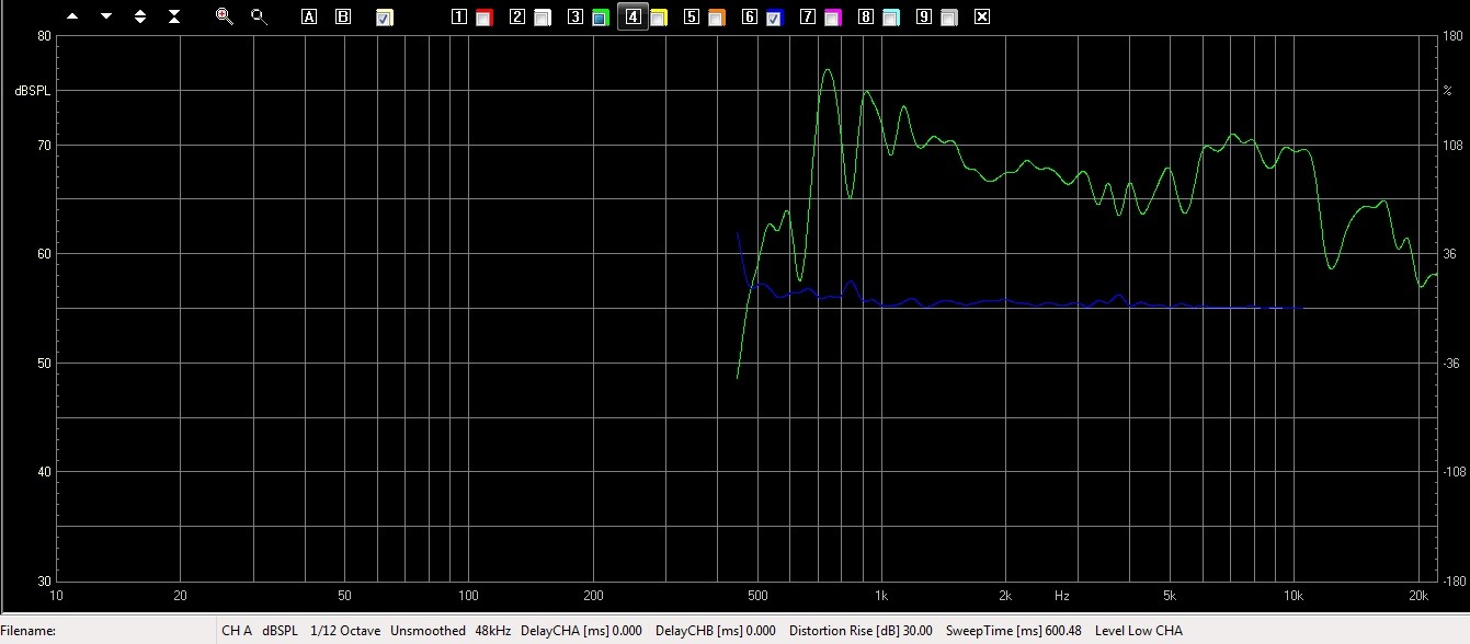

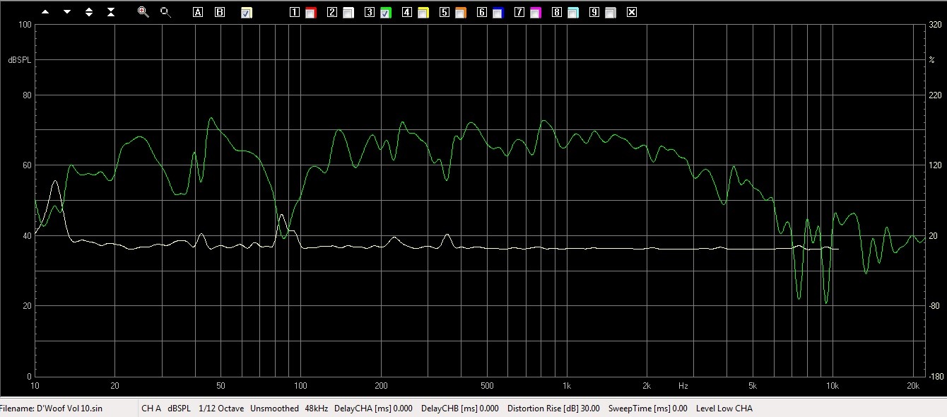

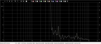

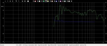

Next two are drivers alone at lower volume (but still at 1 Metre) to protect the AMT(The distortion for the AMT in blue was easy to see on the Clio's laptop but I can't see it on mine.)
Edit: Added expanded view of AMT distortion. Now I see reason why crossing it higher is recommended by some.

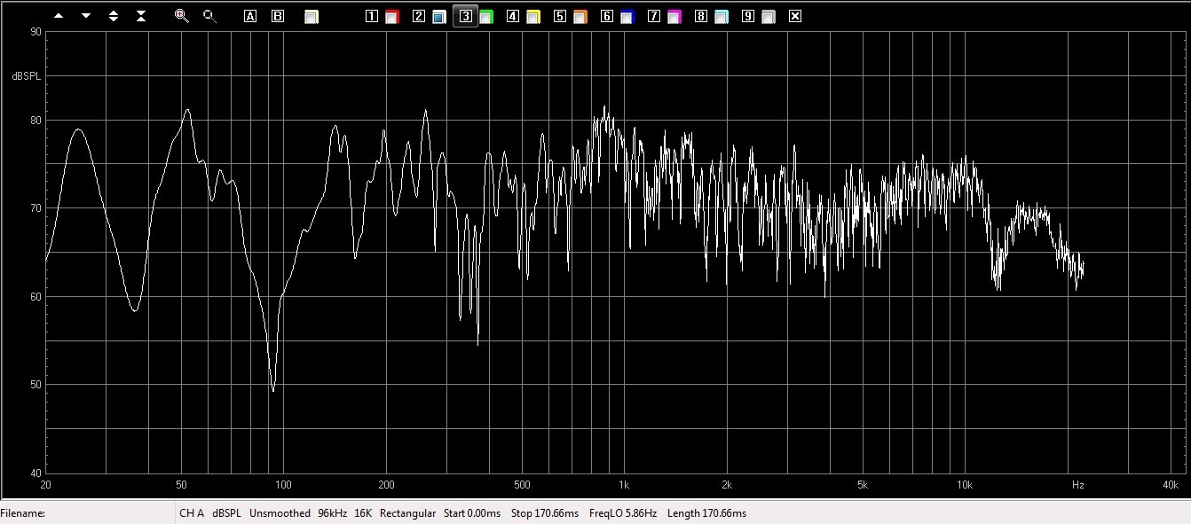

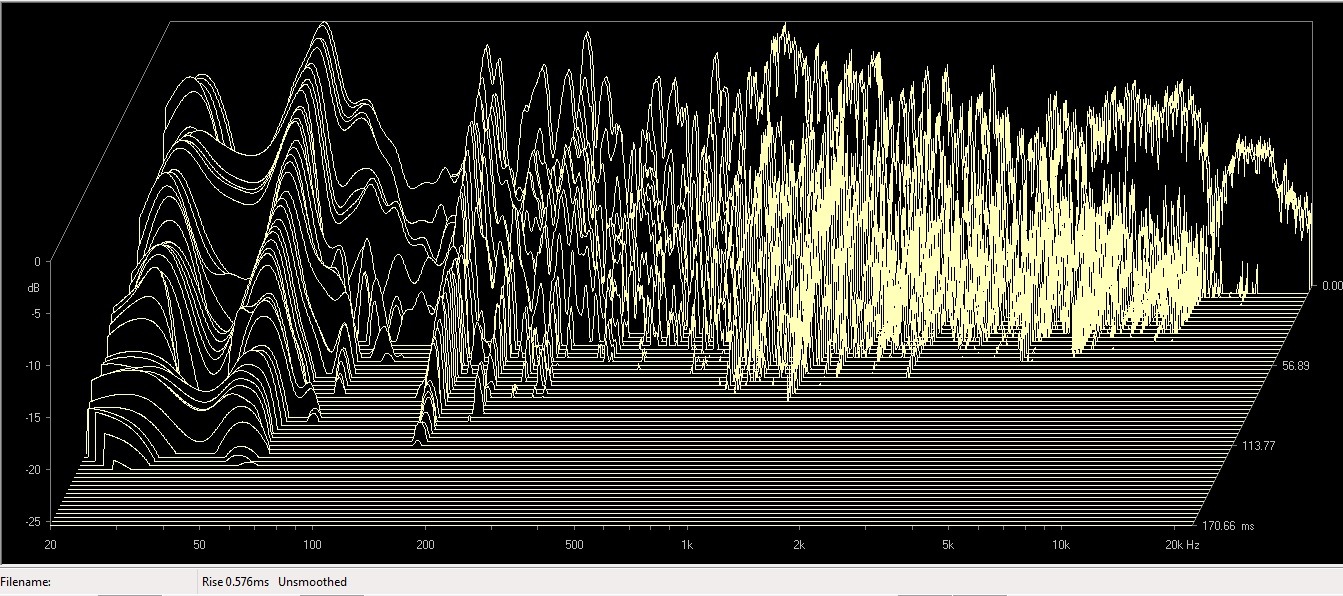

I have a couple of questions about the results so far , not certain it's best to continue here but as I'm still working with L-Pad on series XO I'll go ahead and post.

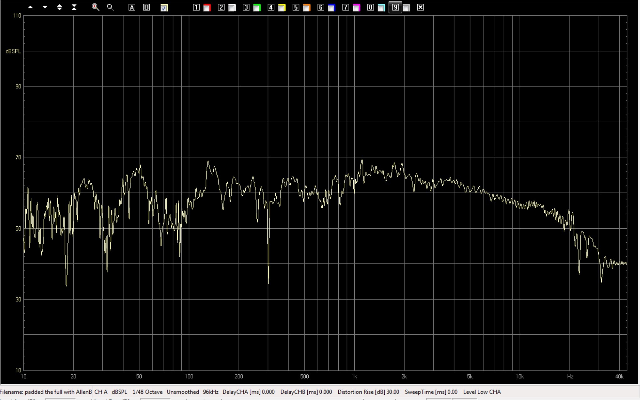

First is the big null at 90Hz. shown in the first of the images directly above but also new one below. I tried some other tests with the mic farther away from the speaker and it's still there. Would that be caused by cancellation related to the distance of the woofer to the floor?
Also. I got a chance to explore the Clio a little , trying the MLS and LogChirp functions and now wonder what the best way to test a speaker is, Sine sweep, MLS or Log Chirp. I lean away from the sine as the other two offer the option of averaging multiple sweeps and as I'm testing in an apartment with uncontrollable noises of all types I believe averaging of a bunch of samples is most likely to minimize the influence of the noises on the result.
90Hz is most likely a floor bounce.
It's almost impossible to test speakers indoors and get some reliable results, especially at the low end. You need to place the mike very close to the cone to get any meaningful reading and still the great outdoors are your best option.
Don't know about CLIO, never used it. Played with ARTA, REW and HOLMImpulse. The last one is the easiest to use.
Nowadays only use Spectroid, a small Android app. It's enough for me.
I wouldn't expect 90Hz to be any single surface per se, the room is quite involved with these lower frequencies.

After posting I found this chart and measuring the height it seems to correspond. The other nulls I will have to learn more to figure out.

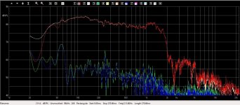

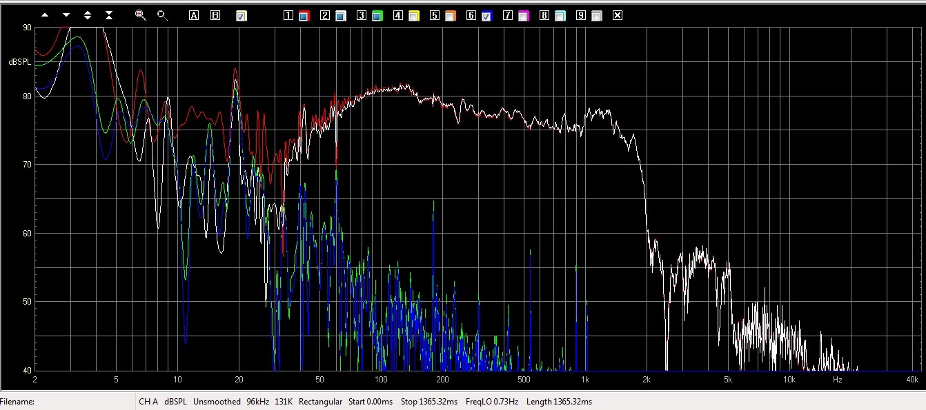

Below are various sweeps at different resolutions and different windows. (Rectangular , Hanning, Hanning/2, Blackman, Blackman/2) First four are with mic close to woofer. Hardware set-up unchanged.
Last image is a compression driver on a small horn. Sine sweep 1/6 Octave resolution are the very top trace and THD Dark Blue right at bottom. Fuscia (FR) and Baby Blue (thd) are 1/48 Octave.
It looks like choosing the right settings are important , on this Clio box at least.

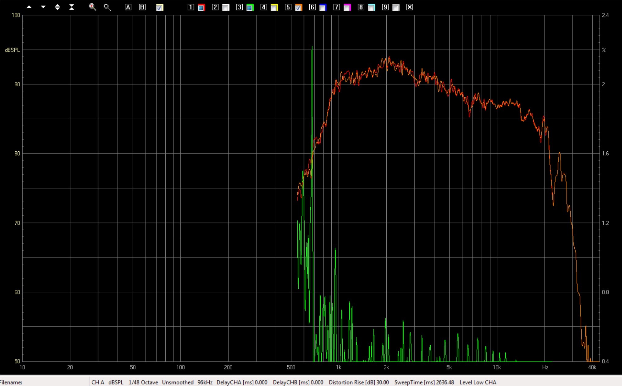

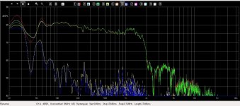

Just starting to understand the acoustic vs electrical idea I have a question about safety for the tweeter. First image is of the CD on 18 Sound horn with nothing else. (Green trace is THD) It looked to be a perfect replacement for the AMT in the above circuit so swapped it in with attenuating and impedance levelling resistors and got the curve in second image. The question is, does a driver's natural rolloff (with a horn in this case) actually protect it as well as an electrical filter would?

In a series xo the high pass function is delivered by the inductor that is in parallel with the tweeter. What protects the tweeter is the low DCR of that coil. If the DCR is high it will present too much DC to the voice coil. You cannot really replace the xo inductor with resistors as it will either have a high value therefore high DC, or too low a value and it will look like a short for the amplifier.
So you need to have a proper high pass reactive element.
The attenuating resistors are just for that attenuation.
Your CD's response at the lower end will be elevated because of the horn so you'll need to attenuate it more and that will additionally protect the tweeter.
All this may sound convoluted but it's not.
Let me know if it's helpful.

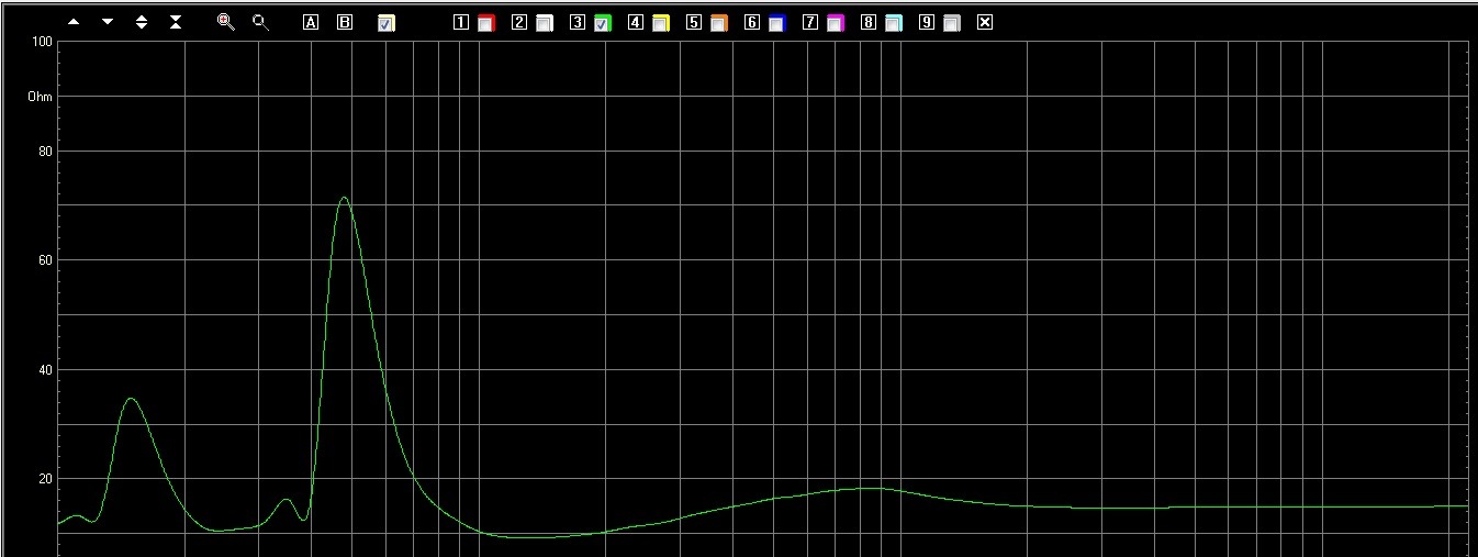

Not quite sure how to read your comment on 120Hz & Fs. Here's impedance sweep of the 2002 on horn ( NOT in XO) and with 15 Ohm across it.

Zobels on the woofer in classic series crossovers can cause some odd behaviour with the tweeter where some can plateau or have a peak before roll off or a very shallow slope. OK in an AR series crossover as can help to achieve good phase over the crossover to achieve a deep reverse null.
The inductor parallel tweeter really needs a low DCR and I aim for less than 5% of the tweeter Re. Never had a tweeter problem in 20 years of series crossovers.
