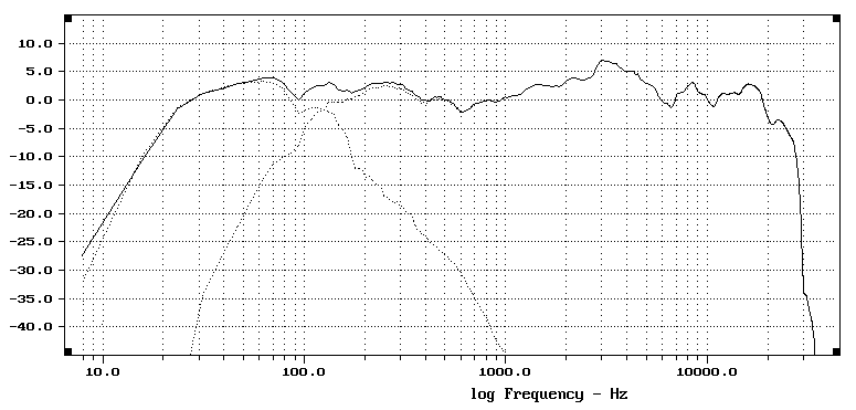

i'd be very interested in seeing some real world frequency plots for these drivers as they're on my short list of affordable alnico play things. the provided responses look far too good to be true.

Curve shown here is in 3 x 5 ft OB with an Eminence 15 beta (you can see
the crossover and sum). At 1M with 1/3 octave smoothing. There is
a bit of a peak at 3 KHz, but you can notch it out. No worse than most.

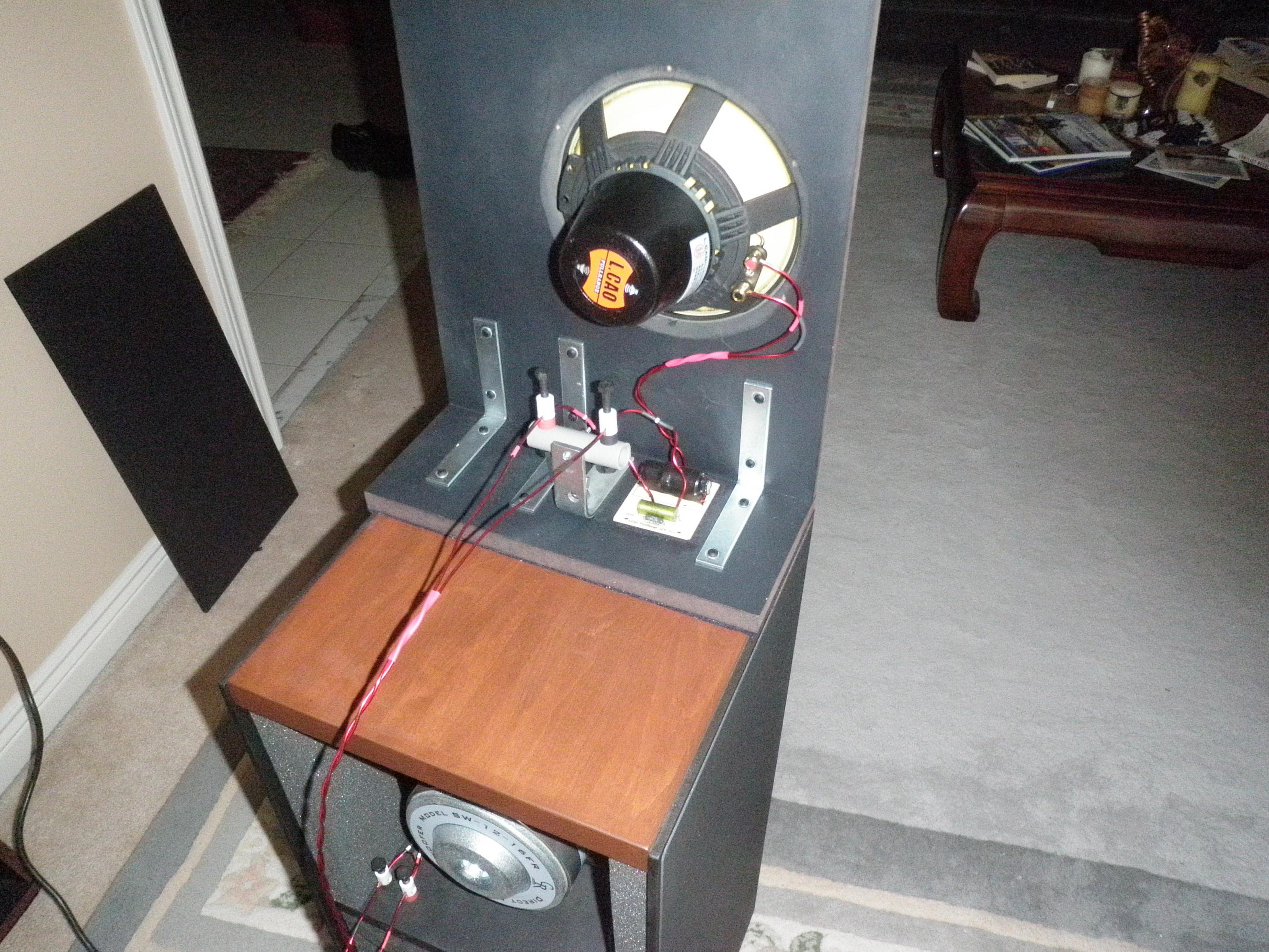

what is the dustcap made of? it looks like its made of permeable material in some of the pictures. is it solid? i was planning on butchering a pair with phase plugs and the EnABL process.
would you recommend a pair of these over a similarly priced speaker from one of the more mainstream speaker manufacturers?
not sure what it is made of, but it is some kind of translucent mesh.
this is the best picture i have of it:

This looks quite good to me. Is this W/O the recommended notch filter? A couple of questions regarding x-over if I may?

That curve was notched 3 dB at 3 KHz. You can make it flatter, but I did
not find that it sounded as good - it's the old "halfway rule".

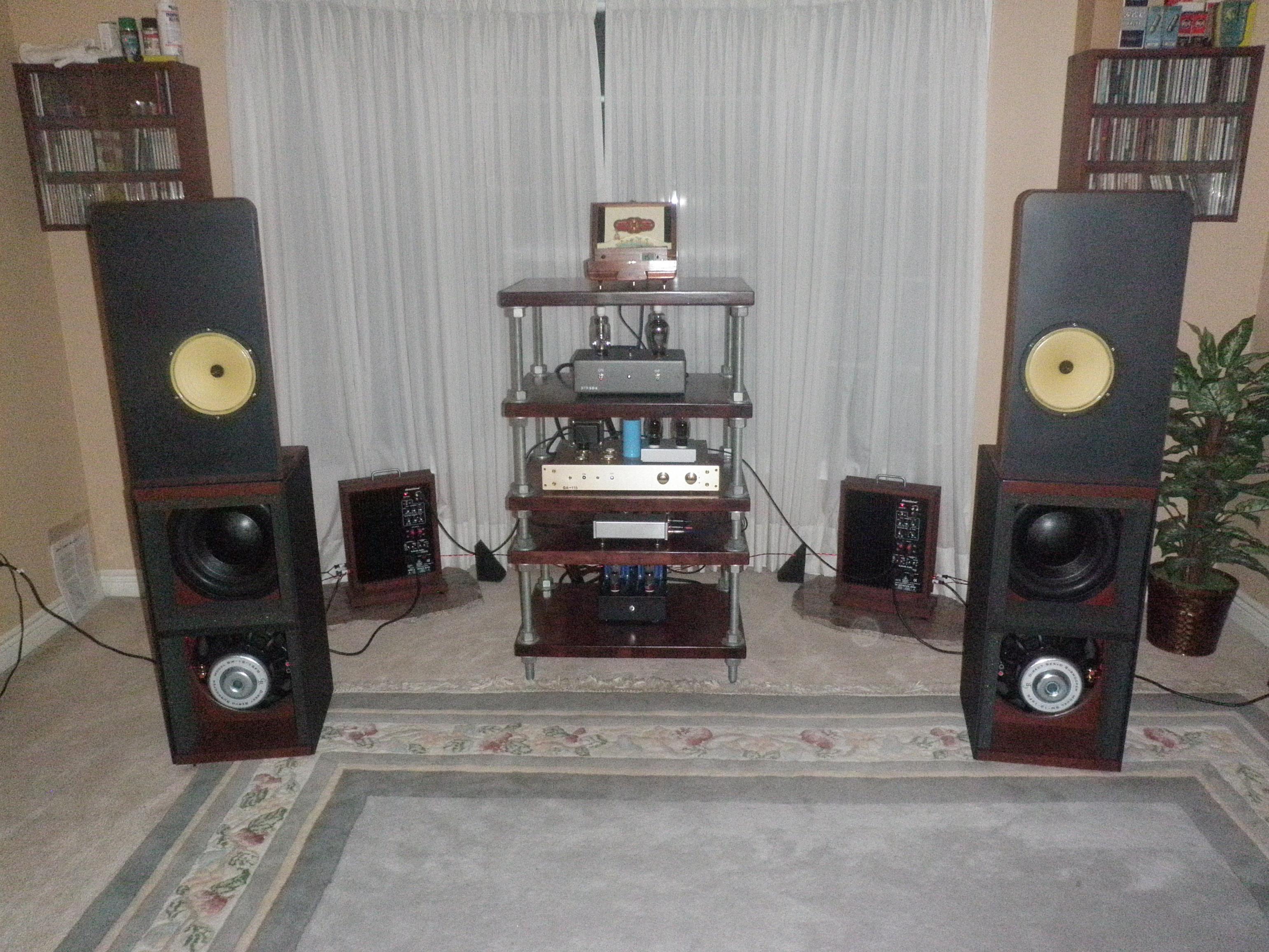

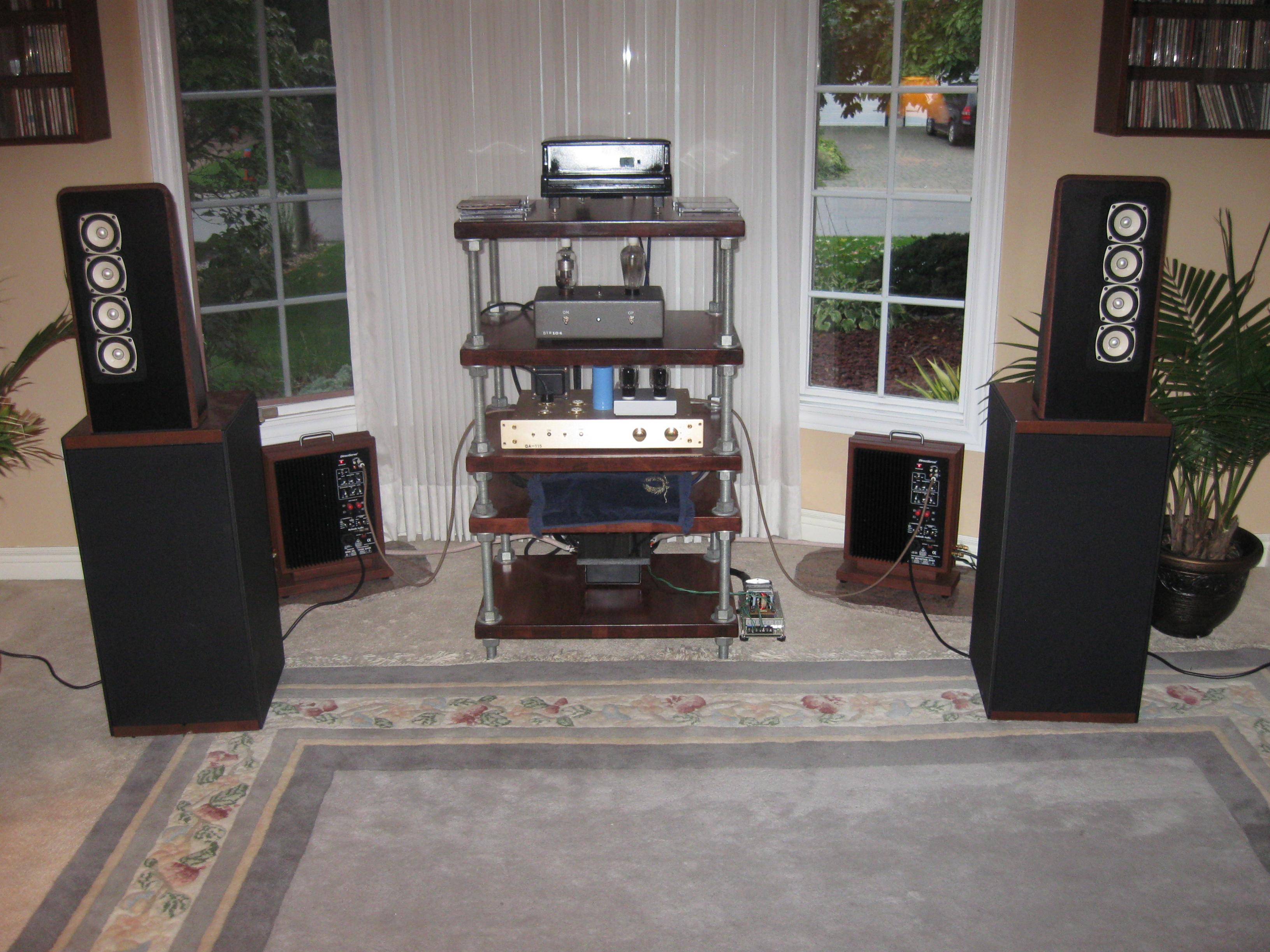

I was awaiting feedback on the L.Cao alnico drivers, but it seemed to have died, so I purchased a pair from Valab. Kevin communicates, matches/tests drivers and they arrived in 2+ weeks to Toronto area. Very well packaged and no issues. I have about 250+ hours on them. Drive them with modified Tom McNally KT-77 SE tube amp.~ 5w or so. I have 2 pairs of coupling caps, FR and ~170hz 1st order that can be switched on the fly, consider it PLLX-over. FR is used for thin sounding recordings.
Impressions: They are detailed, fast, open, and yet smooth. I am using the supplied parallel filter. Parts are decent, but upgrade will be coming. They image well, have very good dynamics and detail. My previous 4 x Fostex FF85K went to 32khz and I don't perceive any loss of air, but the the L.Cao's put out more treble as NP said of the ceramic version. I used to make my own magnetic ribbon speakers, FR, Tweeter/Mids but dynamics and dispersion are really tuff to get right. These do it right and very well.They also are not bass shy on my temporary 13.5" x 25" baffle above the OB subs. In my smallish 14' x 22' room they play louder than I can listen too.
I recommend them without reservation, price considered, but have never heard Lowther in OB. My before and after pic.'s
- Full Range
- L CAO in OB W/ Eminence Woofer
