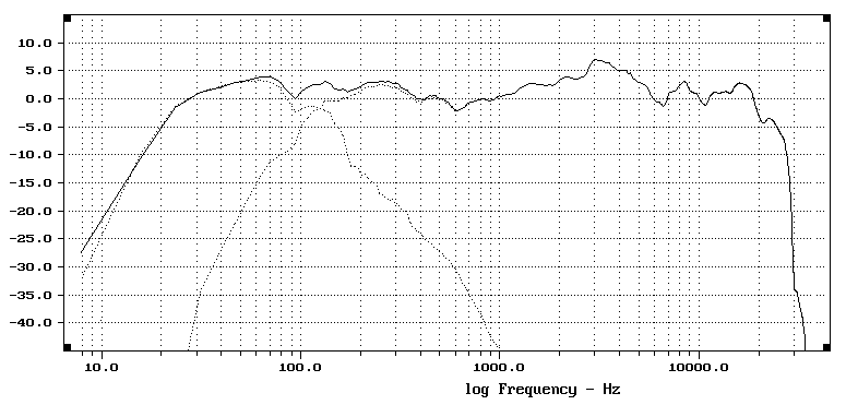

Soundaatma: The treble is full.The L.Cao rises from 7500hz - 12000hz and rolls off about -3db at 20khz. I believe the highest fundamentals are violin at 4500hz or so and then overtones take over. The two combined are called partials, which we can hear. The higher you go the more subtle they get. The sound at those frequences are like a heavy hiss. I think of it like fog, a heaviness in the air.I played with this thru my stereo with a tone generator a couple of years ago. Depending on your hearing it is audible but hard to define. Turn it off and you know something is missing. Most of us can't hear 20k.
Von.ah : Yes 1" threaded rod, machined on the bottom to points and 1.25" Birch butcher block shelves ( Ikea) and it is a solid.
bww: I use 12" 16 ohm GR Research servo subs and matching Rythmik 370PEQ Plate amps. Not cheap, but really good. That's why I made the cabinets modular, they are really detailed, flat to 25hz and I have never bottomed out xmax. Supposed to be good to 300hz, so really with 4th order 200hz would be the highest I would venture. I run them about 125hz as they do have a rising response. Having said that, they do upper bass very well, clear and defined.

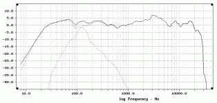

Awkwardbydesign this is a subjective question, but will try to respond with some objective reasoning:
The Alnico has a different spider, phenolic, than the ceramic and claims better transient response and better FR at both extremes due to the Alnico magnet and resulting parameters. Nelson Pass already noted the ceramic had quite a bit of treble output, and his response graph looks decent, a liitle shy above 18khz.
My previous speakers were a mini line array of 4 Fostex FF85K's per channel (=94db efficiency, same as L.Cao)which had a peak of 6db at 19k and response to 32khz I don't notice anything missing on the L.Cao, but have no balance control on my pre to A/B the two.
Just my two coppers. 🙂
Recently I got around to trying the L Cao with the Alnico magnets. I was
surprised to find that the response curve was quite a bit different, and the
drivers were accompanied by an LRC designed to notch the midrange
response. Listening to them without the network gave a rather dull
presentation, and with the network I still found the top end pretty soft.
It's a mystery as to why they should be so different, but at this point if you
are considering them you might want to think about a tweeter above 5 KHz.
