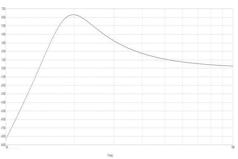

Nelson describes his Eq as follows :
I am not an amplifier or eletronics person so I am wondering what this means. Is this a second order EQ where the gain at 20 Hz is set to be 6 dB over the original electrical signal? Or is it a shelving filter that is rolled off at 20 Hz? Passive crossover design I understand but electronic EQ is beyond my limited knowledge. I have no idea how to even construct such a device, I only work after the amp in the audio chain.
... an Eminence Beta 15 in an open baffle with 6 dB of EQ at 20 Hz ...
From what I understand, he runs the signal through an electronic (digital?) EQ and boost the 20 hz signal by 6db. I think it's very easy to do if you have an EQ. However, I haven't used one and could be wrong.

What size baffles were used for these measurements? In other posts you were trying various size baffles. I see that the FR driver was at 36 inches.

By the way, I have noticed that generally 2nd order crossovers seems to do a good job on OB's. Martin also prefers 2nd order, be it passive or active. Also, it seems to be common that high pass is placed at 50-100% higher frequency than LP.
What is sometimes puzzling is the fact that both the woofer and the fullranger are wired in-phase. As I got it, on second order filtes one of the speakers should be connected in the opposite polarity (assuming that amplifiers have the same phase) because of the phase inversion.
Still, this is OB world, and everything seems upside-down-inside-out.. and it works....

Vix said:.......
Vix
6db/oct = 90 deg phase dreking
12db/oct =180
18db/oct = 270
24db/oct = 360
electrical connection depends of what you wanna pair with what ........
also using physical phasing in overal picture ...... ( ya know old story - all acoustical centers must be aligned vertically ) ....... so - nice that OB is tilted back .....
Vix said:What is sometimes puzzling is the fact that both the woofer and the fullranger are wired in-phase. As I got it, on second order filtes one of the speakers should be connected in the opposite polarity (assuming that amplifiers have the same phase) because of the phase inversion.
That is true if your drivers act like pure resistors, are coincident, and have zero phase across the frequency range. Once you add in the real driver's behavior (impedance and SPL response) and locations on the baffle (OB or boxed) the polarity of the connections should be determined by measurements and/or detailed simulations. I don't think there should be a hard simple rule about the polarity of the connections for any crossover. Personally, I don't believe I have ever wired drivers using a 2nd order crossover out of phase.
