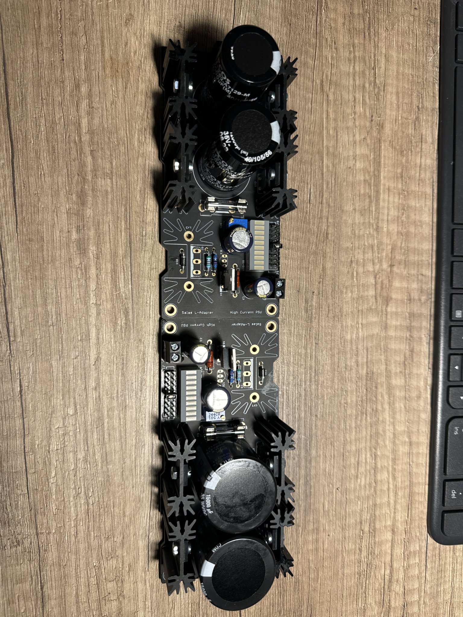

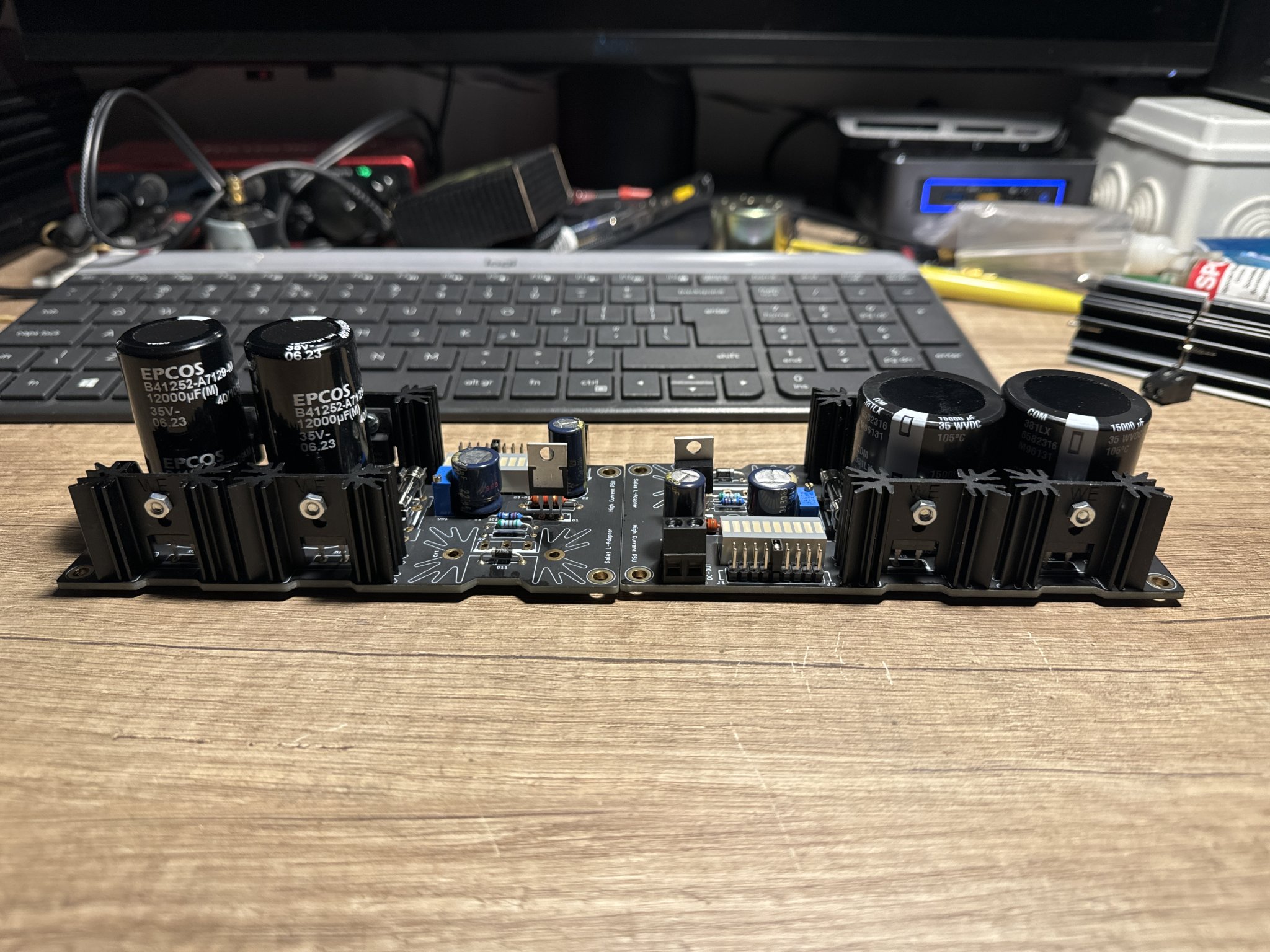

I’m planning my build of the L-adapter, going to use it to power up the new Rpi 5 with Picoreplayer. Do you have any recommendations for toroidal transformer?

I use 30VA 6Vac, better take a transformer with secondaries of 7VAC or 8VAC. I would not take more to avoid to high dissipation. I came away with only 6V's because I use HFA25PB60 diodes, which I compared with multiple other diodes and gave a very low voltage drop.I’m planning my build of the L-adapter, going to use it to power up the new Rpi 5 with Picoreplayer. Do you have any recommendations for toroidal transformer?
Yes you can use 12VAC if your load is not power hungry at cruising mode not creating too much continuous extra dissipation. Since for 5V DCout a typical off the shelf 9VAC Transformer is already the max spec needed. An Rpi 5 running just a music player app won't be power hungry I suppose, only for a while when booting.Yeah, I know of toroidy. But I really am a beginner at this and meant a more specific technical recommendation.

Ok, then I can atleast use it to try it out. If needed, exchange it later.
Are there any other changes to the board materials I need to consider when using this Tx?
