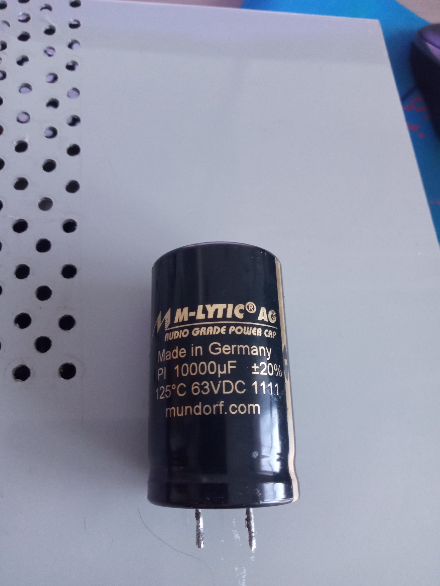

I just found another 10.000uF 63V this one with pedigree.

Haven't researched that aspect because its a general supply and who knows the interaction in each different application system but as it doesn't have many parts the transformer and the reservoir capacitors are the main quality target items.

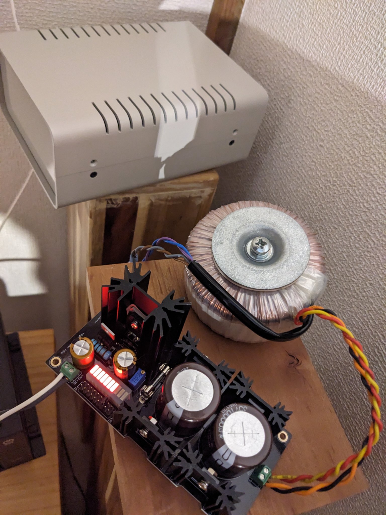

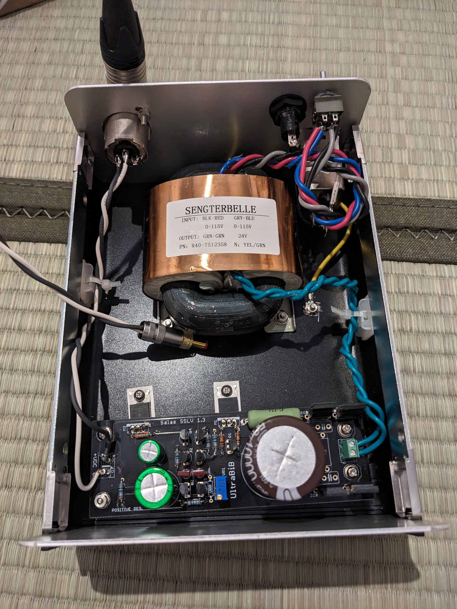

Hello Salas.
I built 3rd l-adapter for WiFi router 19v 1.7A.
Transformer is 120va 24v(It get 22v in my country for 100v wall tap)
Sound is amazing as always.
I appreciate for this build.
I like l-adapter so much.
Its easy build,simple,less parts,wider voltage choice and larger current,powerful and good bass sound comes.
I worry about a Q2 heatsink temperature get around 40-45℃.
I worry because it's on 24 hours.
Is it good way to mount on alumi chaiss bottom? It's 3mm but no fin.
I also built 24v ultrabib for acp+
It's amazing too but I prefer l-adapter.
