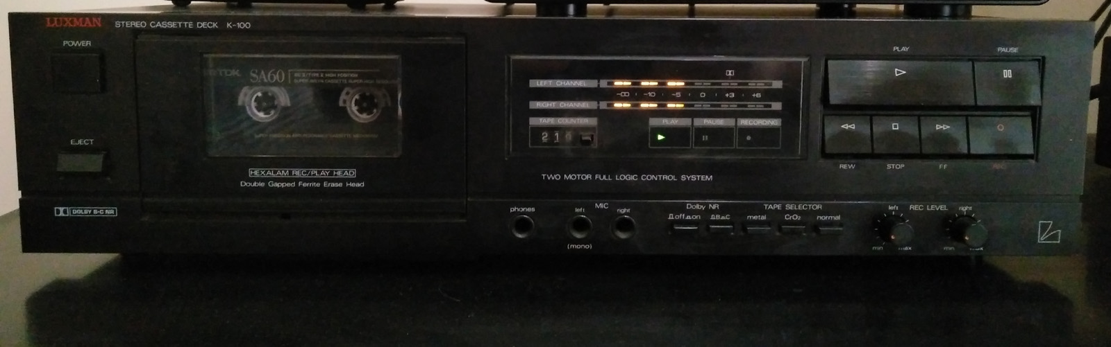

That makes this cassette tape recorder a 'player' only... what about the magnificent analogue recording feature...? :)

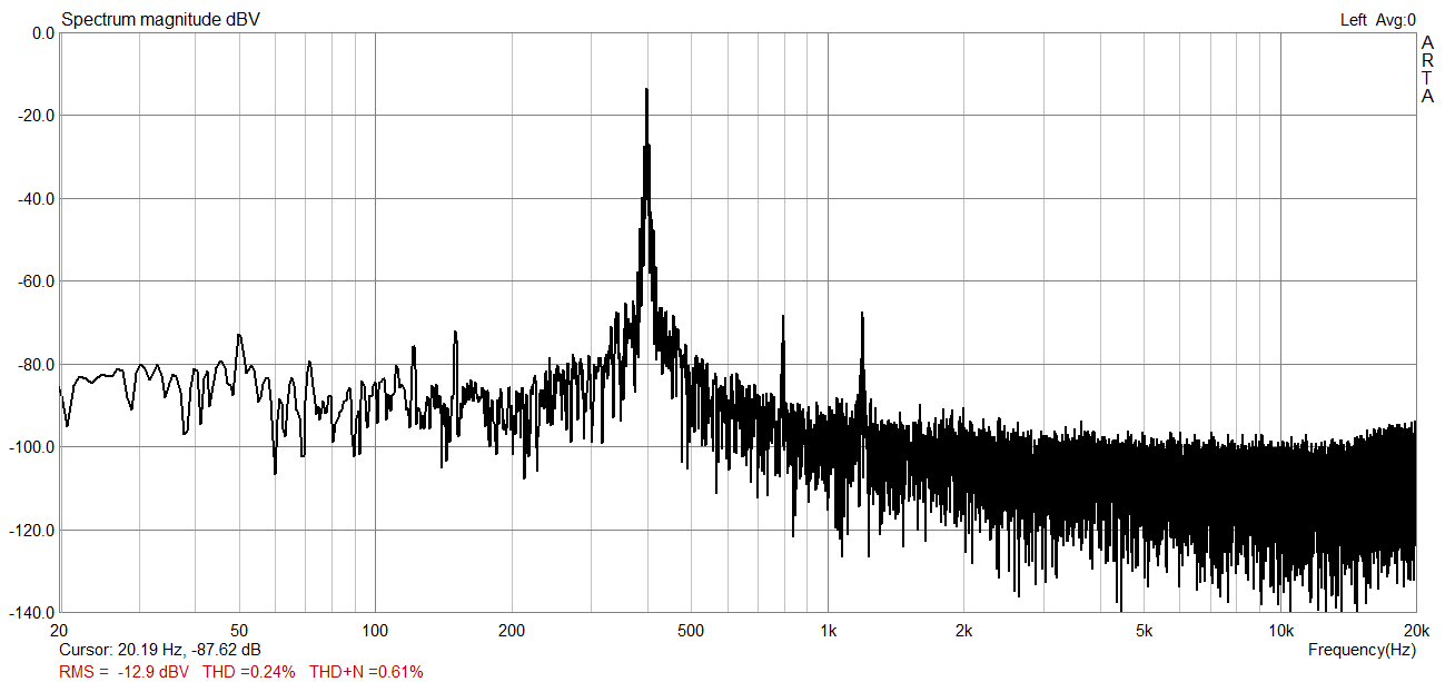

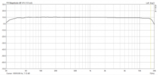

The recording is doing well after careful adjustments of all things adjustable. Here are my response and THD measurements of newly recorded pink noise and 400Hz sine tone at -5 panel meter level. The deck's 0dB ref level is 400mV output i.e. -8dBV. Cassette TDK SA, high bias (CrO2), N.R off.

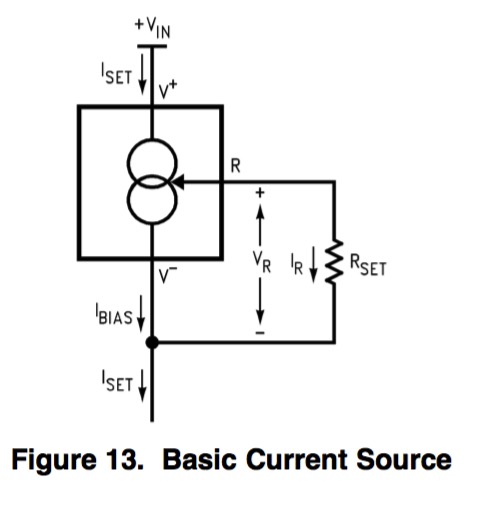

I've been making similar circuit recently. I'm skeptical about LM334's noise performance, so I try to look for better alternatives. So far, I am using a CRD+2N5458 cascode as CCS to feed the LED strings. However, someone pointed out that CRD could be very noisy, too. What's your opinion about this? Do you think the LM334 is good enough?

Its good enough when you filter the node but not a benchmark. Depends on the purpose. Here its fine. I would not directly bias an MC phono's input stage FET with it though. Its stable with a wide enough range of voltage across it nonetheless. CRDs are high gos JFETs with G+S internally shorted. High gos (output conductance) isn't usually associated with high gfs (transconductance) which is usually associated with minimal noise.

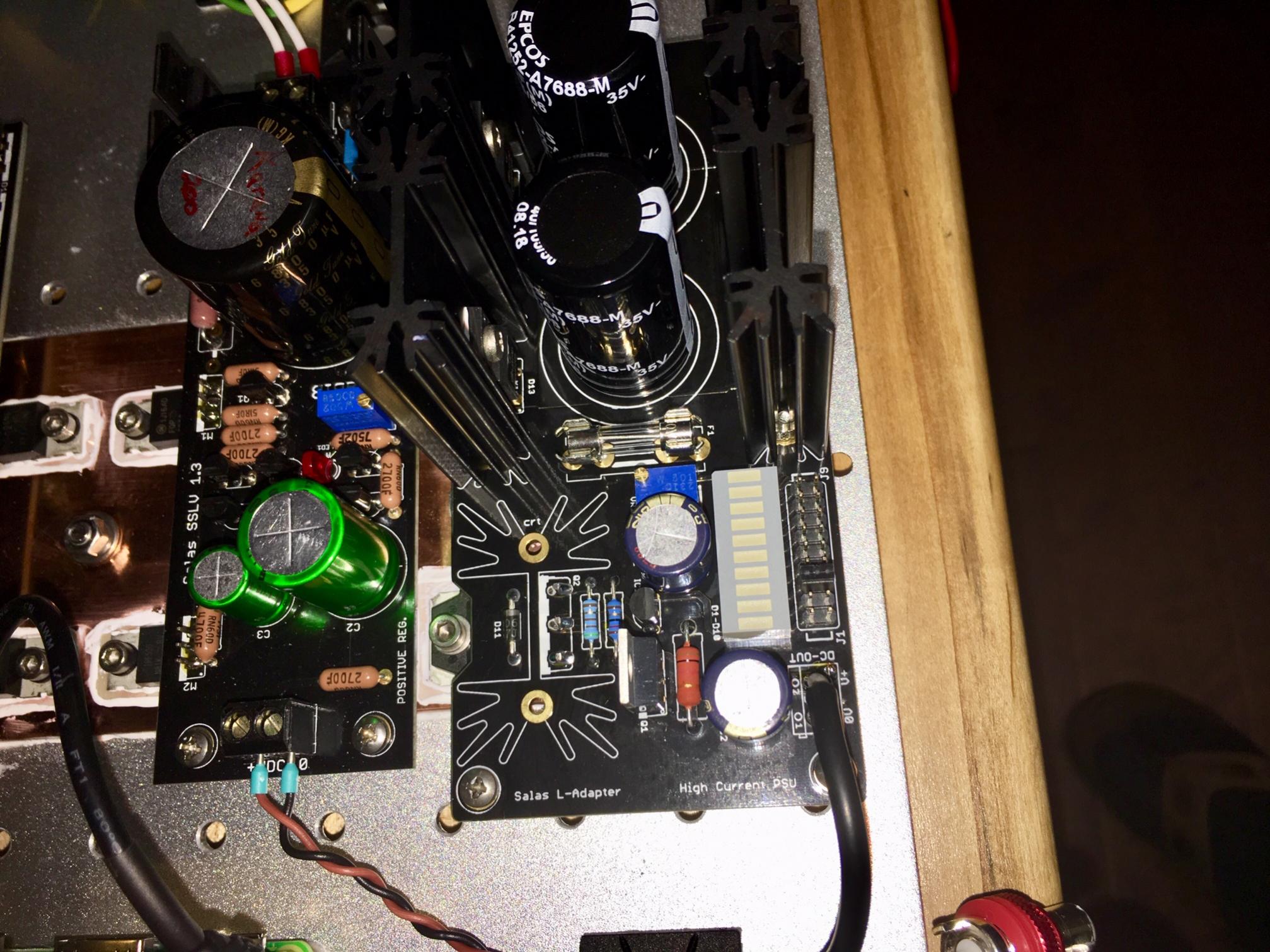

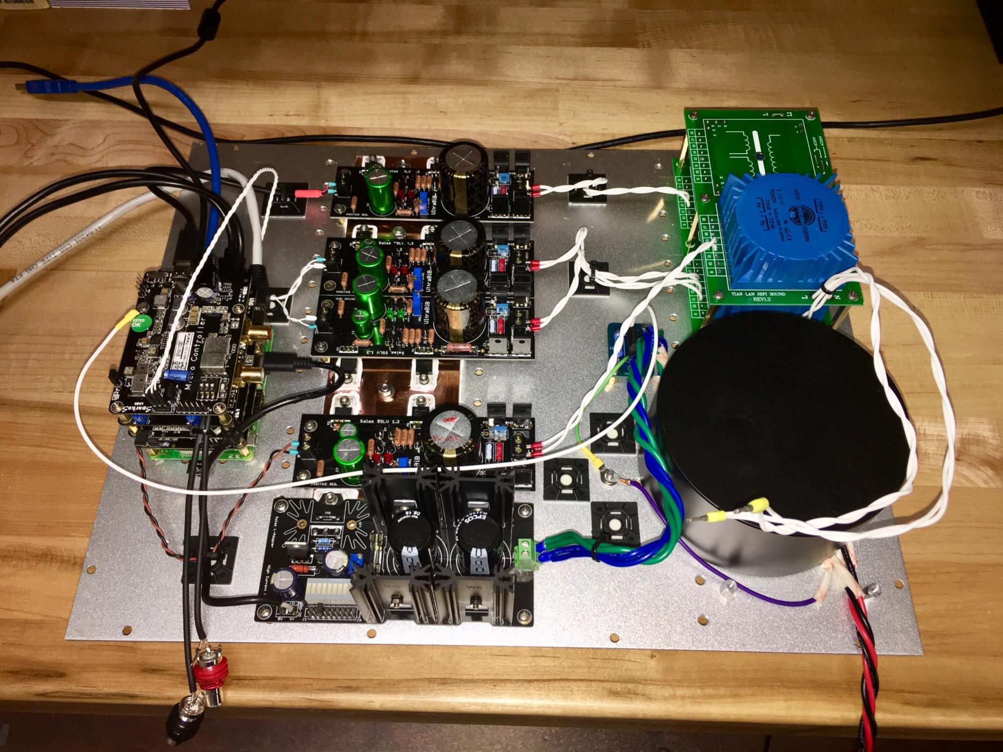

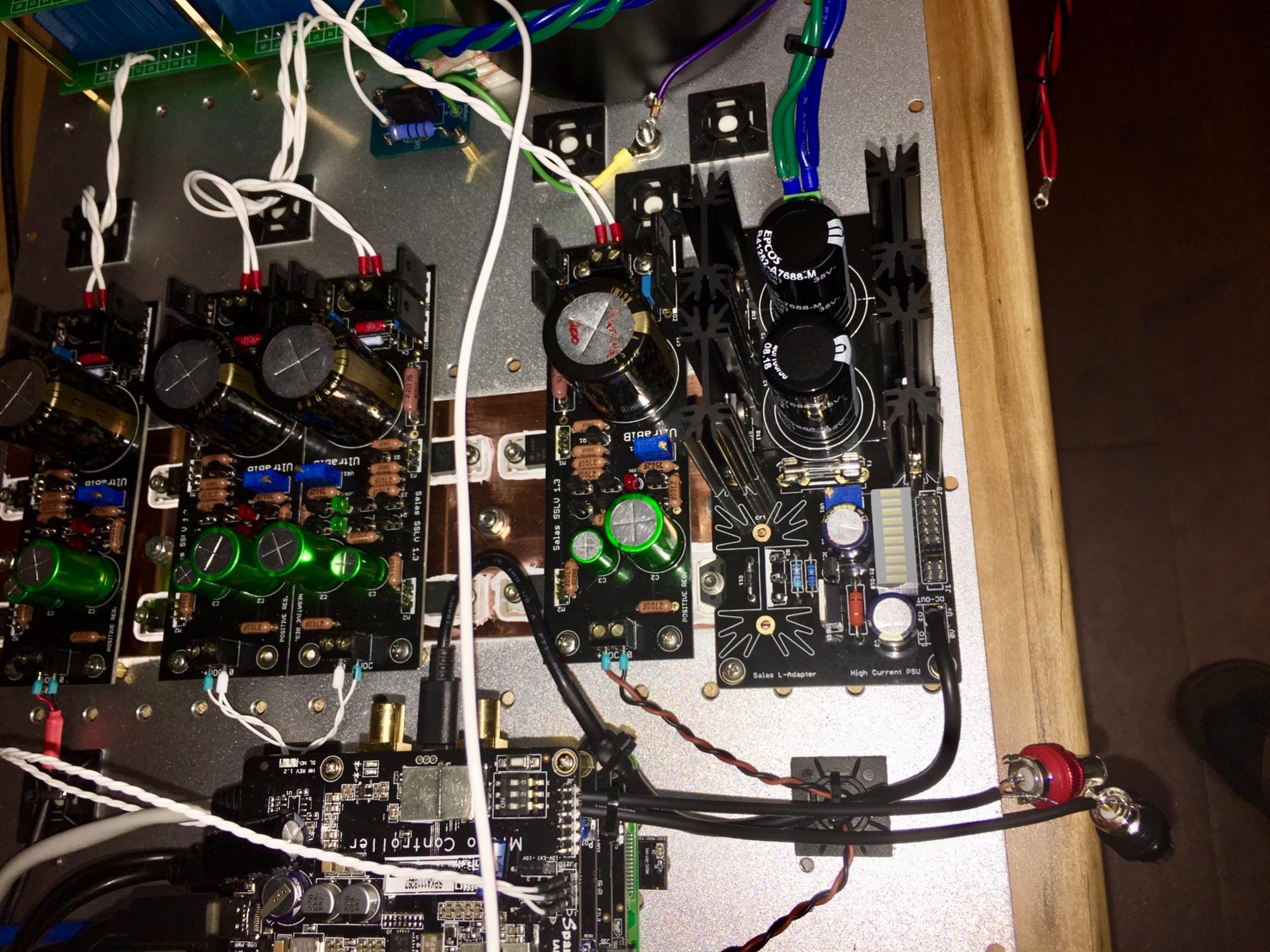

I assembled it in 20 min. Very easy and self-expiatory. Full assemble did not require usage of any special tools. All info about PCB and its components KIT will be introduced by Tea-Bag very soon. I fired it up with Constant Current (CC) load an ran for about 30 min with 3A CC draw. Then, I ran 10-15 additional min for 4A CC draw. Vout adjusted to 5.08-5.09 VDC (I set bit higher than 5V due to potential losses in feeding cable). It is stabilized within 20 sec. Farther fine Voltage stabilization was related to thermal equilibrium and settled in minutes.
Since my first sanity check ended up very successfully, I integrated L-adapter onto my Katana DAC. Also relatively easy integration and I used 3mm cupper bar connected to the bottom plate of my enclosure as heatsink.

Hello Alex, nice result. Congrats. Very good stability for such a simple circuit on your bench DMM too. Not moving before the third decimal digit.
Do you know the average and peak consumption of your Katana stack with Raspberry Pi + LCD & 2.5" Hard Disk?
Also which one type was the previously used SMPS? Was it a common plastic brick or some better quality module?

Certainly, I’ll shoot such video next weekend when my DAC will be fully assembled. I took front and back panels of it to machine shop for milling. It is impossible to judge SQ from YouTube, but trust my words, it is the best digital sound I ever heard. These power supplies brought this DAC to completely different level and L-adapter is a final touch to that painting. My lab test setup made from simple TDA 7297 amp and restored Pioneer CS-G7001 speakers from 70s. I’ll let you see and hear same song from my main setup: Salas DCG3 pre, Nelson’ F5T monoblocks (real 108W each) and Acoustic Zen Adagio floor standing speakers.
My deepest appreciation to Salas for unbelievable design. Your talent is limitless. Tea-Bag, thank you a lot for such opportunity to touch and taste these devices. Extraordinary quality for all PCBs and parts choices.
