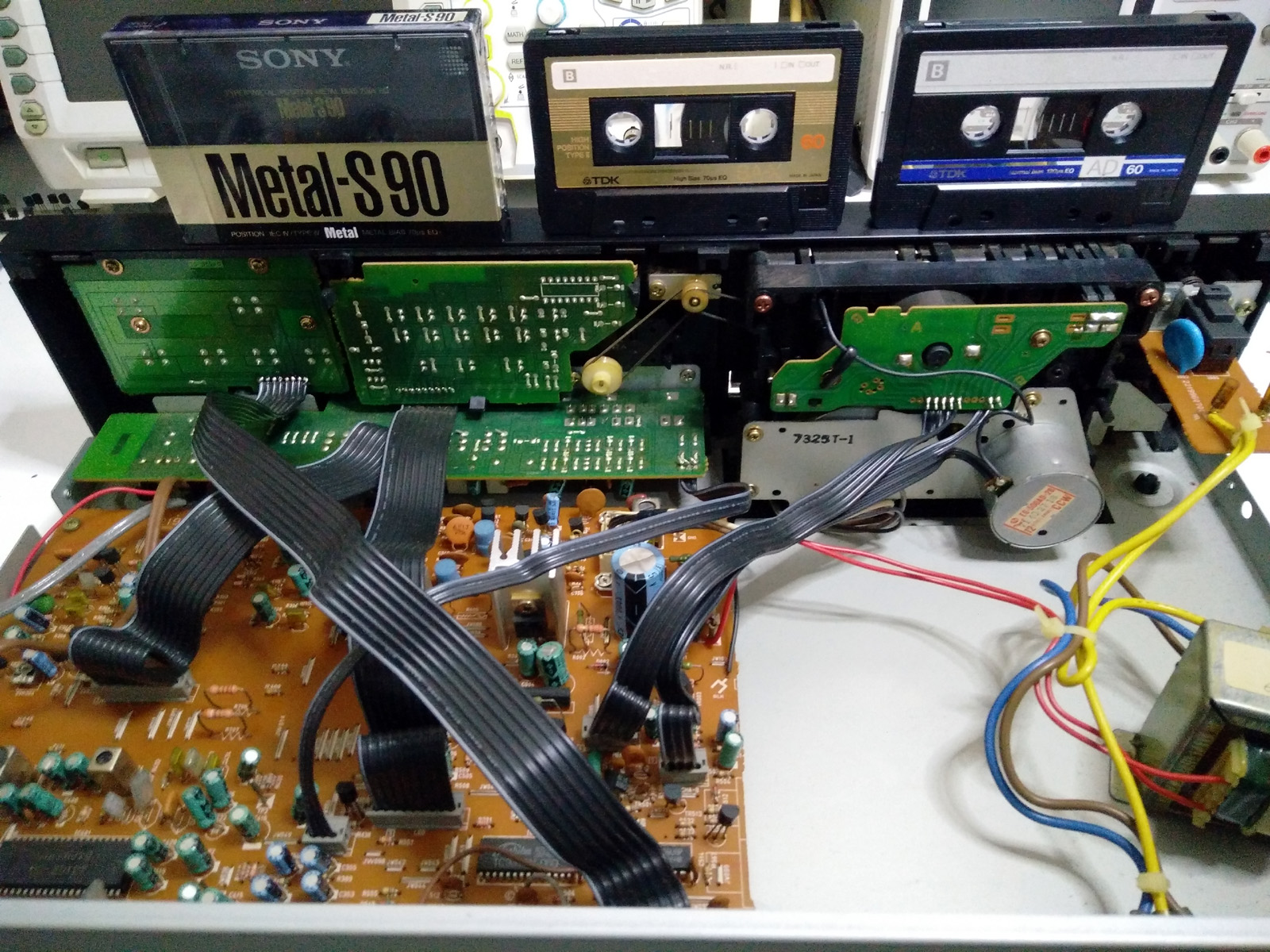

Imagine the hair pulling if there was SMPS and I had to debug where switching spikes are coupling on my old humble cassette deck's cable runs. I dug it up along with some tapes and restoring it for fun. Its a low end 2 head Lux. Seems rather alright after disassembly, Cramolin (Deoxit), and some joints rework 🙂
For some extra fun: take the signal directly from the head and feed it to your RIAA preamp. You need to change one time constant.
That makes this cassette tape recorder a 'player' only... what about the magnificent analogue recording feature...? 🙂

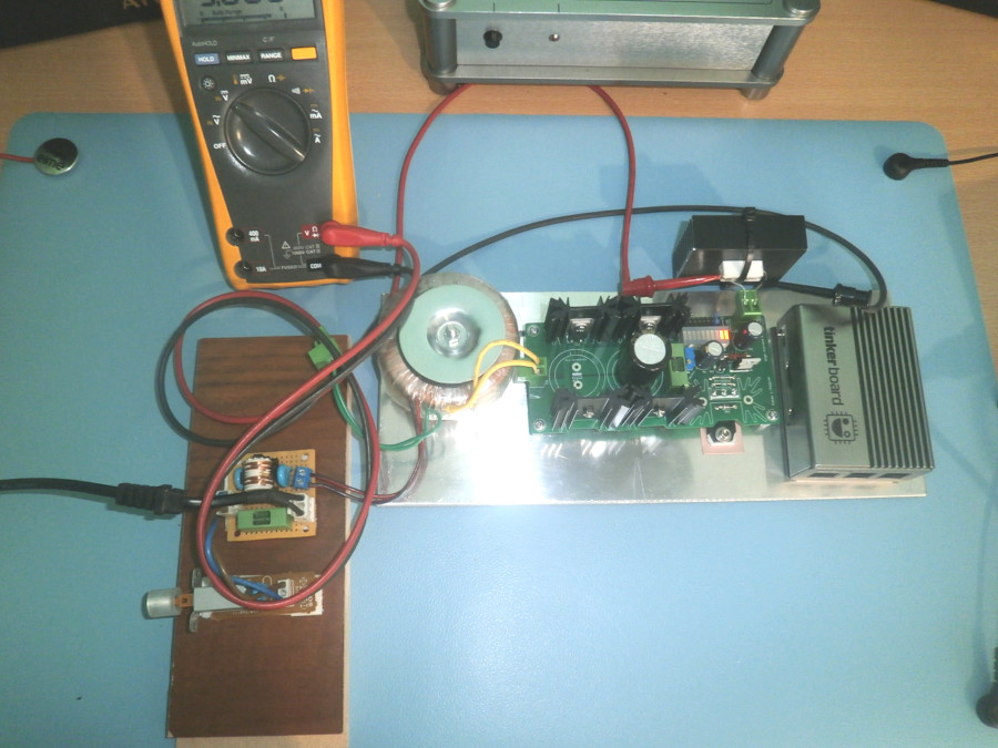

It lives !
On first test on resistive load everything seems OK. I've decided to put only one 10mf cap for Tinker and add the second one for the test on my audio PC.
It will take some days to setup Tinker and do an overall audio test on it. After that I'll do the comparison with my linear psu (LT1083 / picoPSU) on my audio pc. I'll post my impressions then, now I have to crawl back to my bench.
Have I mentioned that the board is a kind offer from Nick ? Same on me.
Well done Salas. Thanks for everything.

Easy to assemble and set? Steady? How many mV you have across R2?
All you check in the end is DC across the D11 1N4007 (an easy place to measure Vin-Vout) will not drop below 2.5V worst case. That check confirms the losses in the chosen components for the rectification & filtering section, including the transformer, are still at bay for the highest current consumption peak of a given computer. Probe across D11 with the voltage meter during boot and on highest CPU usage %. Else, you have to use higher secondary voltage transformer and/or higher mF reservoir capacitor(s) to decidedly distance the Vin-Vout voltages and/or reduce the ripple voltage loss contribution.
It was very easy to assemble, I have no special instructions for things to pay more attention, it's pretty straight forward.
I measure 64mV across R2 (1.7 A load)
Transformer's secondary is 8VAC, target voltage is 5VDC
For 330 mA load, 5VDC output, input voltage is ~10 VDC
For 1.7 A load, 5VDC output, input voltage drops to 7.6 VDC
Of course this is transformer dependent, I'm only using 25VA of this 50VA transformer
Even for high current test, I measure (multimeter) below 1mVAC at the output.
As I've stated all test (for now) are done with resistive load, I'll measure again with various CPU loads and usb devices attached when I setup Tinker
Don't forget to factor in the output cables voltage drop on maximum load when setting the output. They better be substantially thick.
Doesn't have another same voltage secondary to parallel? When paralleling secondaries we must make sure they aren't connected backwards of course. Its either they are in parallel and there is voltage or in antiparallel and there isn't any voltage. In this case the transformer heats up fast. Blows its primary fuse or it heads to meltdown sometime soon when there isn't a fuse.
Don't know about your Fluke 179 but my Fluke 87V takes patience to settle down in its final AC mV reading when hunting very small figures. Seems like it performs a slow integration and averaging process. Has 20kHz bandwidth spec and its reliable at least. I had checked it finally shows the right sub 1mV figure with highly divided lab generator signals where I know the input level and the L-Pad's division ratio.
