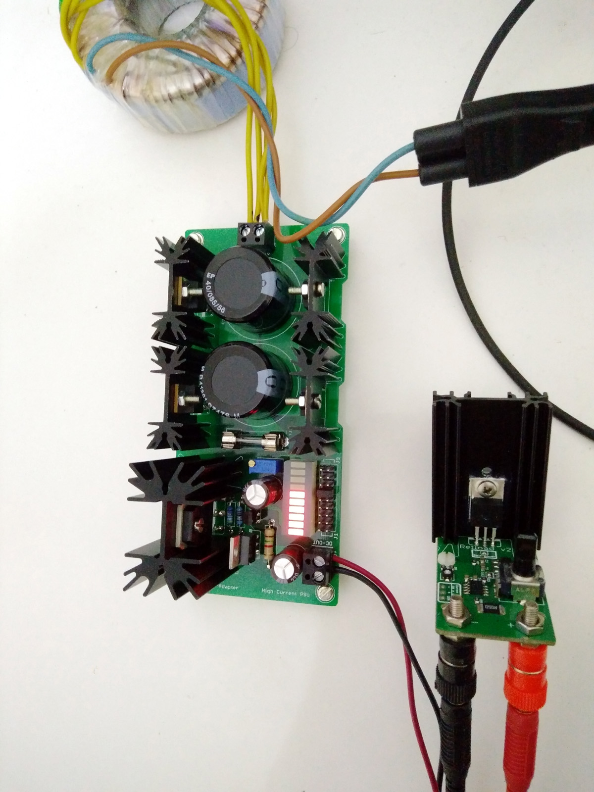

V(onoise) in LTspice says 187.4nV Rms (1.5 μV pk-pk) integrated over 1Hz to 1MHz for C1=220uF. Practically you get what you see in post#1's scope pic (blue line). Includes the attenuated ripple and scope noise plus probing imperfections. Was shot at high current draw near 3A. Its for 20MHz scope integration though and the load isn't ideal. Its a micro controlled soldering iron that possibly back emits noises of its own. A computer would also do so or worst through its DC/DC converters of course.
Linear PSUs typically have an efficiency of 60%. Getting better when fitted with very good regulation transformer and SiC Schottky Diodes. But even when with minimal Vin-Vout LDOs they will not exceed 75%. Good PC switchers are 80-85% efficient on average these days.

Is there something wrong with the circuit diagram around the LM334? I don't see it's 3rd connexion and R2 is not shown? I can see R2's label, but not its connexions.
Yes, the schematic is a bit simplified 😀 Check LM334 datasheet how to connect R2, quite easy 😉Is there something wrong with the circuit diagram around the LM334? I don't see it's 3rd connexion and R2 is not shown? I can see R2's label, but not its connexions.

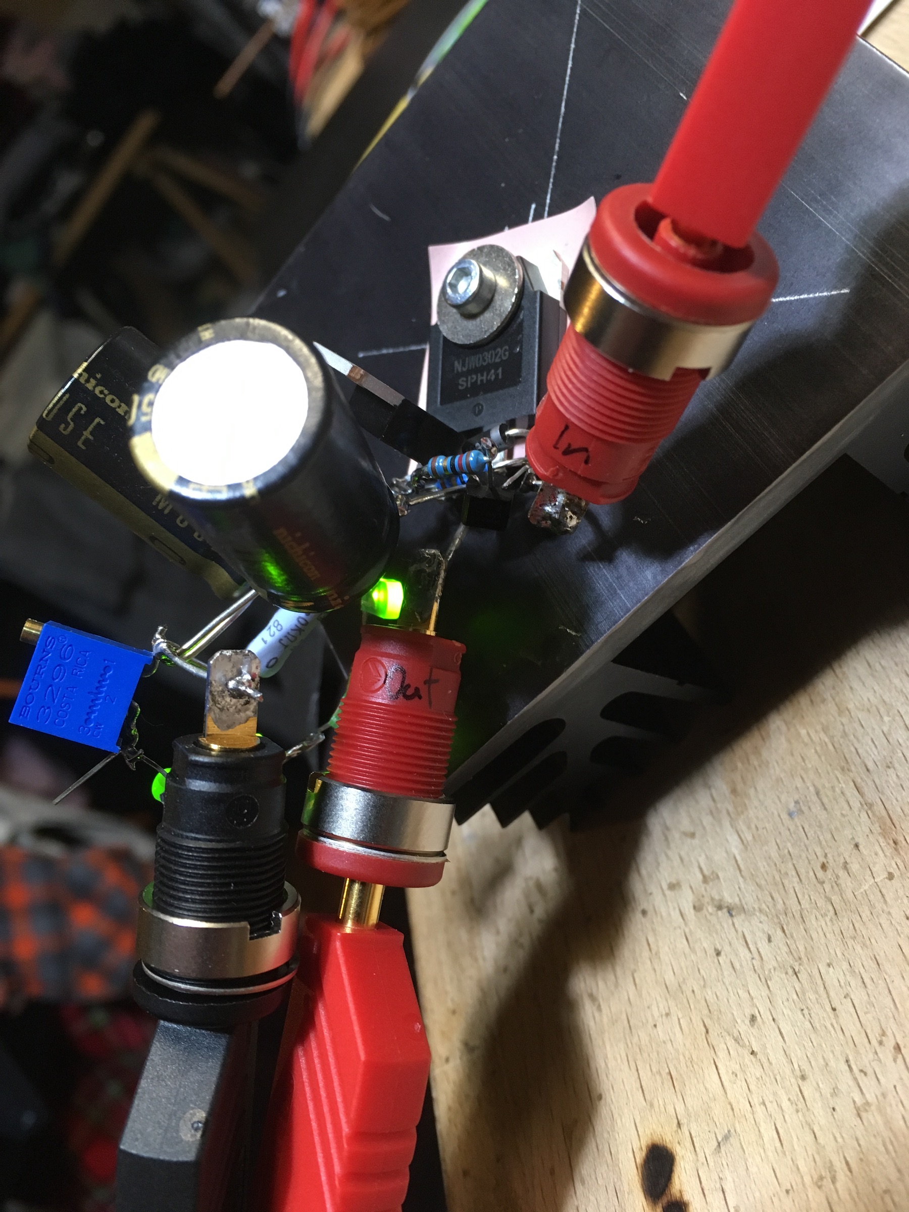

I just built one. 11V input from a SMPS, LC at the output and into the Ghetto-L-Adapater.
5V out at 500mA takes about 6 minutes to stabilize (could be the fresh elcos) and stays really stable then. Ripple is hard to measure.

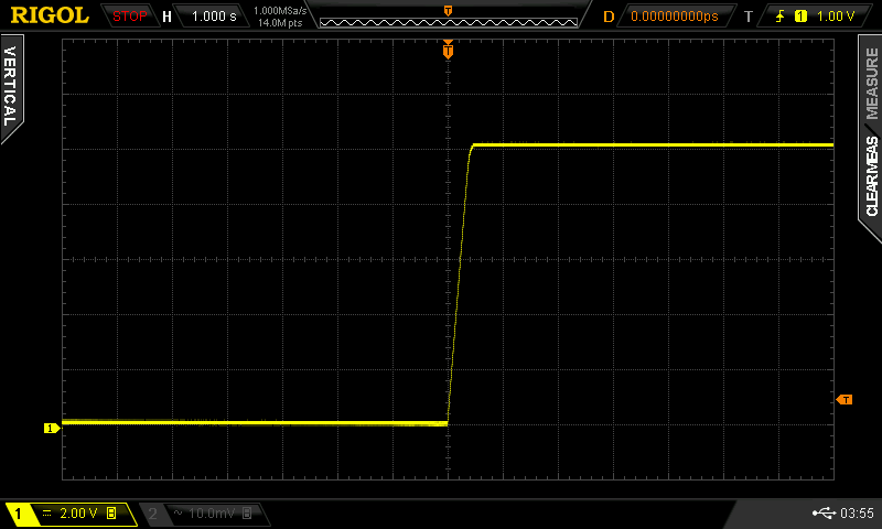

Congrats. How many mV difference your build makes in six minutes? Have you got a bleeder resistor across the output (R1)? Helps with output cap charge and setting up. Mine is boring, I set it for 10.35V on 250mA e-load to watch it over time, its doing 20-30mV change for cold set and forget thermal equilibrium. Warmed up for long, on/off, or cold on. Uses Chemi-Con KY C1 C2. Here is the loaded start up capture also. No over-voltage spike, linear climb & stable early plateau. Each horizontal division is one second in time.
Thanks. I do use a 1k bleeder. Currently I use a pretty big heatsink (I wasn't sure about what was needed and just picked one that seemed ok and was on hand). Difference is about 30mV. I let it run for 4h today and checked what happened with a change in load. Drawing 800mA voltage was 5.067V, switching to a draw of 400mA it went to 5.088V. It went to 5.081 first and climbed to 5.088 over 8 seconds and then stayed there.
Unfortunately I didn't store the data of the logger of the benchtop meter. If it is of interest I could repeat that and post the log.
Caps are Nichicon Muse, 220uF 50V, again I used what was in the drawer.
So same difference we got. Your Vo change between loads also confirms the Zo spec. Which is not bad for a non reactive non error amp design. Will end up to about 0.02Ω at higher currents. Output cables loss will dominate at such consumption levels.
They are OK. 50V caps have better spec. There is 10mm diameter allowance on the board anyway. So it ate all the source PSU's scope visible switching noises? What will be its client circuit to power?
